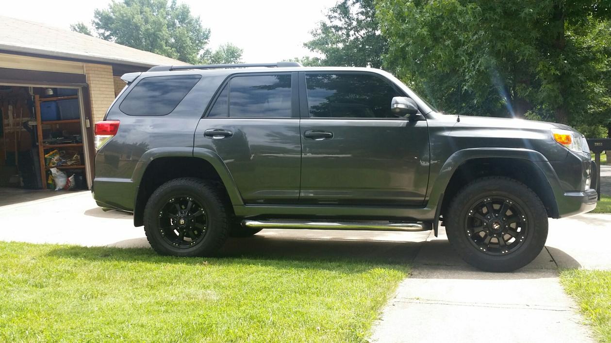

Daystar on my 11 LTD with Xreas, no prob. Stiffer ride and great clearance, good price until I burn up the xreas and jump to 5100s.
I see you took off the front air deflector on the bottom of your bumper. Did you notice any hit to your MPG after that?
No, not at all. About 1.5 mpg drop on the highway with the wheel and tire upgrade but no difference with the deflector and I keep a pretty close eye on it. Just a better look imo and if you get in the trails at all you will tear it off sooner or later.
