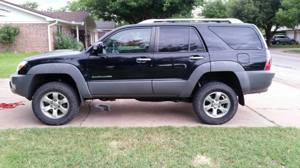

You CAN swap the front coils while keeping the XREAS system intact... I did it myself. I ran FJ coils with 1/2" Toytec spacers up front and FJ coils in the rear for a 2/1 lift that sat pretty level. This is how it sat...
With your XREAS having that many miles, it would be a good time to go with the Bilsteins... the XREAS shocks are pretty short anyway, especially the rear so raising it really doesn't leave much down-travel. I used to lift one or the other rear tire off the ground constantly while off-roading. By the way, the FJ coils were a nice upgrade for the money.

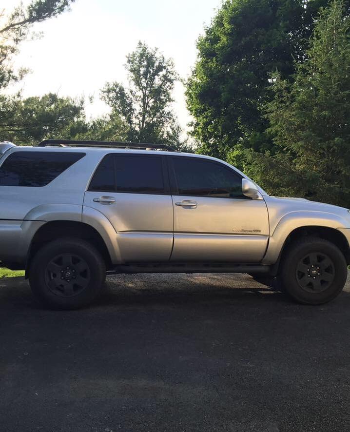

Hey guys finally got the car up on the lift this past weekend! Thanks to you guys I know my front spacer has my front at about 3 inches, i Measured the back and it is in fact a 2 inch spacer. This is probably the reason why I hear a huge thump hitting big bumps in the rear. I do have XREAS and reading around a 2 inches spacer is too big for the rear with XREAS, most kits only suggest up to 3 in front and 1.5 in rear. Would you guys suggest going down to a 1.5 in the rear to give it a more level look and help the shocks out a bit. What do you guys suggest?

Yeah, the easiest and cheapest thing to do at this point would be to swap in some 1.5 rear spacers and ditch the 2 inch ones. There are usually used Daystar 1.5" spacers posted in the classifieds section (I may be putting some up for sale soon).
