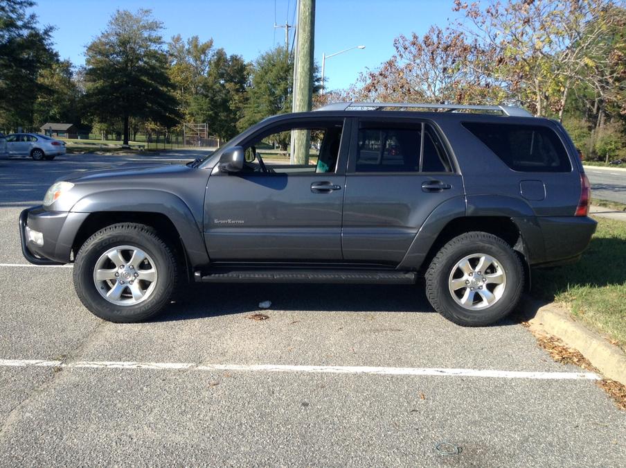

I have a 2005 Limited v8 and was wondering what was a personal preference to level the 4runner? I just want the front to be level with the rear. Any recommendations?
I have an 05 Limited V8 and put in a Daystar Budget Boost in the front and the Daystar spacer in the rear. Its still has a slight rake (less than 1 inch) in it but it way more level than before. You can realy notice it when its parked next to another stock runner. Im planning on putting in Bilstiens 5100 adjustable front shocks and taking out the spacer to get it totally level though.
Looks good! At least the way it sits, it is less likely to be low in the rear when you load up the back.
About 2 weeks ago I put in the 5100s at 2.5 inches in the front with rear 1 inch spacers and there was still too much rake so I put in the front the 2.5 inch spacer and lowered the 5100s to.85 inch and its almost perfect.
So if you only want to level it out I would go a 2.5 inch spacer in front only or get the 5100s and put it to the top mark on the shock. Remember the 5100s at the top mark was much more comfortable ride than putting the spacer on with less damper travel.
