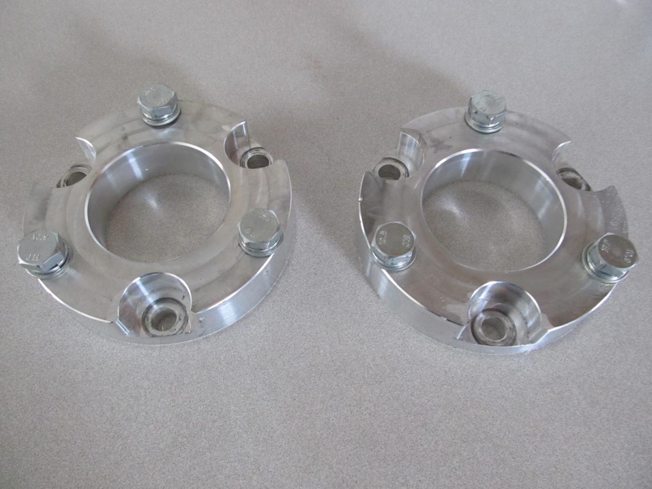

here are pics of the 1" spacers i bought, they dont have any markings or numbers on them, anyone recognize the brand?
i read a thread about the daystars & extended studs, do these look like they require extended studs? looks like a recessed area that maybe doesnt need extenders?? the seller said they were complete & as removed from the vehicle so hes saying they dont need anything extra & will install as is.

those spacers bolt on over the existing strut mount studs. then you have to rotate 180 so you can bolt to upper strut mount

still confused about the rotate 180 thing... i havent looked at the suspension yet as the truck isnt on the road yet untill some other issues are addressed. im very mechanically inclined, have done a lot of work on older muscle cars including numerous full frame off restorations, suspension/engine & paint work, so doing the job isnt an issue, just not familiar with it yet.
i have the factory service manual & will look at videos of the install... but can someone explain why the shocks need to be rotated 180? is the rotation just to get the shock back in place then put back to normal position? or will they be installed 180 & stay that way? for XREAS that seems like an issue leaving it rotated & the lines twisted.
just trying to understand the reason for 180 rotation & if its just to get the shock back in or if thats how it will be positioned for good. if its for good, i think i may just go the 5100 route or FJ springs for the slight front lift i want to level it out some.
so sounds like the strut has to be rotated 180 when mounted back in, that seems like a problem for the XREAS. i will look for the daystars or commit to doing 5100's. was hoping i could use these spacers with the xreas that still seems to function ok.

the ones linked say are for 95-02 4runner & 95-04 tacoma. the ones i have came off a 13 tacoma & the seller said they should fit a 4th gen 03-09 4runner too.
did you install yours with the xreas or did you delete it before installing them?
It was already deleted and replaced with standard shocks.
So I was curious if it's possible to turn the top plate of the strut assembly to keep the XREAS tubing in line with where it's supposed to be?
As in compress the spring, turn the top plate the appropriate amount and release the springs.
I have XReas on my '03 ... having them doesn't affect your ability to add spacers one way or the other; the hydraulic line to the shocks is well out of your way.
