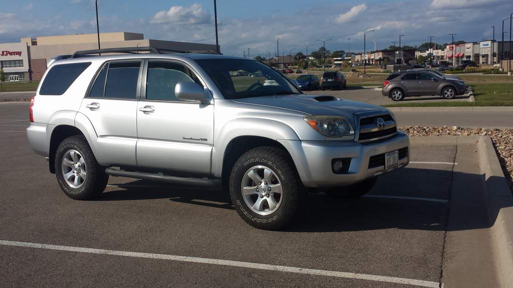

i went with all four KYB shocks, coil overs in the front with new springs preinstalled & replacement shocks in the rear keeping the stock springs. the KYB definitely raised the front about 1.5-2" over the 140k miles original XREAS shocks, 2" does not make it nose high, most people offset the front about 2" from the rear to reach level, mine is very close to level but still a little lower in the front than rear, sits perfect for my needs & looks great IMO for a daily driver.
