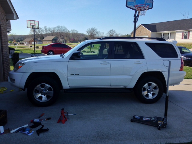

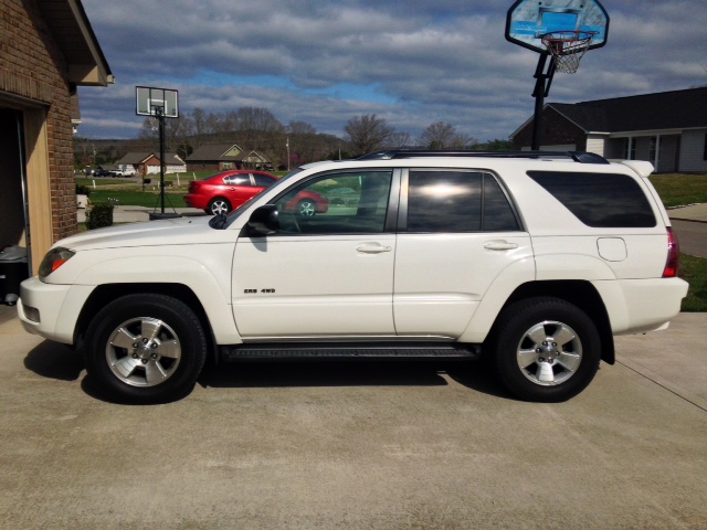

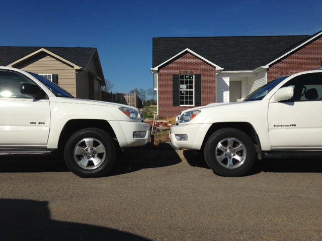

Daystar Leveling Kit Installed
Just finished my Daystar Leveling Kit Installation. I ordered it used on eBay, and thought I was getting the Daystar Comfort Ride 1" Budget Boost KT09117BK. After looking at the finished product, I think I actually received the front spacers for the Daystar 2.5" Front 1.5" Rear Lift Kit. The spacers look just like the picture from the lift kit and not the ones from the leveling kit.
Took about 4 hours to install after I stripped a nut on the strut tower like an idiot. Only real difficulty was re-installing the lower strut bolt by myself. The lift raised the front exactly 2" on both sides. The stance is so much less girly now, and I'm satisfied. There's about a 1/2" rearward rake now when measuring at the running boards, so I'll probably install spacers on the rear also when I buy 265/70R17 tires.
