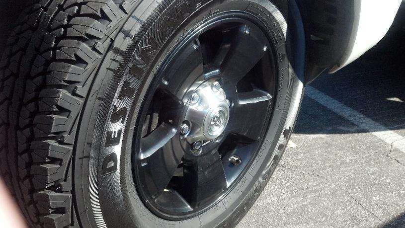

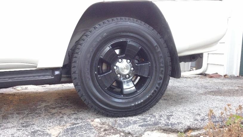

255/75r17 Firestone Destination A/T, C Load. Second set of these, but first time in this 32" size. Got the black PC SR5 wheels from a Tacoma guy. No rubbing. Sorry for the grainy pics.
Bruh... paint those center caps... :nod:
I know, right?! These are new caps! It's funny...the wheels went into the powder coater with original hub caps on, but they came out without 'em! What kind of black magic were they doing?!
For real though, I'm going to see how black plasti-dip looks on the caps. I just hope the matte finish doesn't clash with the shinier PC on the wheels.

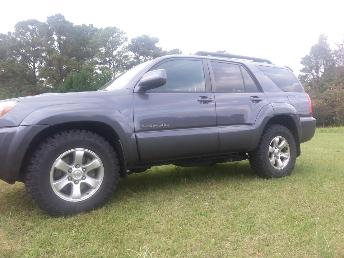

06 GX470, Icon 2.5 extended travel coilovers w resi/All Pro UCA/Icon 2.5 piggyback rear shocks/Icon 2" coils/17" Method Double Standard -12mm offset/285/70/17 Cooper Discoverer ATPs
