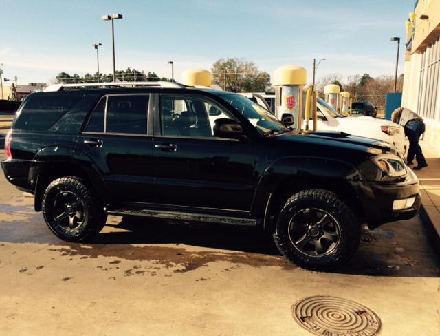

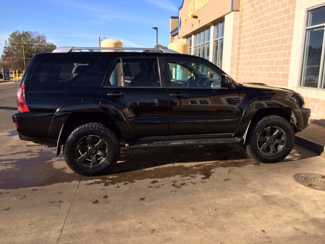

Thank you all for the kind words. Prior to the lift I was temped on selling and getting another 3rd gen (Felt like a soccer mom vehicle). Now I find myself grabbing for my 4runner keys than anything else.
Daystar 2.5/1.5
SPC LR UCAs
Konig Six-Shooter 17x8" wheels
General Grabber AT2 265/70R17 tires
Some rubbing at half+ lock. I think pushing the fender liners forward will fix this up just fine.

^ Damn!! those wheels are making me :hail::love::naughty::frisky::whoo:
I'm doing the same, I couldn't be happier with them!
What is the offset on the wheels?
0mm offset, 4.5" backspacing. I got them from Dustin [MENTION=85422]FNWheels[/MENTION]. Great guy and I highly recommend him!
FN Wheels ? Konig Six Shooter
I really like the white letters out
Thanks! I'm glad I went with them out like this. I wanted to jazz up the rig without having any stickers or decals on it - I think this does the job quite nicely :)

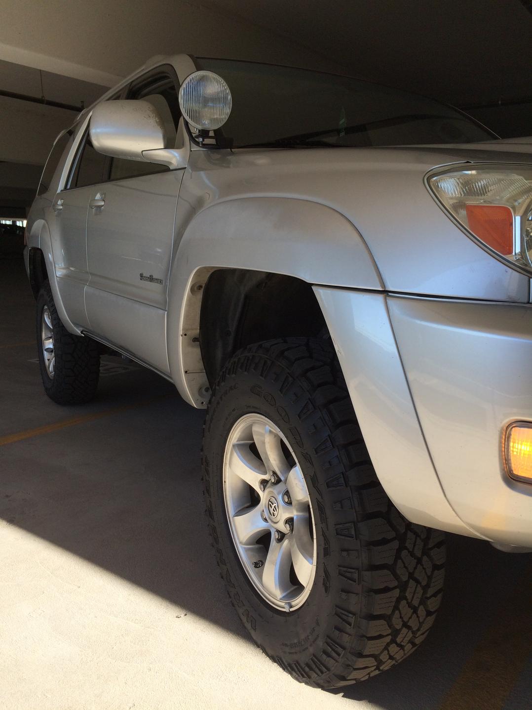

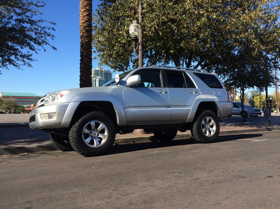

2004, 2WD, Sport, V8...
Removed factory XREAS, replaced with OME 885 Fronts and 895E Rear springs. Currently sitting on a new set of 255/75/R17 DuraTrac's. Spidertrax to come (or maybe new wheels, I haven't decided yet) but overall she sits damn near perfect for a 98%+ street driven truck.

I have to ask with that lift and those size tires is there any rubbing or a lot at full lock? Thinking about going to that size tire next and possibly that exact tire as well as I keep getting mixed reviews on other tires.
I wholeheartedly agree!! I have been wanting Duratracs since my last 3rd gen. but the reviews are awesome, depending on which tire establishment you ask.
Of course not counting the guys here which love them!!

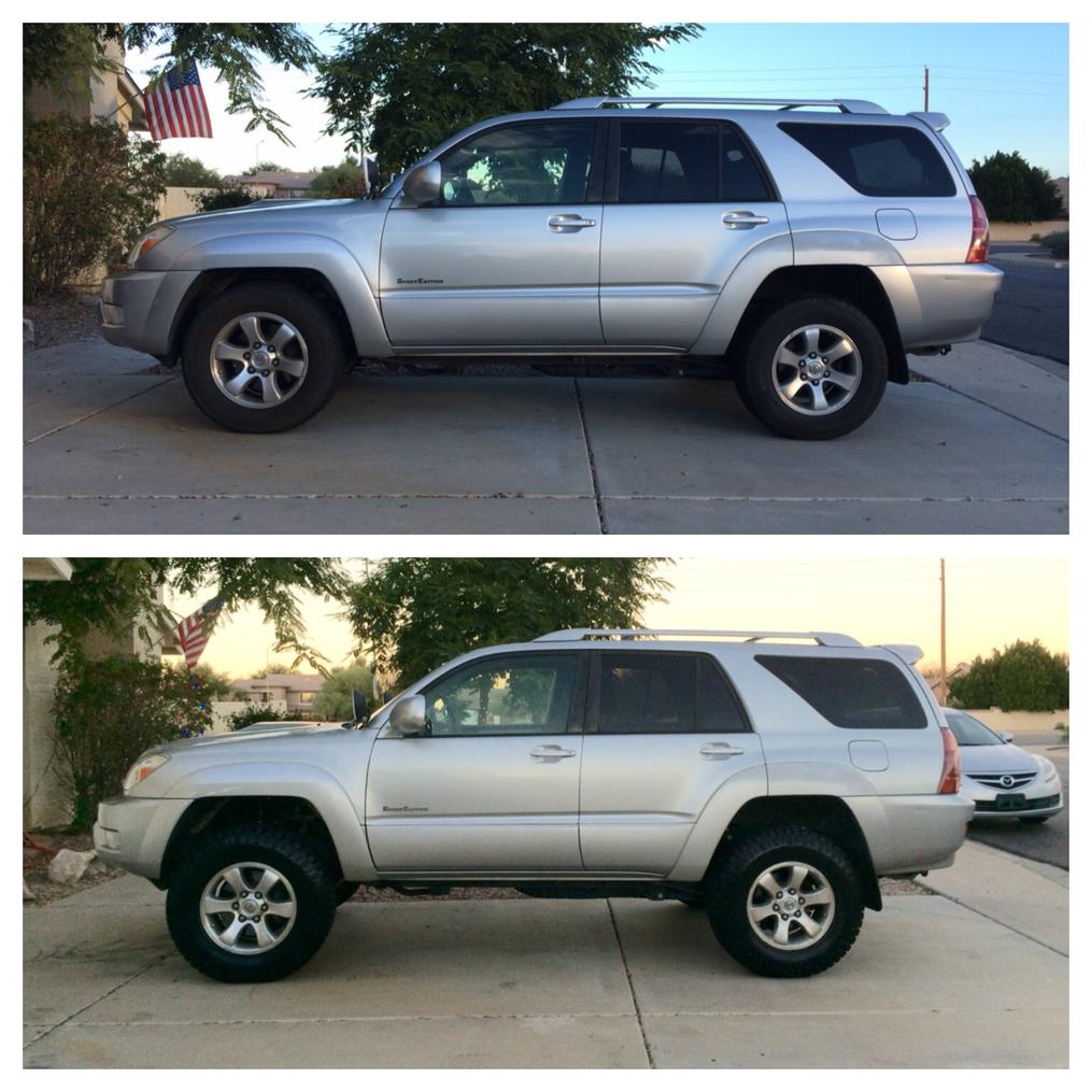

Before with DS 2.5 and worn out 265...
Now with 33s..(285/70/17)I'll get better pics soon.....I also think I'm going to trim the bumper because I want to have a little the look of a little
bit more clearance up front
