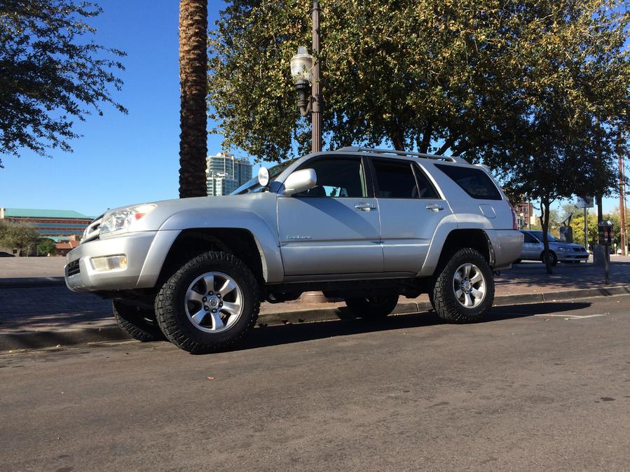

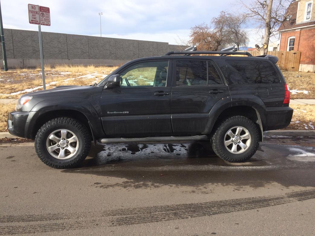

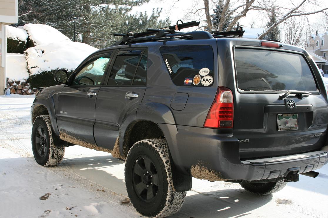

Just converted from stock springs with Bilstein 5100's set at 1.75" ring to level.
OME 885/895 With Nitro Sport Shocks all around
BFG A/T KO 265/70/17 with Spidertrax 1.25" spacers
Absolutely in love with this setup, I did't realize just how bad my ride was till I drove the OME's!!
Now to start on some armor!

Do you happen to have your measurements from the ground to your fender? Your truck looks perfect!

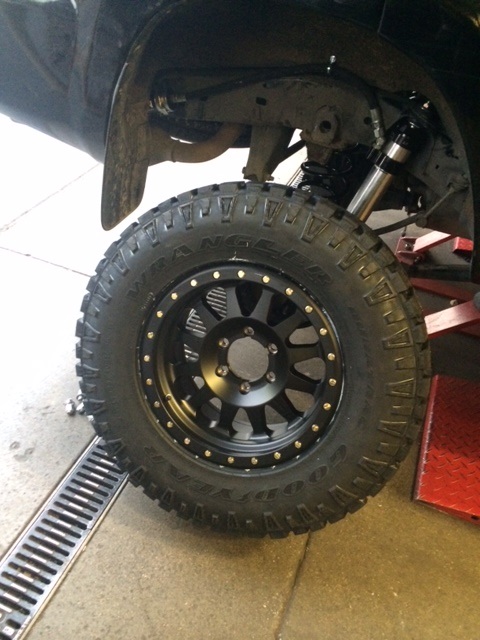

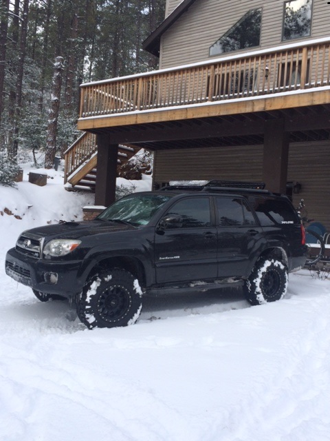

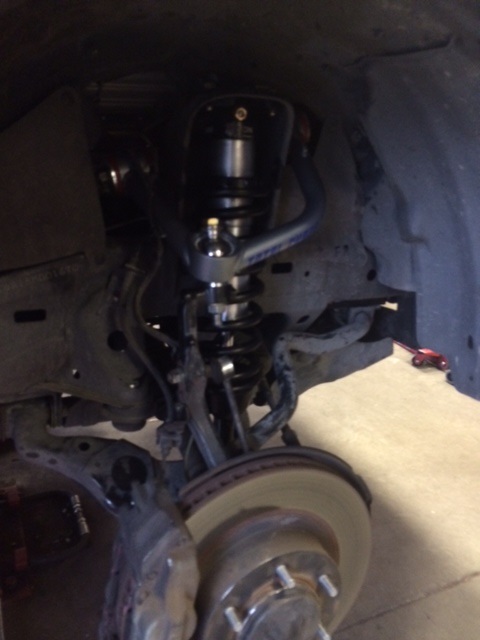

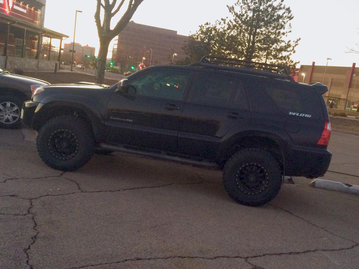

whats up,
Finally got around to a lift and wheels and tires for my 4runner :)
Suspension
Icon stage 2
Total Chaos UCAS
2.5 Remote Resi in the rear.
2" Icon Coils
Wheels
Method Standard 17 X 8.5 ( 0 offset )
285/70/17 Goodyear Wrangler Duratracs (Love these tires so far)
Much more Mods to come!

Nice! Got to love the Methods!

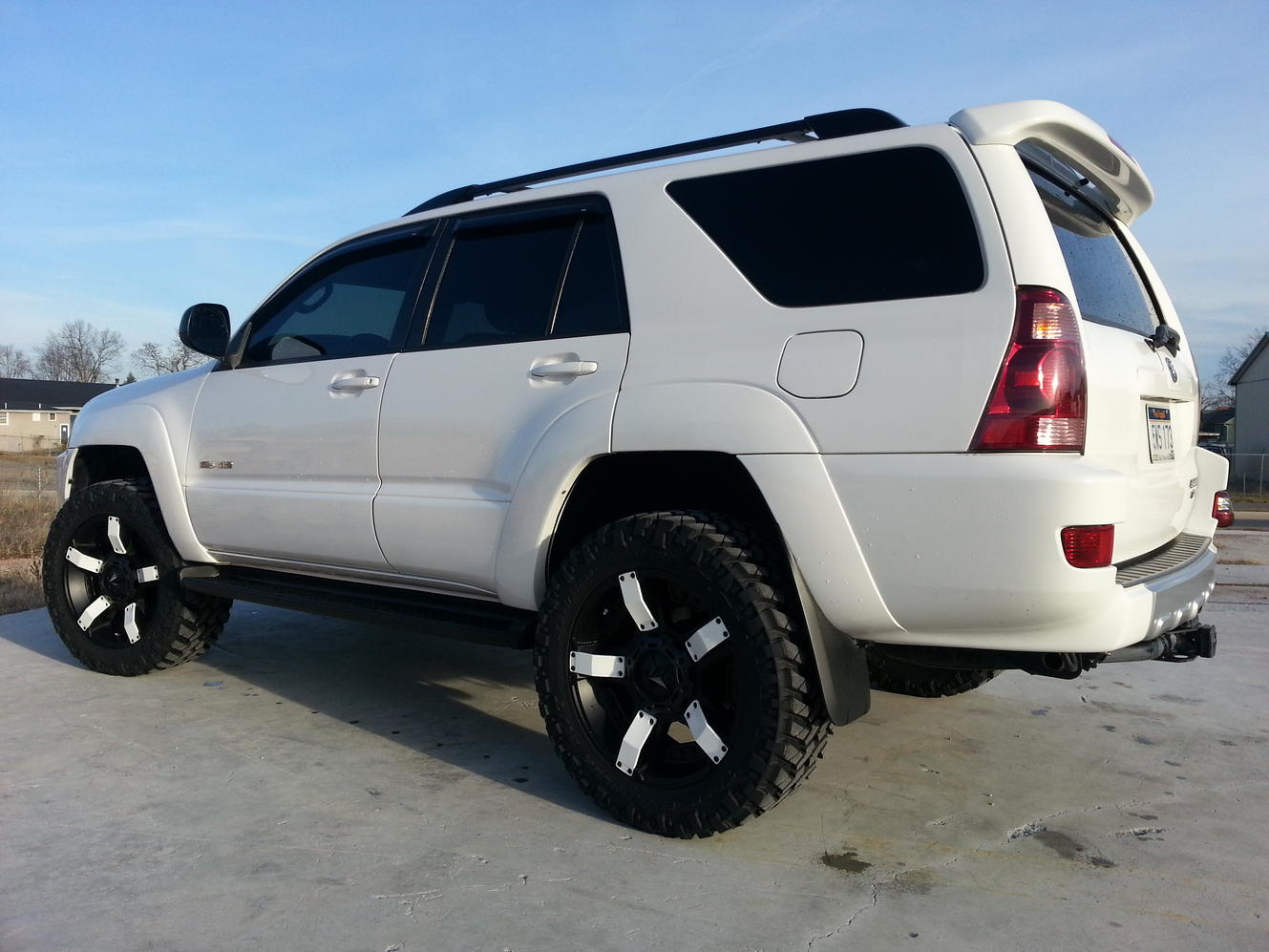

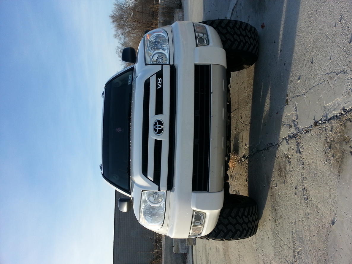

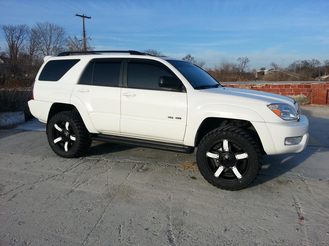

Hello !!! im new to this forum but have been looking at it for years . finally posting some pics .

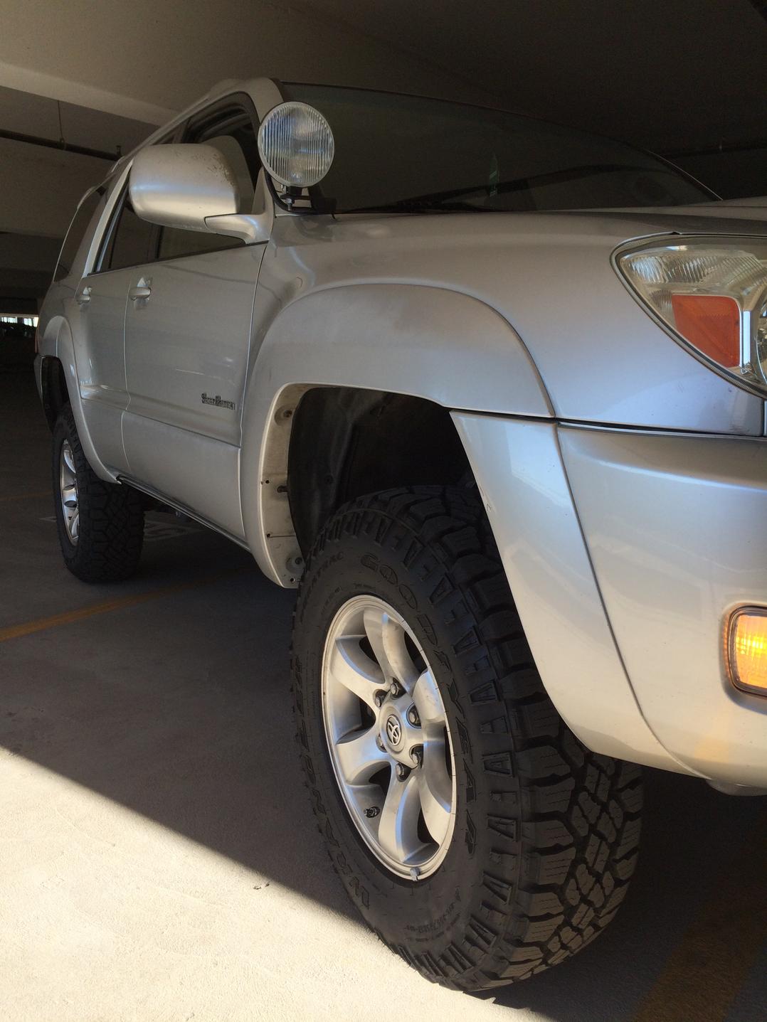

How much lift did you gain in the rear with those springs?
Roughly 2-1/4 to 2-1/2"... here are the measurements taken after 100 miles of driving but before the new DuraTrac's were installed:
Measurements are bottom of tire to bottom of fender well:
FL: 32.25" before, 36.75" after
FR: 32.75" before, 37.00" after
RL: 35.75" before, 38.25" after
RR: 35.50" before, 37.25" after
Measurements are top of tire to bottom of fender well:
FL: 4.00" before, 8.00" after
FR: 4.25" before, 8.50" after
RL: 6.75" before, 9.00" after
RR: 6.75" before, 8.75" after

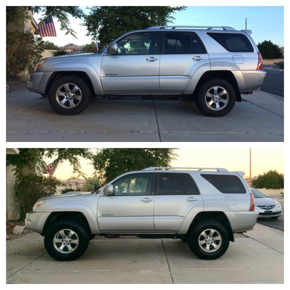

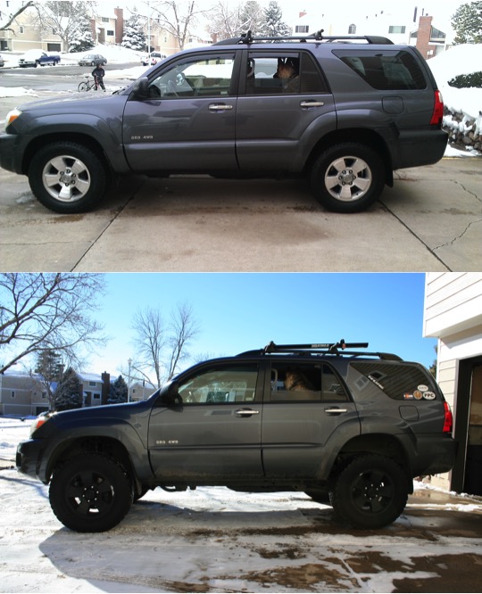

I haven't seen this lift on here yet. I wanted a lift that was a suspension lift but only 2"/1". I decided to go with Slees low lift kit below:
OME883 Front Coil Springs
90000 OME Front Struts
60004 OME Rear Shocks
OME895E Rear Coil Springs
Top pic is before, bottom is after. Sorry didn't take measurements.
As soon as I get some more pennies I'm adding 265/70/17 duratracs!

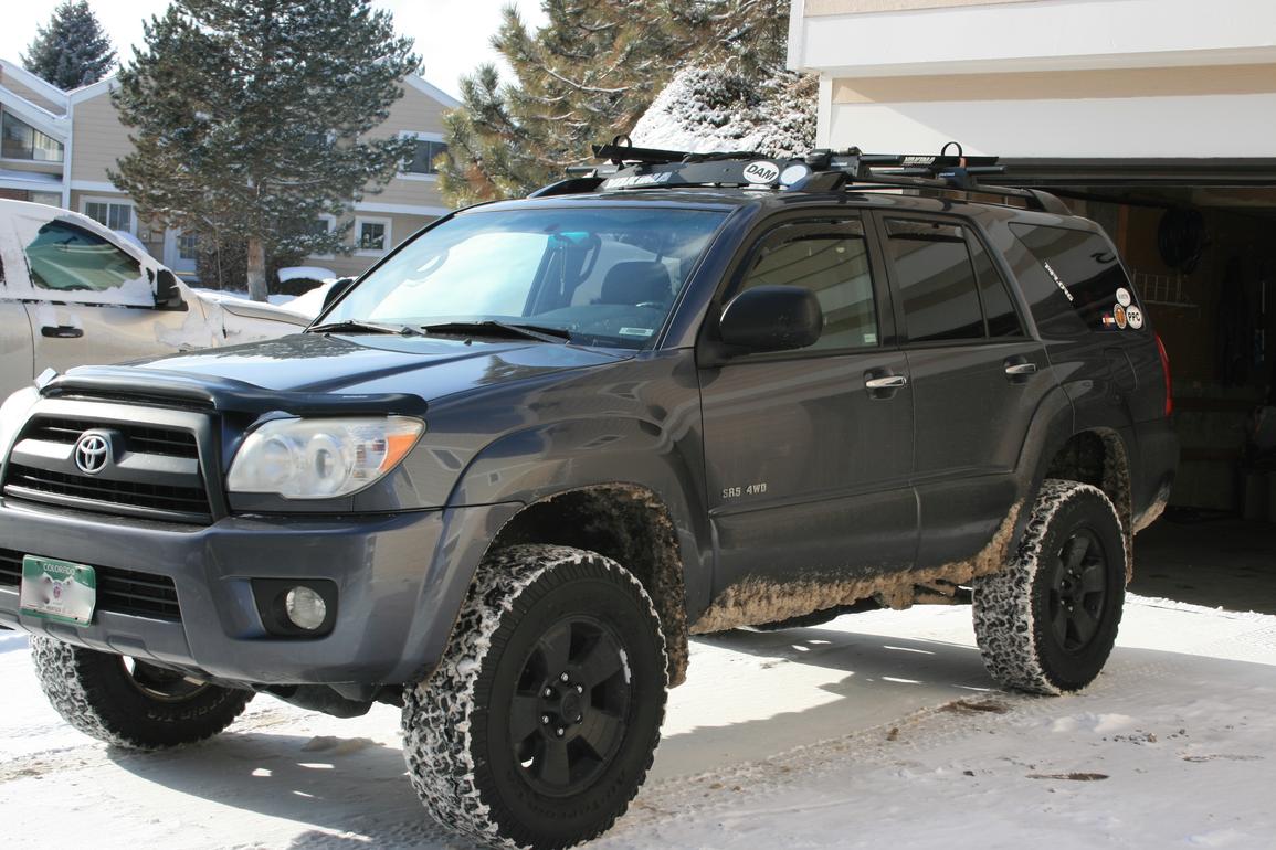

Duratracs!

I really like the look of your 4R with the new springs/shocks. I'm about to install OME 885/895 with Bilstein 5100s myself. These pics make me even more anxious!
