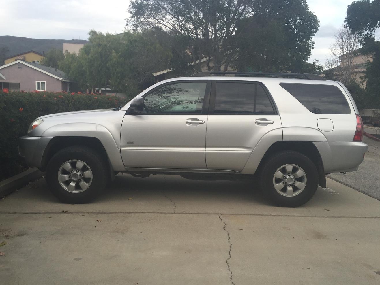

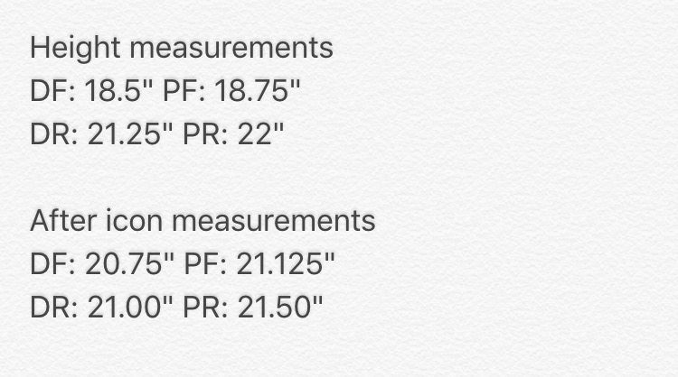

2003 SR5 V6 120,000miles
I just put Icons on the front. I got them pretty much new from Trdmedic. They are great and I love the ride. I also had a friend that was selling very lightly used icon 1-3" rear monotube shocks for cheap.
Now I'm trying to decide on the rear coils to go with. I don't want much more than 1" of lift in the rear so I was thinking of Sway Away 1.5" rear coils... But I have to get at least 1" to use the icon shocks, and avoid the coils from becoming unseated at full droop.
I'm going to go to 265/75/16s so I also want wheel wells to look nicely filled. There are my measurements from center of hub. And a picture of what Old Dolores (yes, that's her name) looks like right now. Any help? Suggestions? Pictures of a similar set up?

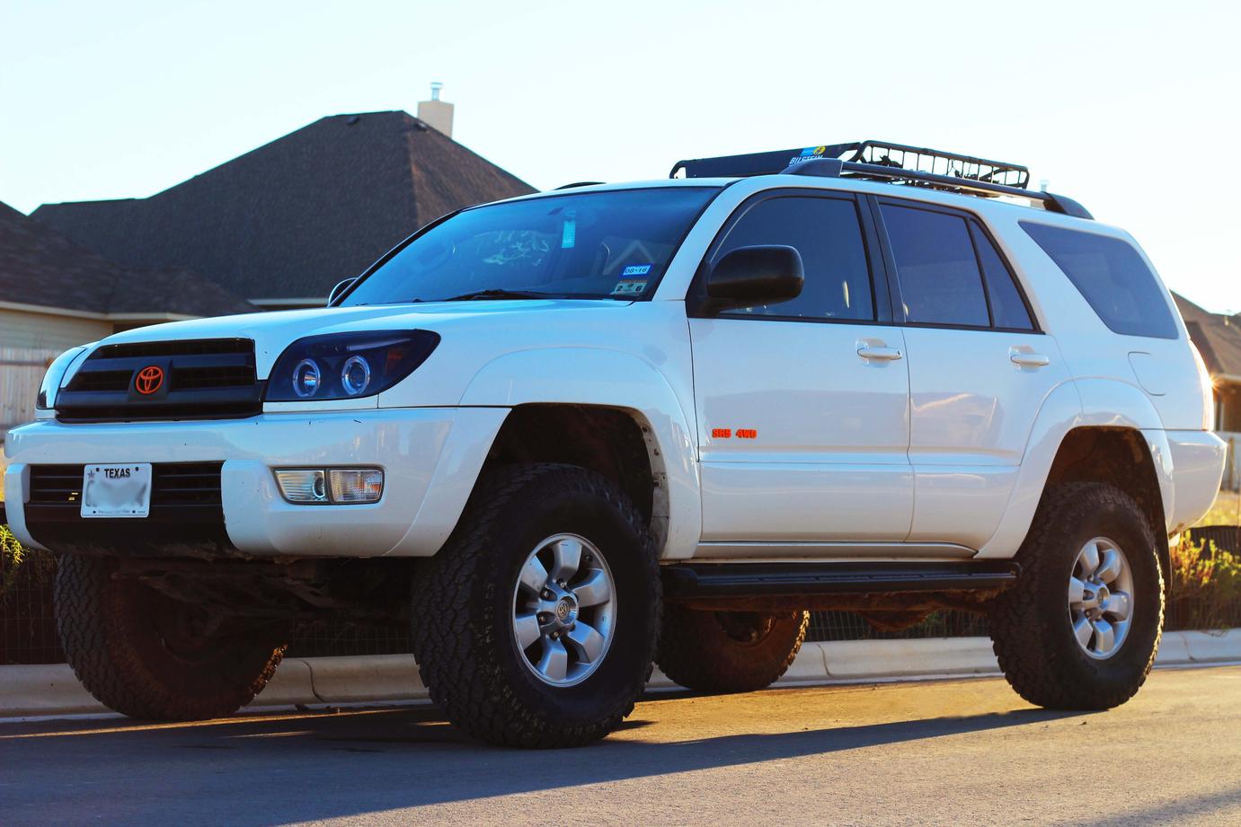

Front: 5100s, OME 885 Coils, & 3/4" Toytec Spacer
Rear: 5100s, DS 1.5" Spacer, FJC Rear Springs
Spider Trax 1.25" All Around & 285/75/16 General Grabber AT2

Looking good!

Looks very good! hope mine comes out similar!
