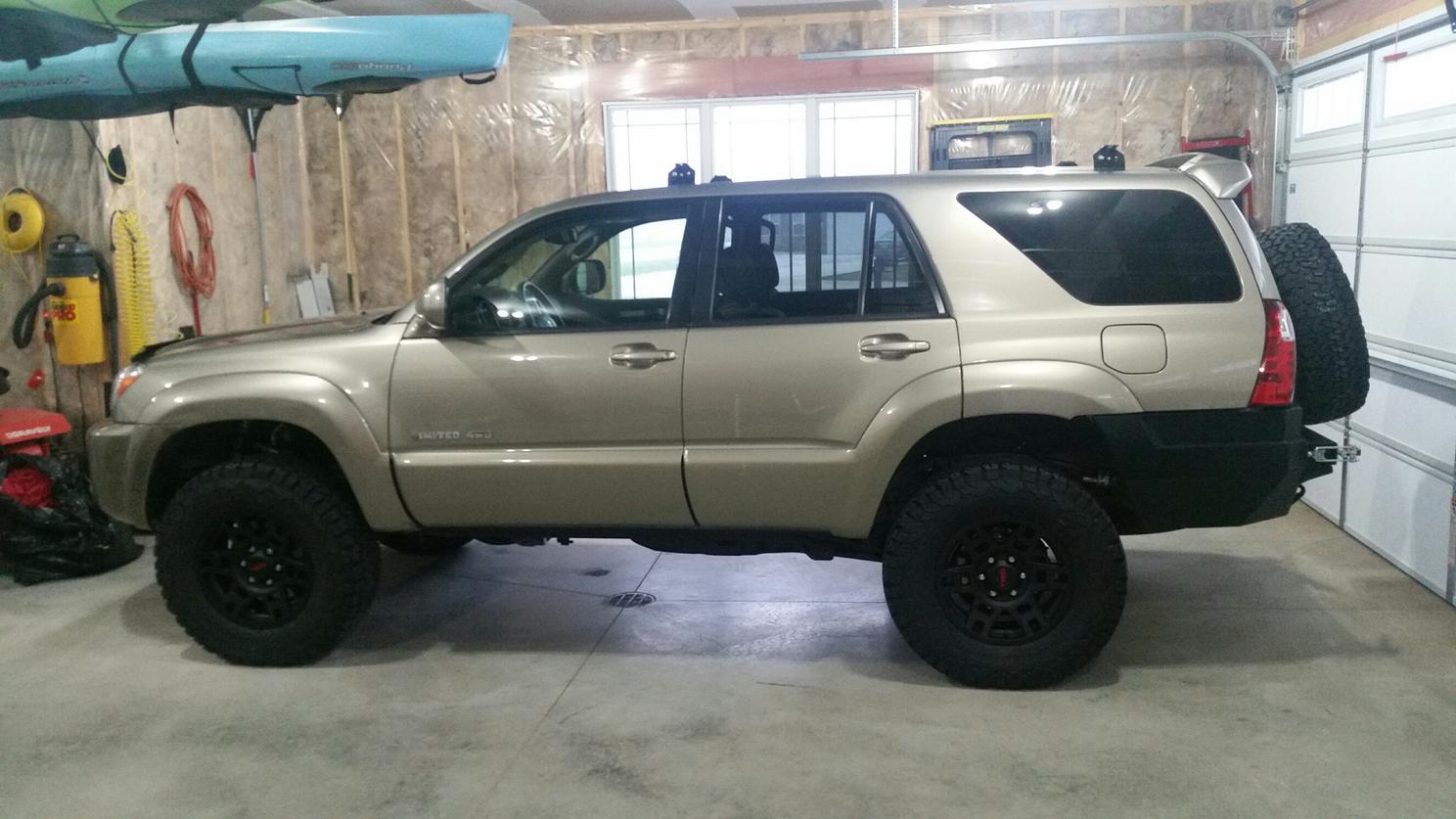

Lifted my 2007 over the holidays. Icon 2.5s with 285/70r17 BFG AT KO2s and CBI rear bumper

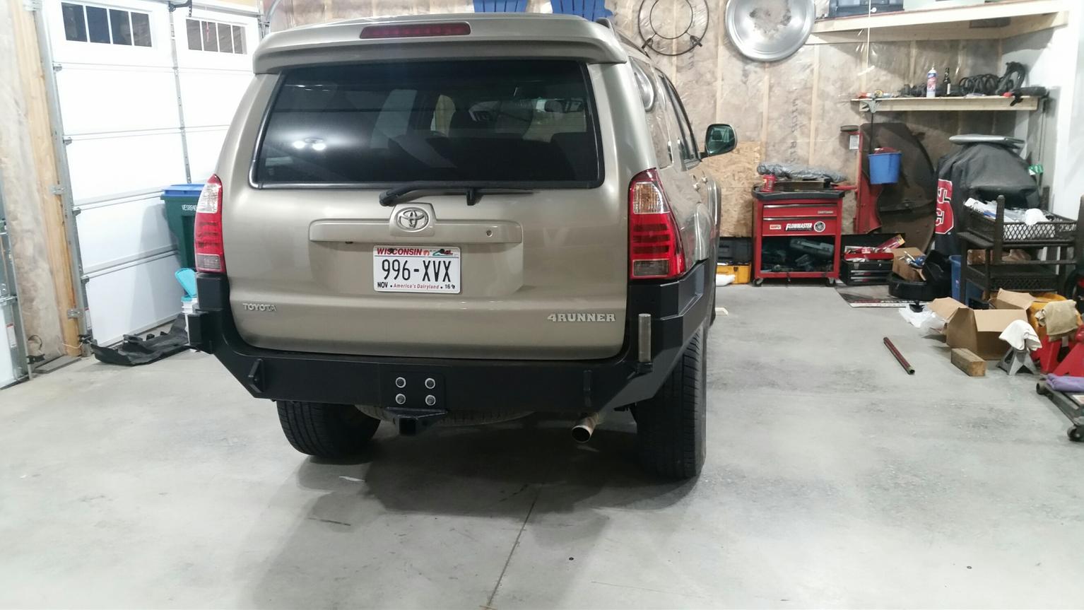

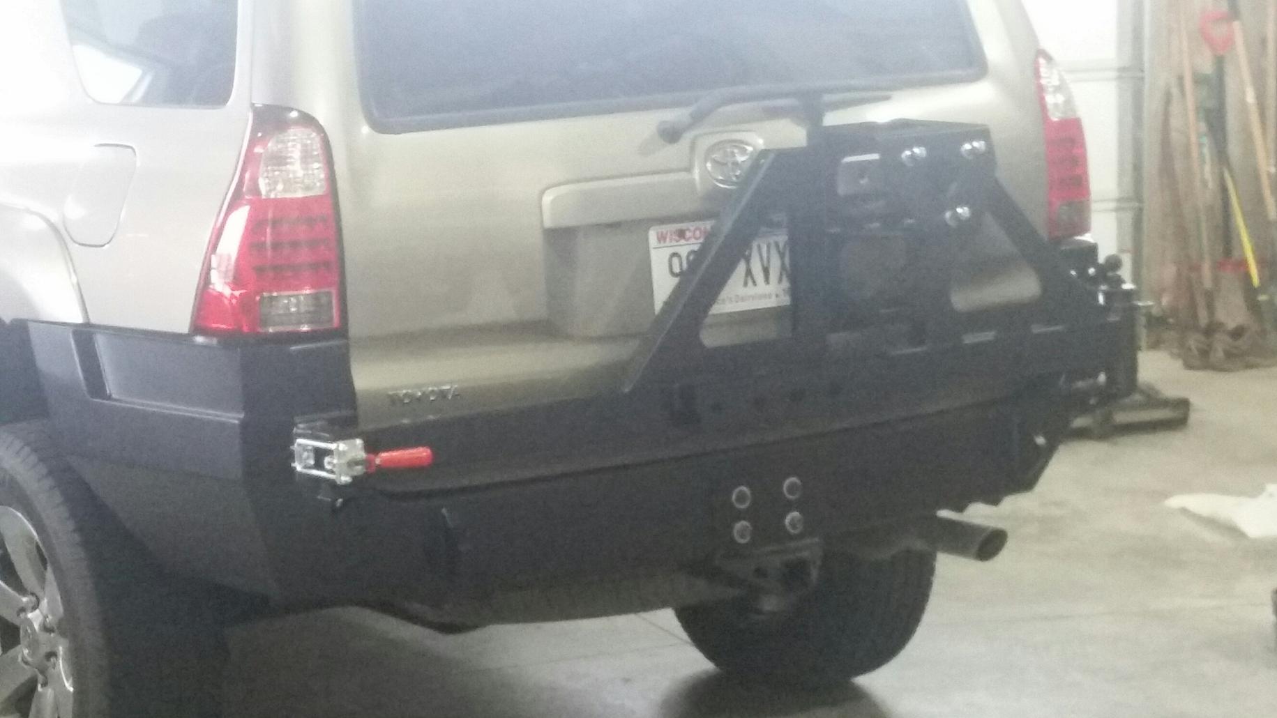

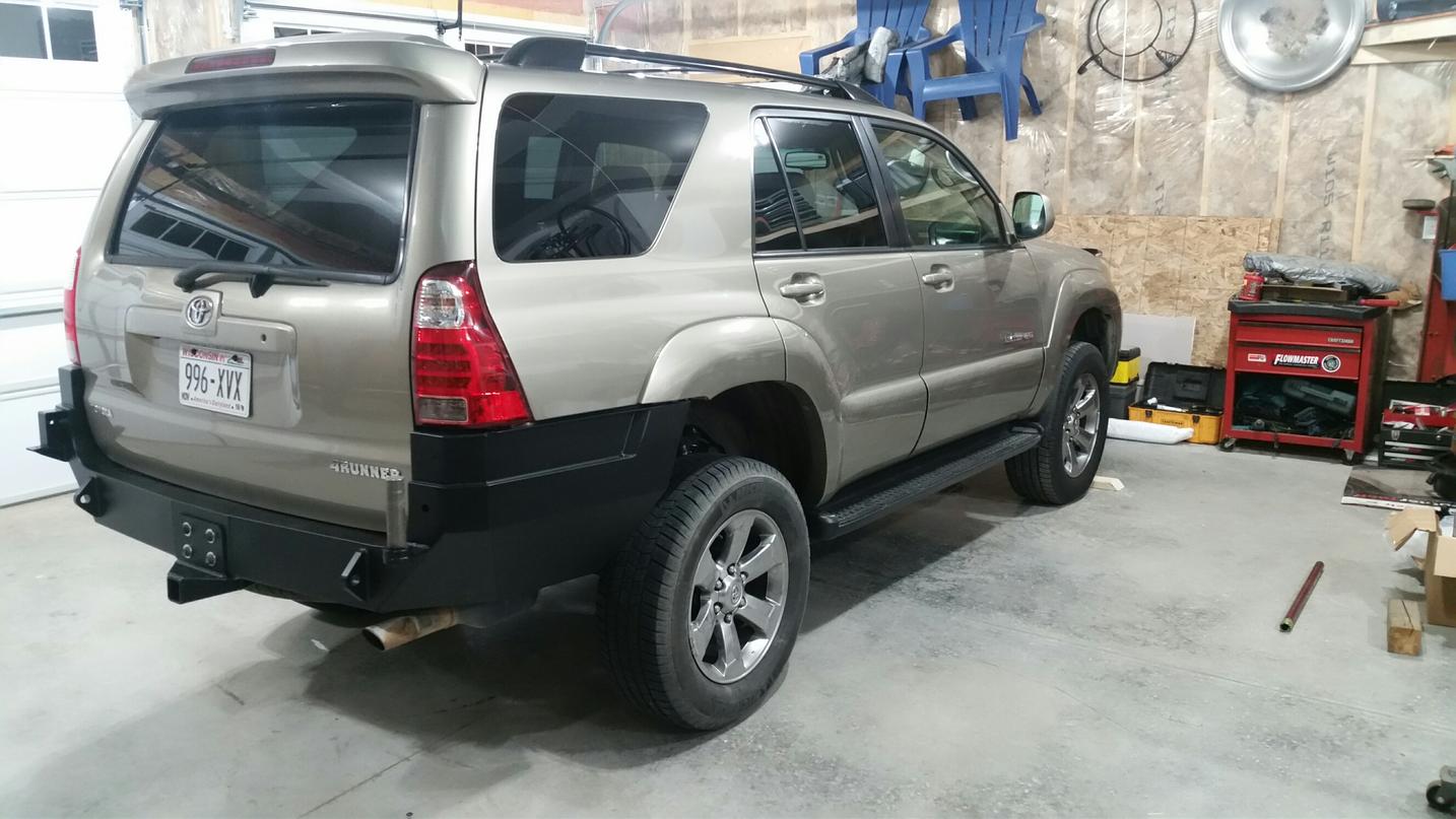

Sure thing HOJeepster. Your 4Runner has been one of the many inspirations for my build. Here are a few pics that I had already but I would gladly take more if there are specific ones you would like to see. The install wasn't hard except that it didn't fit perfectly so I had to mess with it some after the install. I wish the bumper was 1/2" wider so that each side was spaced away from the body by 1/4". The sides of my bumper touch the rearmost fender flare brackets on both sides and a little extra width would eliminate that. I could lower the bumper to get a little more room but I would have to make some spacers to do that. I ended up wedging some rubber bushings between the bumper sides and the body to keep the sides spaced out a bit. In the first pic you can also see the driver's side bumper side is angled up. I used one of the spacers from the old trailer hitch to align it.

I love the bumper but as with a lot of custom fabricated stuff there always some tweaking...

I'm pretty sure that CBI will put the tire carrier on either side and/or change the swing direction of it. You specify how you want it when you order it. I wanted retain use of the backup camera which is my primary reason for having the tire on the passenger side. The tire blocks the view some but the camera is still useful now. It wouldn't be hard to mount a new camera either though.
The carrier normally has more to it for mounting jerry cans and whatever else but I opted to have a tire carrier only. There is high lift mount long ways under/behind where the tire goes.

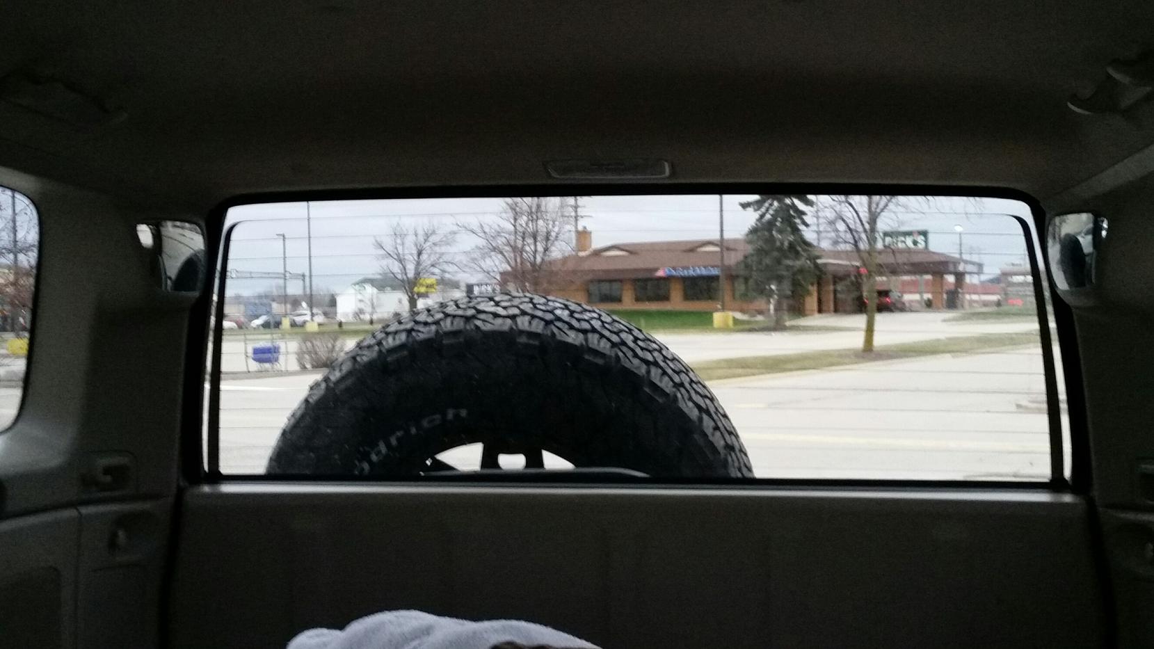

Here is a pic of my view out the back window. The actual tire holder can be unbolted and moved up and down on the swing arm. For reference where mine is located I know I can lower it a least one position down which would provide a little more visibility out the back window.

Thanks, great input. I wasn't aware the tire height could be adjusted. Looks good, it doesn't block as much of the view as I originally imagined.
