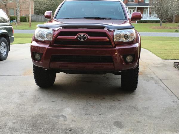

5100's all around - 2885's in front, Superflex rear (v8) w/ spidertrax on 275/65
I don't take her offroad (yet, I want to at some point) so it's more than enough for me.
Did you put on the top plate spacers in the front? I have the same set up, but you seem to be sitting a little higher in the front then I am.

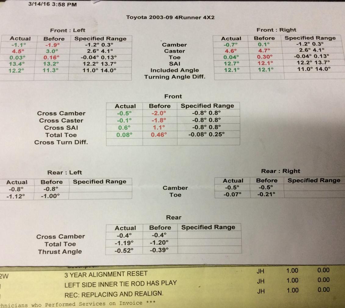

I thought this might be interesting for comparison ..since we both have the exact same set up
[MENTION=117408]Oneluv13T4R[/MENTION] Why do you think mine has so much? The rest of the numbers look very similar. I know he put in the "Modified Spec" on the machine to get them in green. I wonder if it has to do with flipping the steering rods over like I IM'd you about.

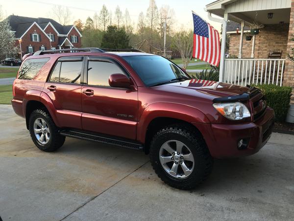

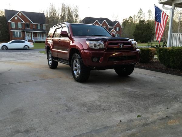

3/2 spacer lift
No wheel spacer
** minor** rubbing, nothing a little cutting won't remove
275/70/18 trail hog
Rides great, looks way better in person
What wheels are those?
Can you keep us posted on how you like those Exo grapplers?
X2 on the wheels. I wanted to try the Exo grapplers myself but didn't like the fact that they are heavier than the already heavy Nitto trail grappler which is more aggressive. Keep us posted !
