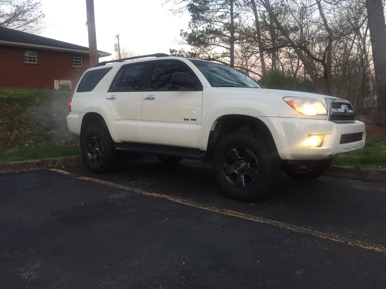

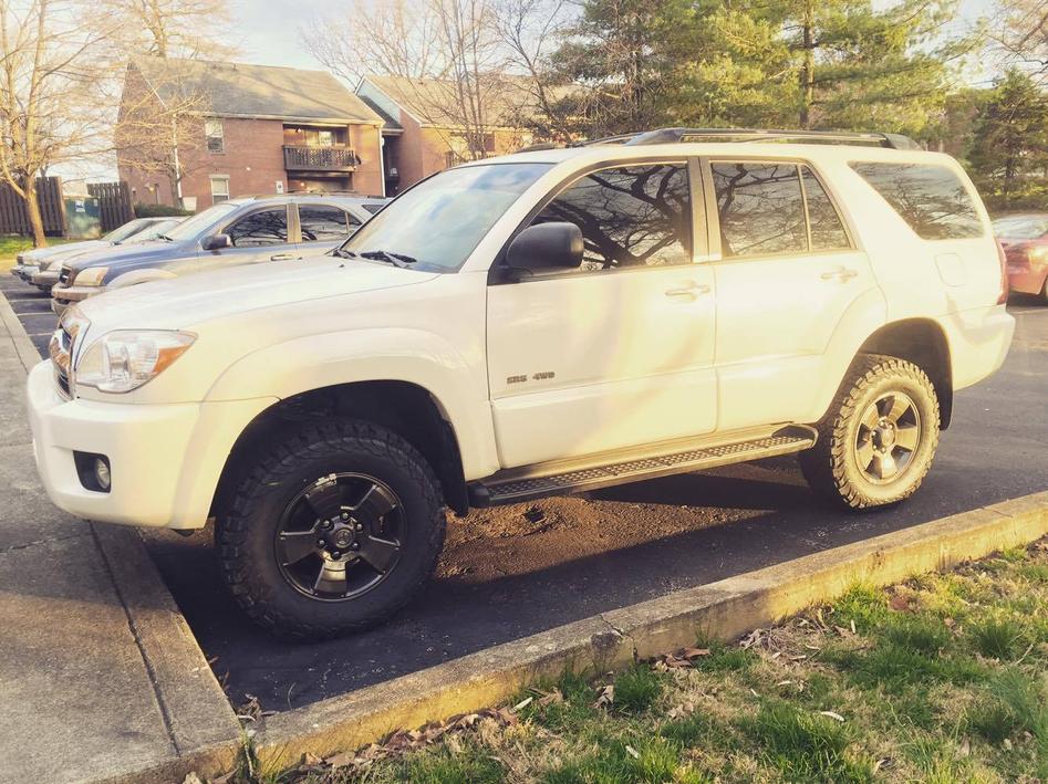

A test fit, 1/4" clearance to body mount and lots of contact with the already pushed forward liner at the front. 1" body lift and some trimming to start on tomorrow.

17x9 -12 285/70r17. Added a 1" body lift, trimming on front bumper corners, and body mount chop for no rub during parking lot testing.

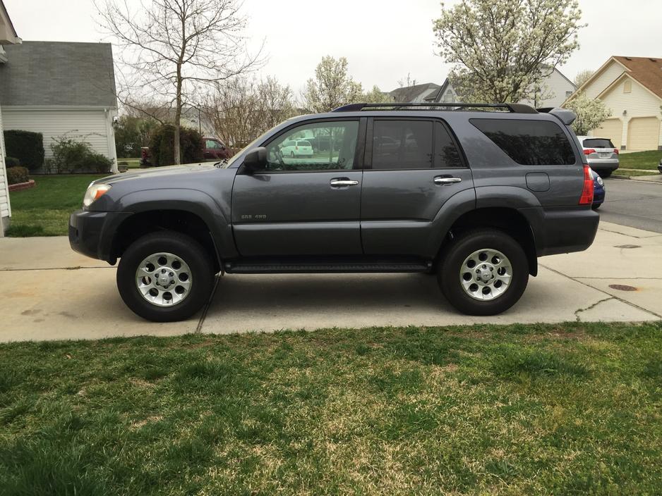

my 07 4runner have had it for about a month started with daystar 2.5/1.5 and fj springs, bought another set of 17" factory wheels with spidertrax spacers and 265/70r17 bfg KO2's hoping to do more in the near future. 12910860_1121606987860948_591944823_n.jpg
You had to trim even with the body lift ? That's very weird. All I had to do was trim plastic. I don't even need the body mount chop and I have 295/70/17 Toyo MT. And I have fully locked and turned it all the way I have about another inch or so to clear
Yep, it can be different based on alignment and wheel width/offset. At this sizing the arc the outside edge of the tire travels along left about 1/8" at the body mount and plowed into the fender liner hard in the front. I would rather trim more and have tons of clearance than tear up something unexpectedly.

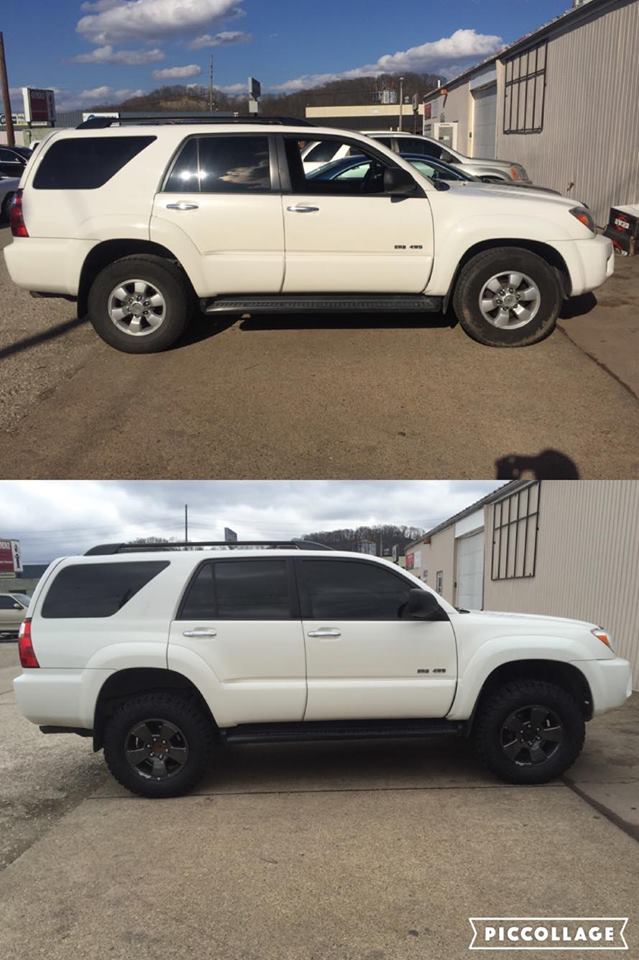

Before pics
