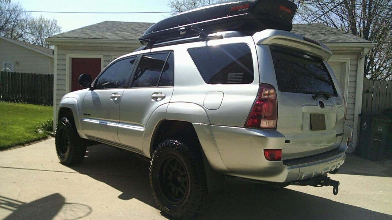

Nice builds robby655 and hobosapien. Didn't realize I was the 3rd titanium silver to post in a row. Silver and black ftw!! Looks like I should invest in some armor next.

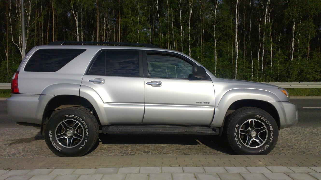

My modest lift
Bilsteins 5100 shocks all around. Front set to 1.75. Daystar spacers 1.5 in the rear. New Cooper Discoverers A/T3 265/75R16.

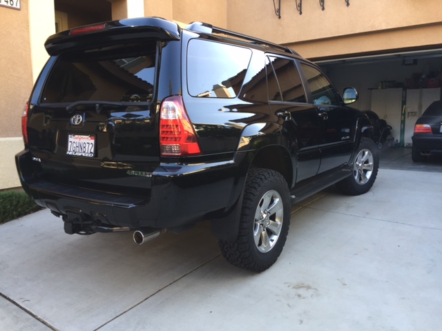

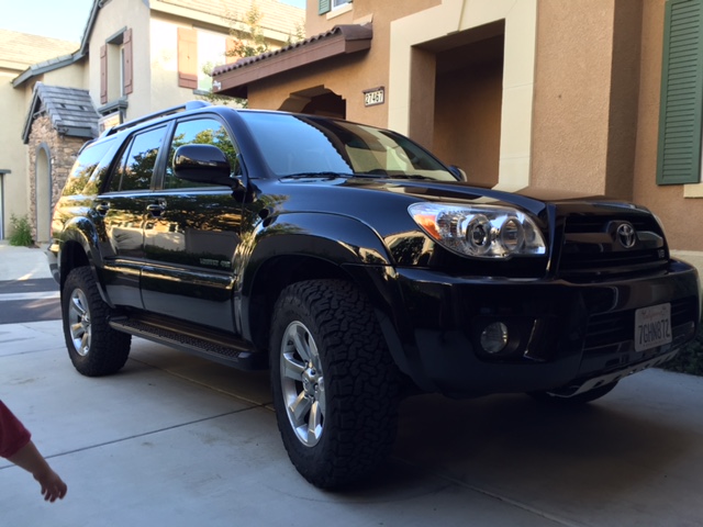

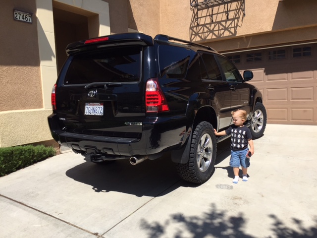

I couldn't take my 4th gen "hovercraft" look anymore!
Put on an OME "low lift" from Slee Offroad. Also running 1.25" Spidertrax wheel spacers. New BFG KO2s to complement the new suspension 275/70 r18, and happy to report no rubbing and alignment dialed in perfectly. Extremely happy with the way it rides, stiffer than stock but way less slop and body roll. It should have come like this from the factory. 2 year old added in for perspective :)

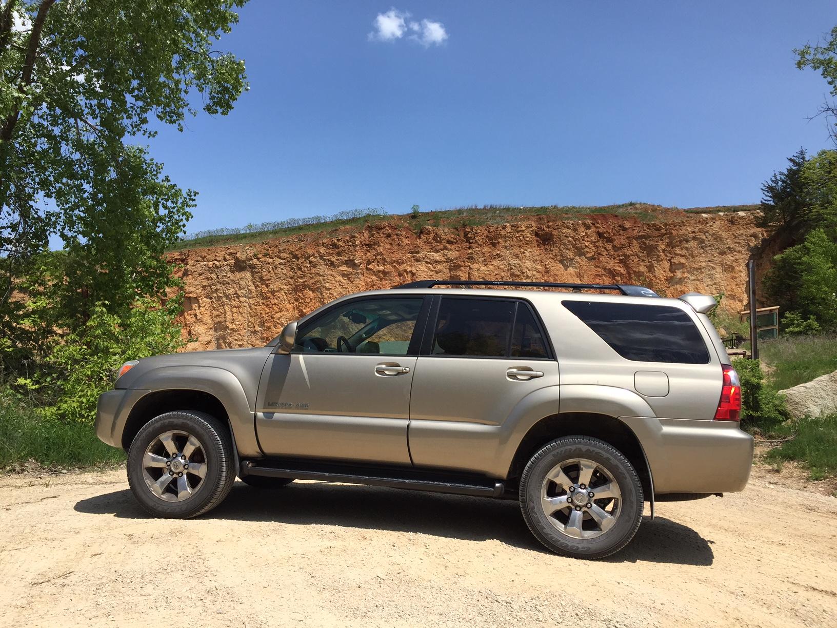

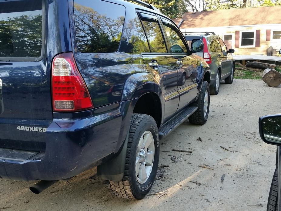

I just installed 5100's on all four corners last weekend. I set the fronts on the second setting (0.85"). I retained the stock springs all around. The job wasn't too difficult. The only hard part was getting all four wheels off the ground so I could remove the XREAS. All the info on this forum really helped.
I also wrapped the black TRD Pros on BFG KO2 265/70/17's. I have a little rubbing during reverse turns, but will remedy that soon.
Overall, I'm very happy with the outcome. I may go another notch higher up front because it's not completely level. It still has a bit of a stink bug lean.
Hit me up if you have any questions about DIY lift.

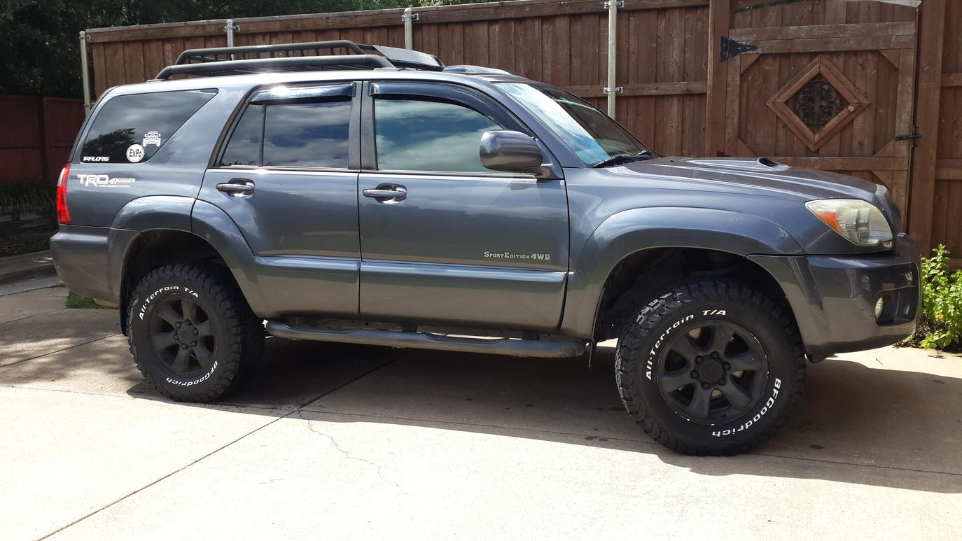

Finished my little lift last week. Thanks to all the Tacoma Suspension Swap threads and owners.
2015 Tacoma TRD Sport front springs and shocks all around w/ 15k miles. Rear springs from a 2011 FJ w/ 5k miles. Then added ATX Mojave teflons wrapped in 265/70/17 BFG AT KO. I had some slight rubbing on the front mud flaps and a little on the front of the wheel well liners.
Raised it about 2" in the front, a little under 1" in the back. Then new tires added another 1" to ground -> fender measurement. I have specific numbers if anybody really wants them.
Stock wheels w/ lift(no rubbing):
With new wheels+tires:

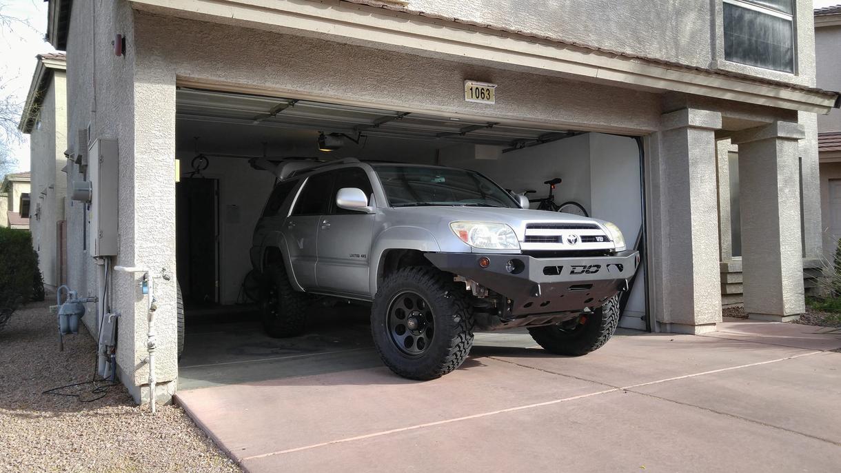

2004 V8 Sport. Icon Coilovers, Rear Icon Shocks and Springs, Total Chaos UCA's, BFG KO2's 275/70/17, 2016 TE Rims. Lots of other goodies.
Any way you can take some side profile shots? This is exactly the setup I am looking to run. My 2006's suspension is very tired and need to firm it up for DD handling as well as hauling gear on extended camping trips. Though I am looking to keep tires a bit more skinny at 265/70/r18.
Sharp looking 4Runner!
