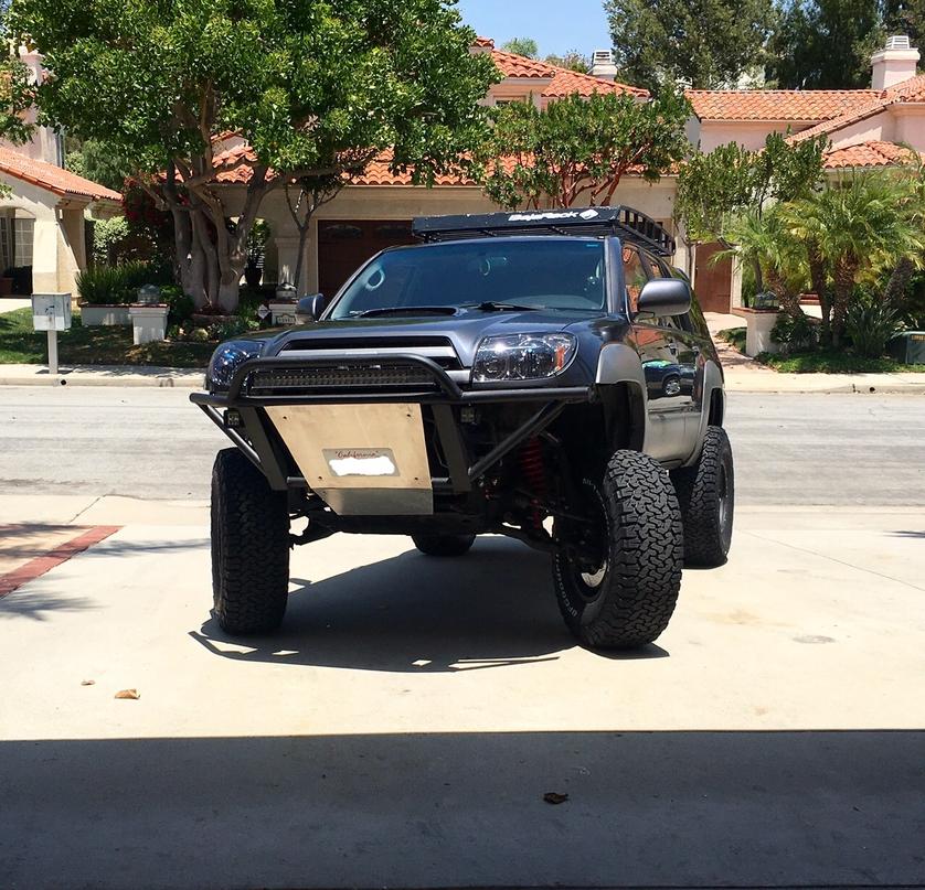

Well then.... Very nice. You are making a build thread right?!

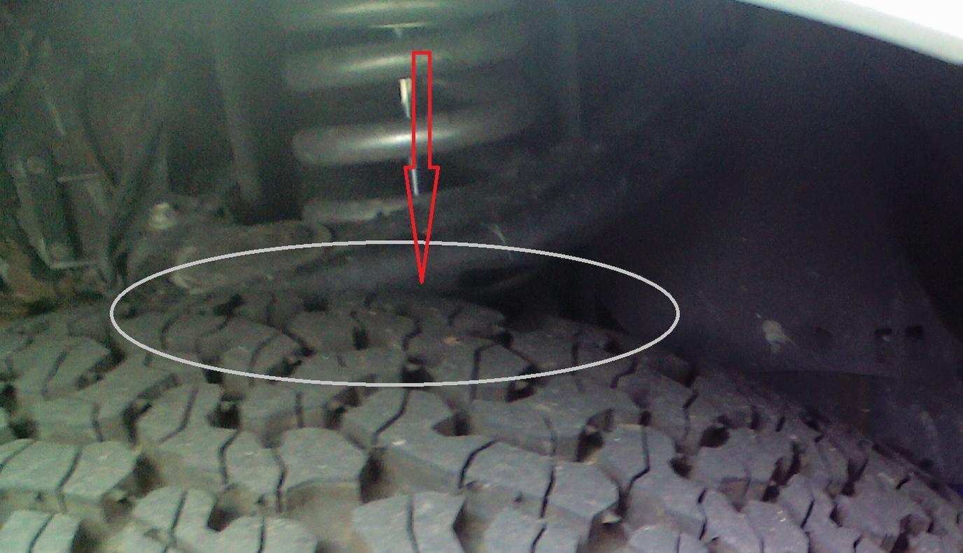

How much space do you have between here:
[MENTION=142213]dinoDNA[/MENTION] to the right of the arrow, is a little polished black spot. That's where it is probably rubbing. doesn't look terrible, but if you have parts laying around. I would think it would be best to go ahead and put them on instead of waiting a bit for the stockers to wear.

Thanks for all the info! I am going to pick up some zip ties on my way home from work and will be taking the exacto knife to the fender wells and bumper tonight. I think you're definitely right about the UCA contact; I will go ahead and swap those out this weekend (I picked Light Racing UCA's with the greasable joint on Amazon NIB but used for $300 bucks a few months back). Hopefully this will improve the situation, and I will report back on the findings. Fingers crossed that this eliminates the issue completely and I won't need to find a fabricator for the body chop!

On the UCA
You mean with the front swaybar, or with the tires? I have LCR UCA's but was waiting for the factory UCA's to wear a bit more.
theres that darkened area where it seems as if the inside sidewall of the tire could be rubbing against the UCA.

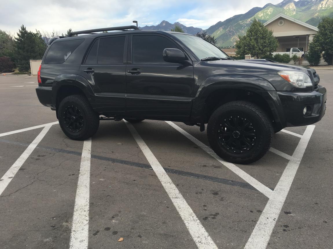

Finally got my new wheels and tires on! I debated for a very long time on whether to get 275s or 285s. I wanted the 285s all along but did not want to do a BMC. After tireless research and advice from forum members, I just said F it and went with the 285s.
I gotta say that I couldn't be happier and no BMC needed. The tire shop just pushed the fender liners forward and removed the front mud flaps. Thanks Carl!
Wheels are the SCS sr8 on 285/70r17 Duratracs. Bilsteins all around with front set at 2.5 and rear 1.5 daystar spacers.

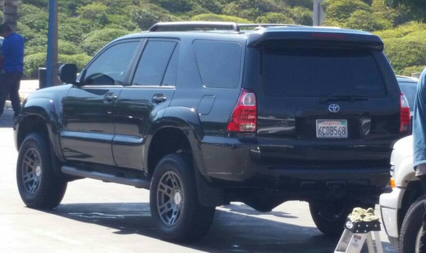

I've been lurking this forum since I bought her. First time posting pics...
-2008 4x4 Sport V6 (original owner w/ 110,000+ miles)
-Bilstein 6112s up front (highest setting)
-Bilstein 5100s w/ SAW 1.5 springs in the back
-17 in. Matte Gunmetal FN f(x) Pro wheels
-265/65/17 Michelin's transferred over from stock wheels. I'll upsize the tires once I wear the tread out on these donuts.

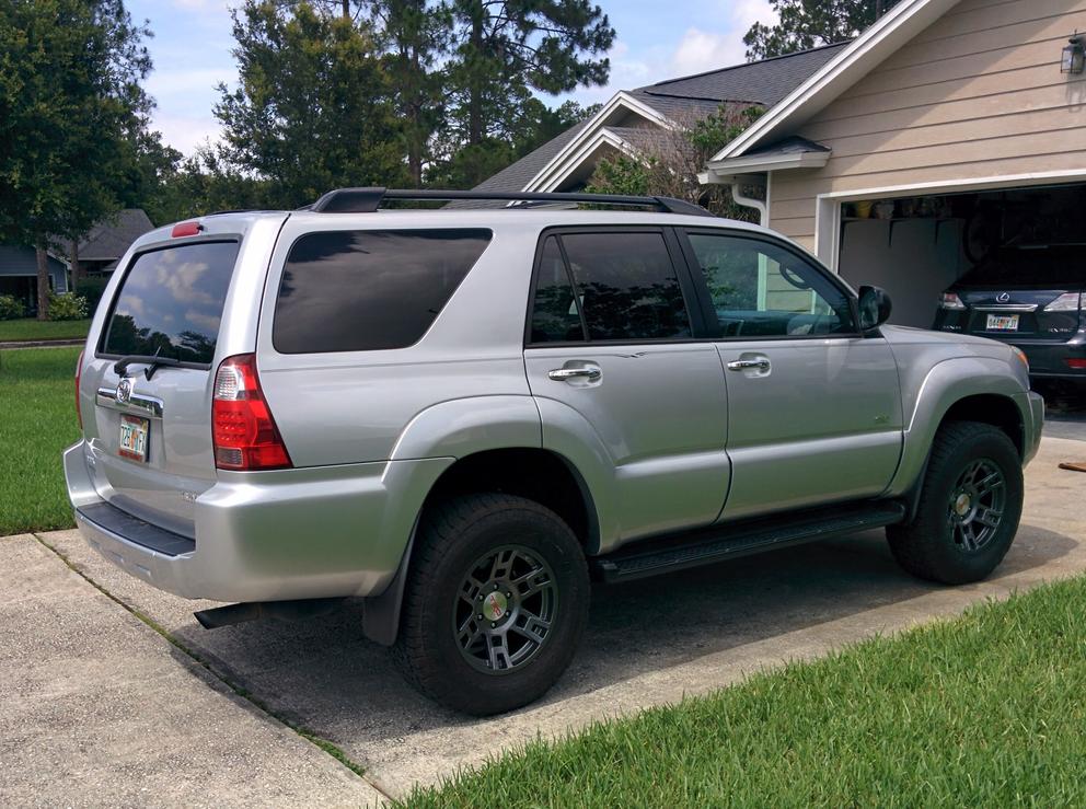

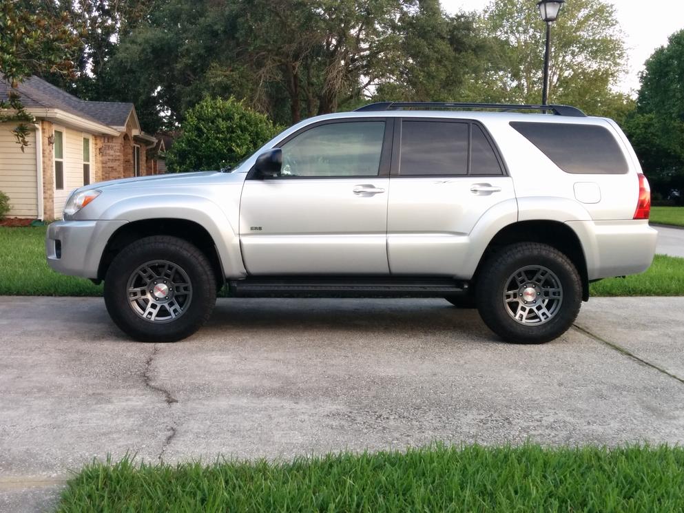

Finally did a real mod over the weekend.
FN f(X) wheels
265/70/17 Nitto Terra Grapplers
Daystar 2.5/1.5 lift
