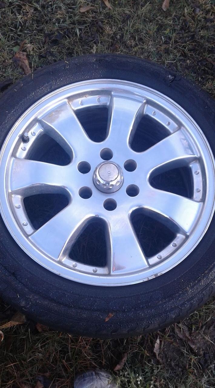

Ive researched these wheels and found info on similar wheels but not exact. I thought these came in the 2004 tundras, and im trying to figure out if they will fit my 2005 4runner; by fit i mean offset. Any help is appreciated. I attached a pic of the wheel, it is a 20" and has the 6x5.5 pattern.

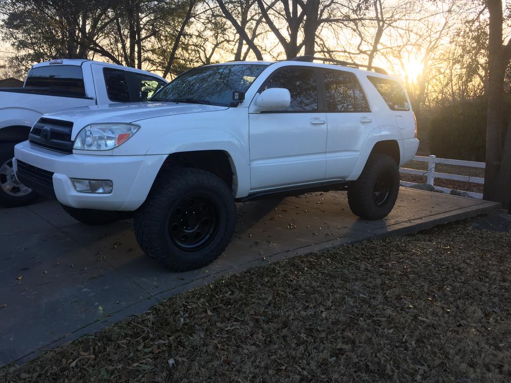

updated, mounted the 285's this morning.
OME 885's up front with their top plate spacers,OME shocks and SPC UCA's, then we have toytec super flex coils and OME shocks out back all sitting on some 285/70/17 falken wildpeak at3w's

That's a nice stance. Are you nose high at all?
thanks, not nose high at all. When i first installed the lift it looked like it actually sat about a 3/4" higher in the rear. Then again it could've just been the cut of the rear fenders/wheel well and body lines playing tricks on my eyes.
ok, that's good to know. What is your point of reference? Are you using the distance from the running boards to the ground or some other measurement point?

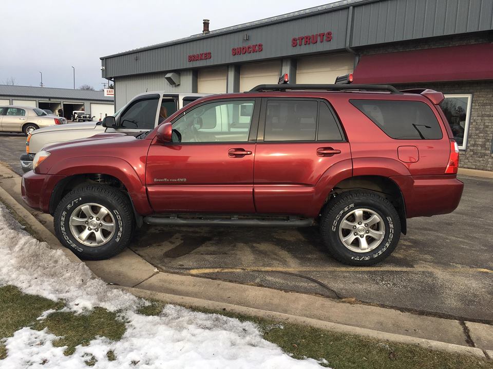

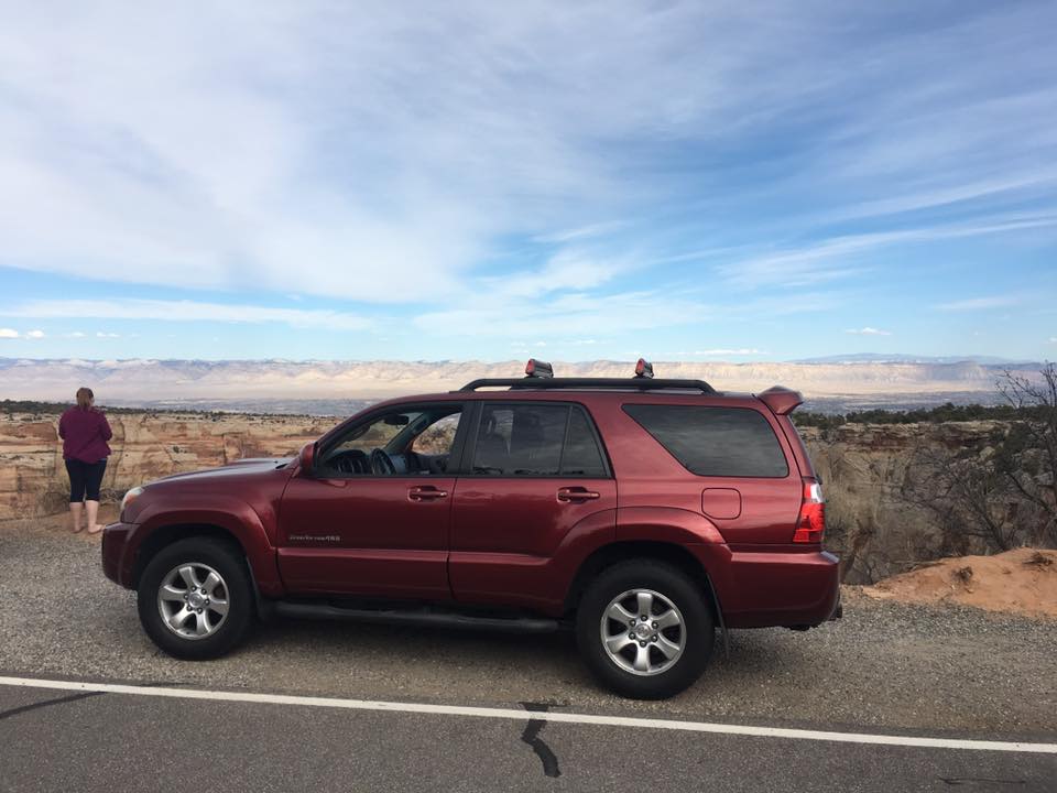

mine with saggy ol springs:
Now with stock tires and bilsteins on 2nd clip from top (1.75") on stock springs and toytech superflex in the back
Finally as she sits with 255/75 dynapros
As you can see I have quite a bit of rake after my lift. The superflex in the back gave me close to 4 inches of lift, and in the front I barely got 1.5 This is not a problem with bilstien, it is my old saggy springs.
This weekend I am throwing in my buddies used toytech 620 springs on the .85 clip setting to try and net 2.5 inches total.
21.5 inch front and 24 inch rear measuring from center of wheel to wheel well.
