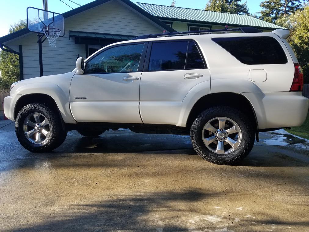

OME 885 FRONT
TOY TECH SUPERFLEX HD REAR
BILSTEIN 5100'S
LIGHT RACING UCA
PRO COMP PHASER 17X9 W/ -6 BACKSPACING
285/70/17 BFG KO2
Sent from my SM-G386T using Tapatalk

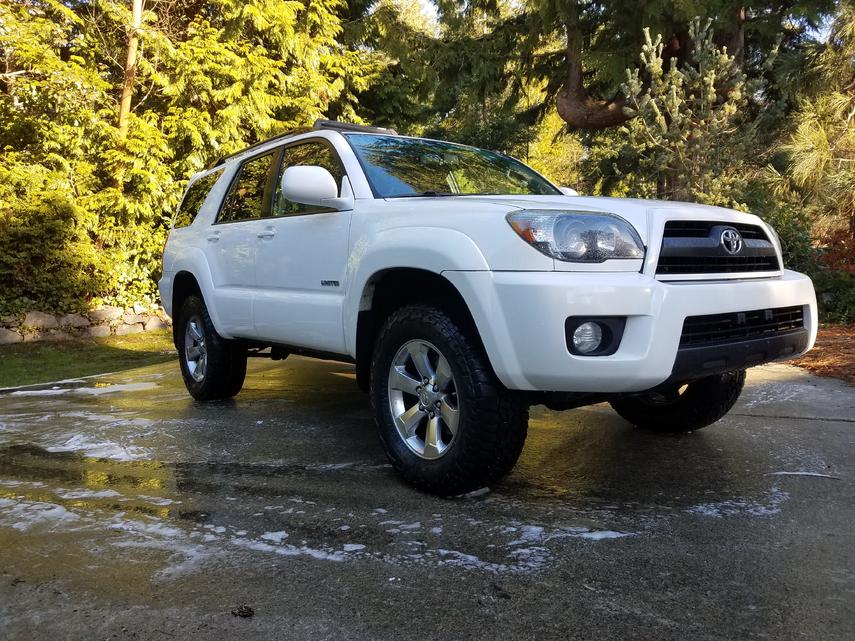

Daystar lift and 275/65/18 Wildpeaks
How do the ditch lights work at night snucka?
Sent from my SM-G920V using Tapatalk
i dont see any difference in the way the lights are shining while driving at night. got to put the new tires to the test these past few days in the snow and they performed great. no slipping at all very impressed with them.
Nice, I just installed my Toytec Boss lift last weekend. Planing to get some 275/70 KO2's when my current tires get thin.
Are you getting any rubbing with the 275/70's? I'v got a little rub on with 265/70's and 1.5" spacers, but I haven't had an alignment yet.
no wheel rubbing whatsoever. i was a little worried when we first put them on as the tire is abou 1" from rubbing on the control arm but theres enough room. even at full turning radius theres no rubbing.

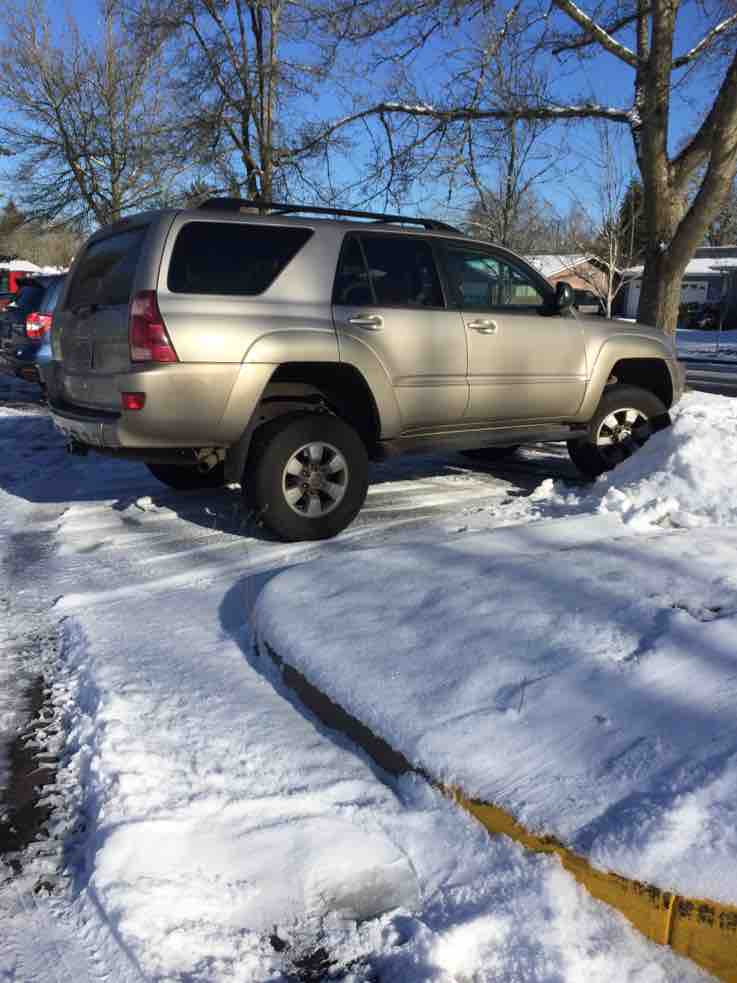

So I have a 3" overall lift.
(Coil spacer front, rough country coils and shocks rear) just to get started. Going to be upgrading to bielstien 5100 all around and get fj coils.
I also have a 1" body lift
It's a project and it'll take time to get quality components.
Current tires are 265/75-16 on stock wheels.
What size can I upgrade to? Assuming I also upgrade the wheels to 17" with some backspacing and/or offset.
I'm not opposed to getting wheel spacers if needed.
Nor am I opposed to doing a body mount chop and doing some trimming.
Just want as big a tire as possible. (Not too wide) but tall
285's would fit, 255 would be skinnier and fit. Or you could do some more trimming and shove some 35's in there!

285's will probably rub the spindle with stock wheels, they did on mine anyway. So you would need aftermarket wheels that are offset outward or wheel spacers. With my SCS wheels and 285's I haven't even rubbed the body mount, I only grinded it smooth just in case. The 1" BL will help gain tire clearance when wheeling. My only regret with my 285's is that I wish they were bigger. :eyebrows: Going 35's next.
