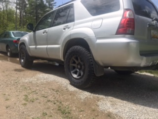

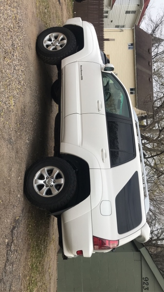

First post. Purchased a 2007 SR5 V8, 2 months ago. Have Bilstein 5160/6100 with superflex rear in house for install. B/O arrived for rims/tires installed yesterday. They rub up front currently. Will be relocating inner fender per other treads of removing fasteners - drilling - reinstalling.
Also have SPC UCA for install and am ordering a driver front CV axel as the boot is torn up.

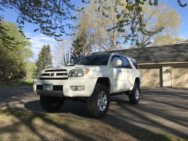

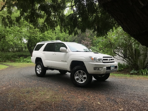

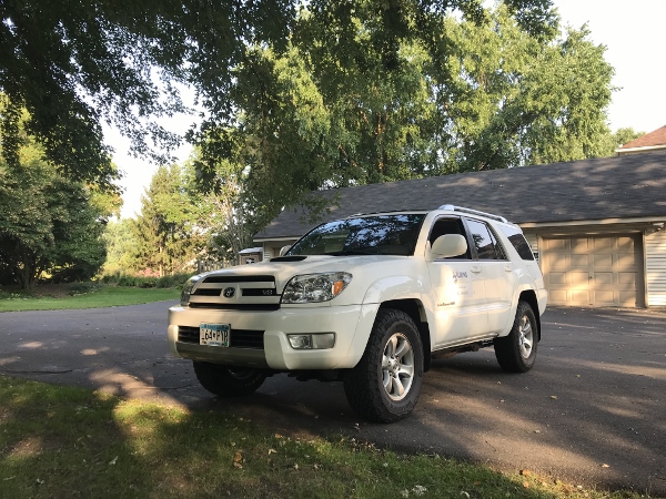

Finally got my setup finished this month after accruing parts since last November: Ironman 4X4 2.5" front (0-110 lbs) & 3" rear (440-880lb), with their forged UCAs. Sold the Sport wheels with SL265/70/17 General ATXs, and got my dream set of LT255/80/17 Wildpeak AT3Ws mounted on 5th Gen SR5 snowflakes.
Supporting parts: EimKeith PCK, OEM OTREs, garbage Moog LCAs with eBay cam bolts, Amazon front SB relocates.
No diff drop installed, the angles are pretty good looking (much better than my 3rd gen), the CV boots are still holding up, so far. Found a thicc Addco swaybar on Marketplace to install with new Proforged 2nd gen links (eventually).
Overall, very happy with the setup, and everything's solid. The alignment came out spot-on. The skinny LT Wildpeaks feel like they have less resistance on the road than the old SL General ATXs. I experience some rubbing on the front fenders in reverse, not fully-locked. My 3rd gen is the wheeling rig, and this is the camping-hauling-DD, and eventual dad-mobile. Planning on a front end overhaul in the 3rd gen in '22 with much beefier components.
Before:
doctorpopcorn-albums--05-v8-sport-lift-and-xreas-replacement-picture60311-8-26-20-before-stock-xreas-265-70-17-gg-atxs.jpg
After:
doctorpopcorn-albums--05-v8-sport-lift-and-xreas-replacement-picture60312-5-5-21-after-ironman-4x4-performance-lift-255-80-17-falken-wp-at3ws.jpg
Much easier with 2 people getting those thicc rear springs in with 2 people, axle fully-dropped:
doctorpopcorn-albums--05-v8-sport-lift-and-xreas-replacement-picture60317-stock-rear-springs-vs-ironman-4x4-rear-3-performance-plus-440-880-lb-springs-toy069b.jpg
I just wasn't satisfied with the 265/70/17s after the lift, and I've always been a pizza cutter fanboy:
doctorpopcorn-albums--05-v8-sport-lift-and-xreas-replacement-picture60318-lift-completed-gg-atx-265-70-17s.jpg
doctorpopcorn-albums--05-v8-sport-lift-and-xreas-replacement-picture60313-5-20-21-complete.jpg
doctorpopcorn-albums--05-v8-sport-lift-and-xreas-replacement-picture60314-5-20-21-front-fit.jpg
How you liking the ride so far with the Iron man?
It's solid and FIRM, which I'm used to, coming from my 3rd gen. With the spring(s) setup I went with, it definitely rides like a truck and not a Cadillac.
If I wasn't planning on short stints of hauling my travel trailer, I would downgrade from the rear 440-880lb springs to either their comfort or 0-600 lb performance springs.
However, when she's got weight in the back, the thing floats, and in a good way. Even without the rear sway bar in yet, it carries the weight well and predictable. This is a pic of how level it is with 900 lbs of concrete and 3 4x4x8s in the back:
doctorpopcorn-albums--05-v8-sport-lift-and-xreas-replacement-picture60319-loaded-900lbs-concrete-4x4s.jpg
On longer camping trips out west in the 3rd gen, with my 330 lb constant load springs, all loaded up, it would still sag a bit. Not a problem anymore with these springs lol.

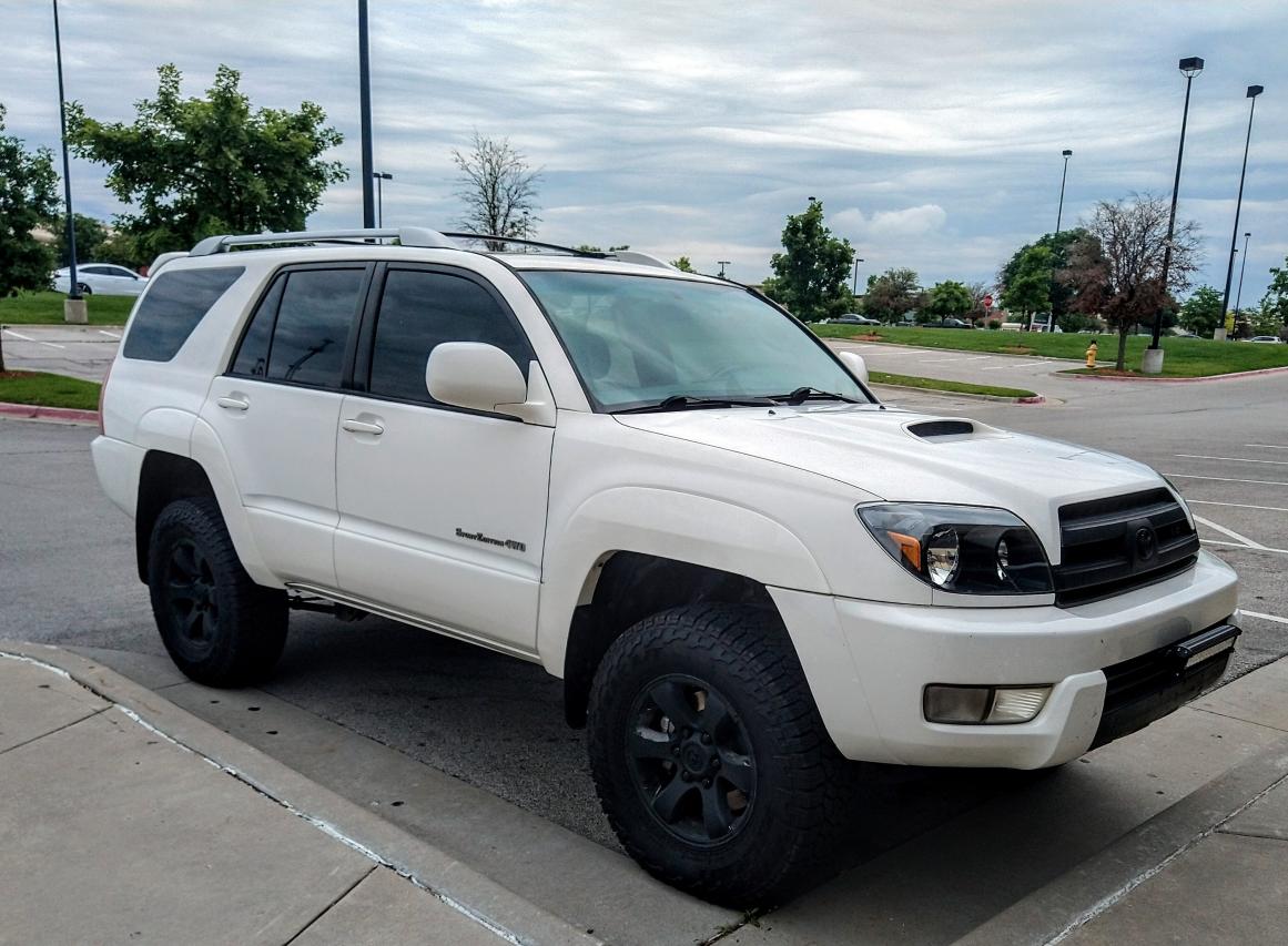

2004 Sport V8 4x4
Rancho Ready lift 9000xl adjustable front / rear.
OME 895 rear springs.
LT265/70/17 Falken Wildpeak At3 10ply.
Factory wheels plasti dip spray.
Wanting TRD wheels for the better offset to go bigger tires.
Very nice rig, i am in the process of shopping for a 4th gen right now and i want it set up just about like this.
What roof rack is that?
It’s the Prinsu rack. Highly recommended it especially because the lead time is a week and I got mine in less than that

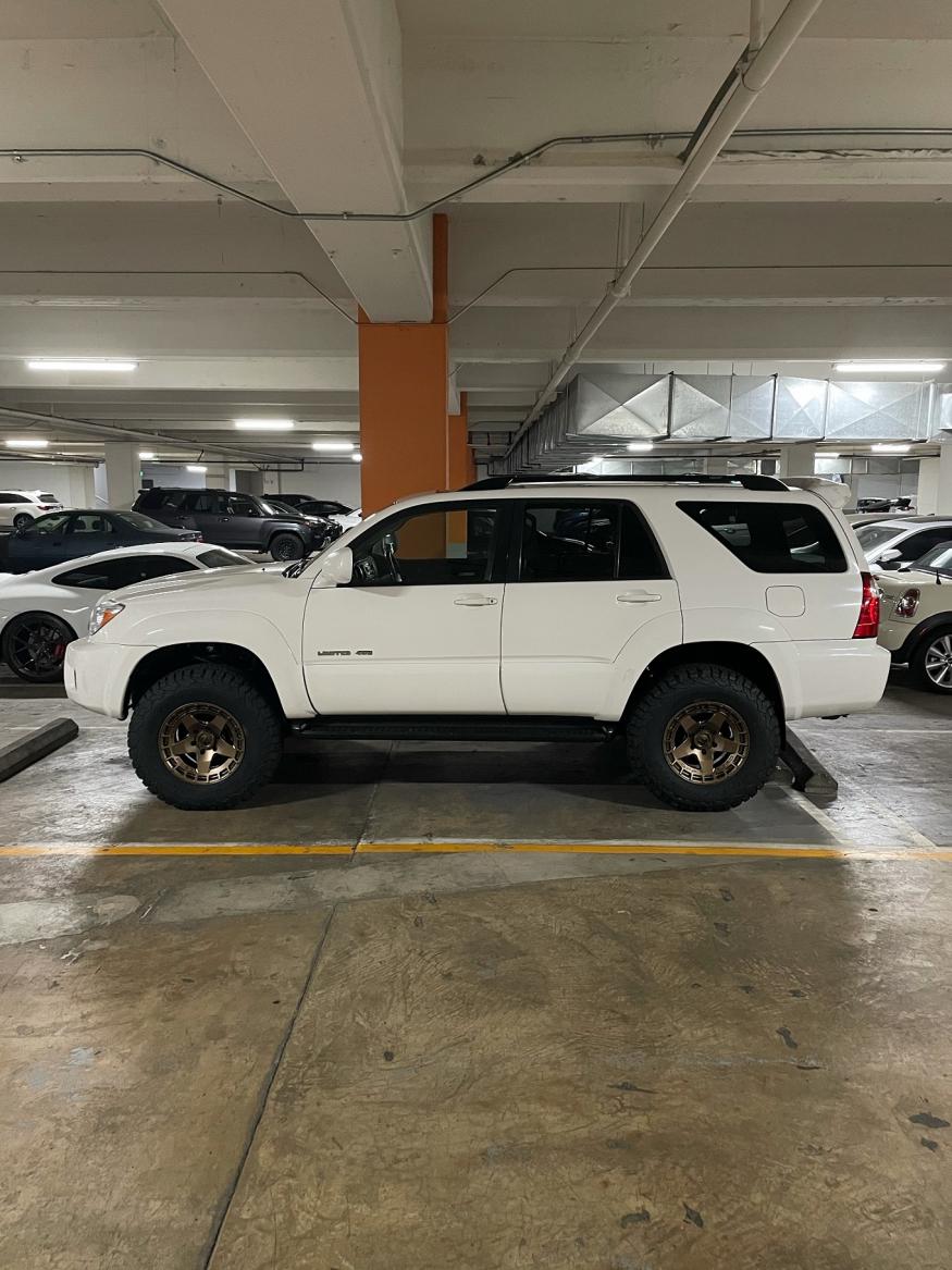

Just saying hello, I am new here and purchased her last Thursday and lifted on Tuesday with
-Fox 2.0's
-OME rear springs
-camburg monoball upper control arms
-Fuel Warp 17"s
-BFG KO 2's in 285/70/17
I had multiple 3rd gens in high school and college and have mostly been into German Sports cars. (my 911 in the background)
Been hunting for a V8 4th gen 4x4 forever, they are so expensive and tough to find during covid.
Can't wait to absorb all the knowledge on this forum.

Your rake looks level. Which OME rear and how much inch did you gain at the rear?
