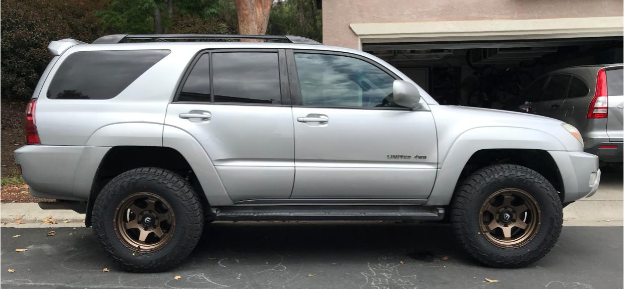

I have the Dobinsons in the boxes and am awaiting my install...296/599s with IMS...fronts set for about 1.25" lift (8.5" on the adjustment)...do you have any rubbing with the 265/70 R17s? I'm wondering if I have to stick with stock size or can up the diameter a bit....I want to go with Cooper AT3 4Ss...and they are only about 8/10ths of an inch larger than stock.
Thank you!
Much appreciated! The Dobinson's ride is stellar and I'm really enjoying it after around 6k miles. As far as rubbing, my Revo3s never touch anything, UNLESS I'm full lock in reverse going left. I get a pretty aggressive rub on the passenger fender liner, but nothing that cant be fixed with a little trimming, or just moving the liner forward a bit. Hope this helps! Sorry for the late response.

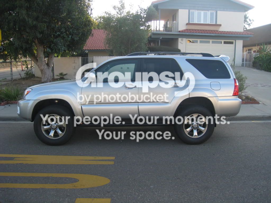

Updated pics after a long drive.

LOVE this look. Do you remember what lift and tire size you were running?

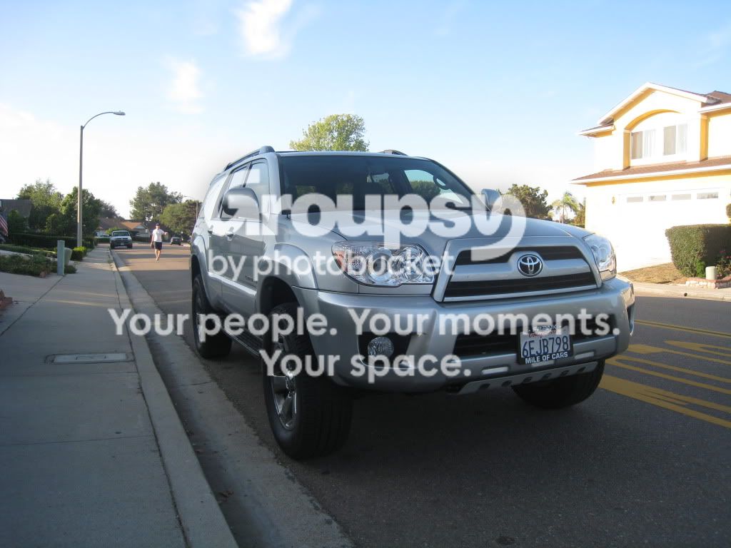

Take a look at all this rake. Decided it would be easier to install the rear setup first and do the front next weekend.
Wheels - Trail Edition
Tires - 265/65/17 Coopers
Front - stock and sagging
Rear - Bilstein 5160 shocks and Icon 2” coils
The fronts going to be getting Bilstein 6112 with 650lb springs and Total Chaos UCAs
Installed the rest today and really happy with how my lift turned out. Still need to get it aligned but hoping it settles a bit more. Sitting at just around 23” hub to fender at all 4 corners +/- 1/8”.
Front - Bilstein 6112 w/ 650lb coil
Rear - Bilstein 5160 and Icon 2” spring
Wheels - Early Trail Edition (+15 offset)
Tires - 265/65/17 (stock size)

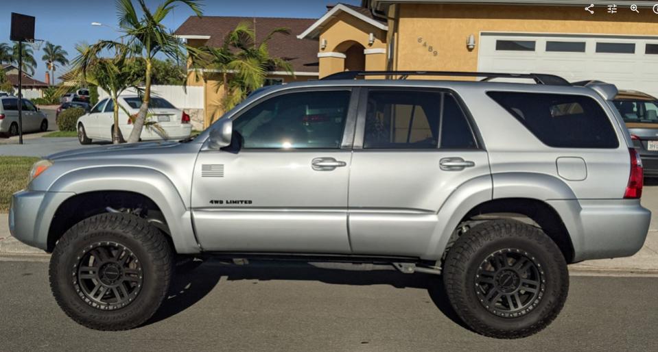

Just converted from the Cornfed 1" Front Leveling Kit with stock Limited tires (265/60/18) to the Cornfed 3/2 Lift. Spidertrax wheel spacers, Michelin LTX A/T2 275/65/18 with XREAS preserved. There was no rubbing with these tires until I got the front end aligned. Now I've got a slight rub at the rear of the tire on the frame when cranked all the way. This weekend I'm going to try to adjust the camber a bit to move the wheel forward just a bit. If that works I'll be in heaven as I love the way it looks and drives. If that doesn't work, I am not sure what I will do. I cannot live with the tires rubbing since my son and I do some light offroading.

12 Years Later!
