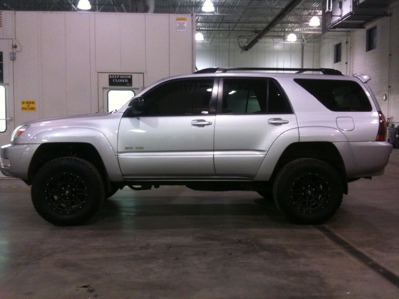

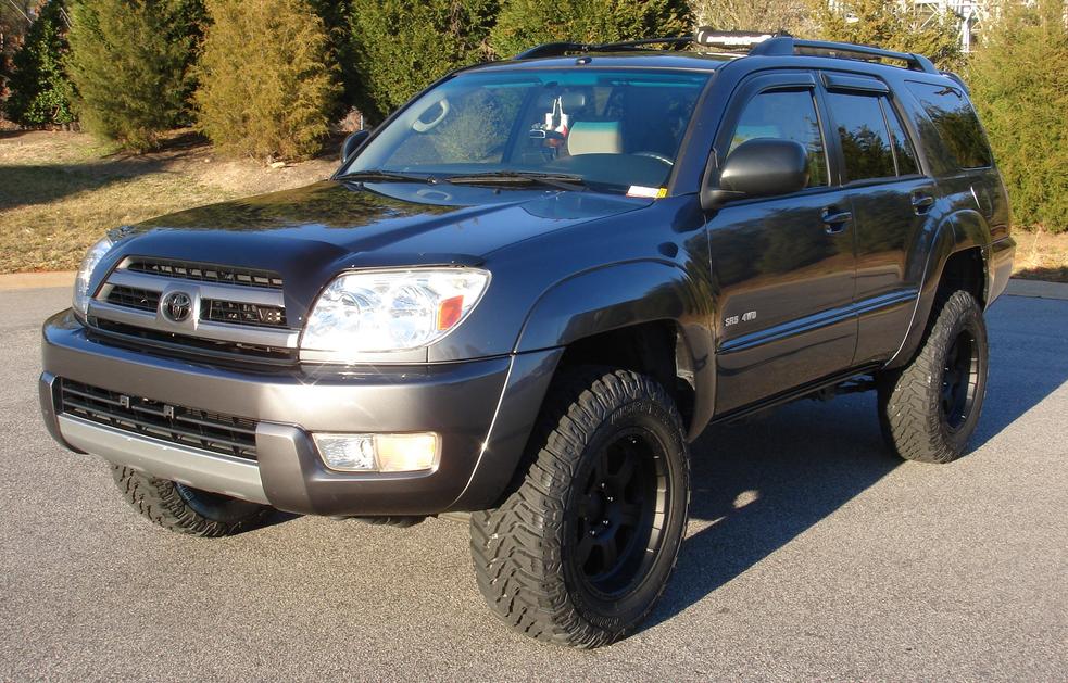

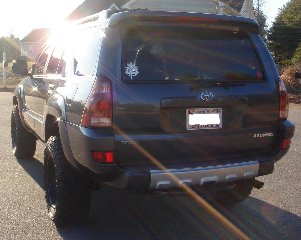

I just got my T4R outfitted with Cooper STT's 275/65/18's, Pro Comp Flat Black 7089, Cornfed 3/2, Magnaflow Catback, and K&N CAI. Currently working on blacking out all emblems. As you can see the front grill is done. I had all my work done by Nick at 4 Wheel Parts in Raleigh, NC. They were very professional and knew exactly what they were doing.

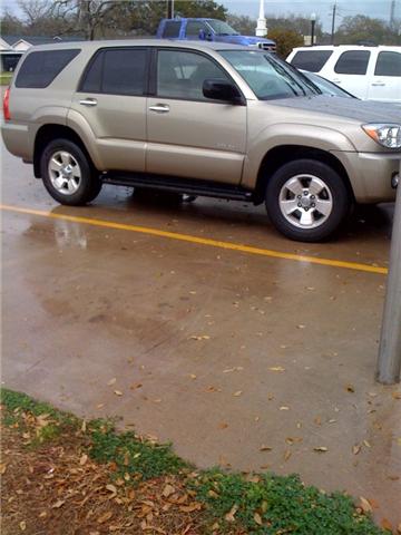

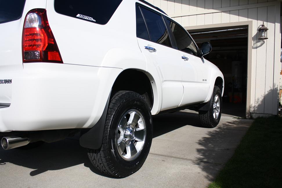

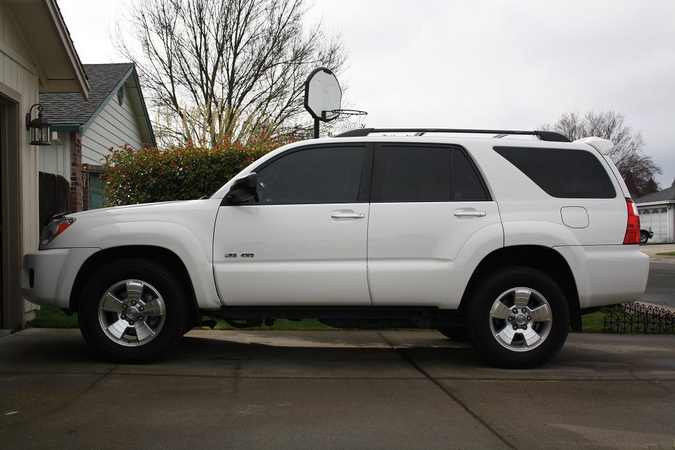

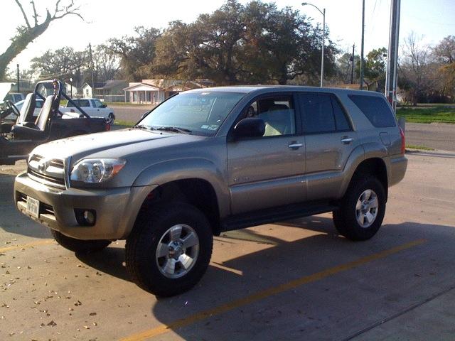

Before/after Toytec 3" ultimate + 1" body with 285/70/17s
This is my 07 SR5 4Runner before and after photos. I opted for Firestone Destination ATs since this is my drive to work vehicle and most of my time is spent in 15 MPH traffic. They are 285 70 17s.
We are planning a trip in the 4Runner this summer, so road noise during that was a concern for tire choice. These tires are amazingly silent, but still have a nice tread pattern. I'll get 4 more when I wear these out. Love em.
The lift is a 3" Toytec Ultimate with the additional 1" body kit. I have Spidertrax spacers as well. I love the lift. After some light plastic trimming I have zero rubbing short of full flex. It rides smooth, handles fine, as is not too stiff or too bouncy. I believe it is right where it should be and I am an extremely happy customer!
I did not install it myself. A shop in Clute, TX did it for me and they treated me right.

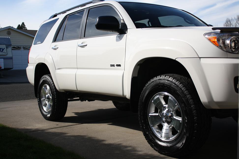

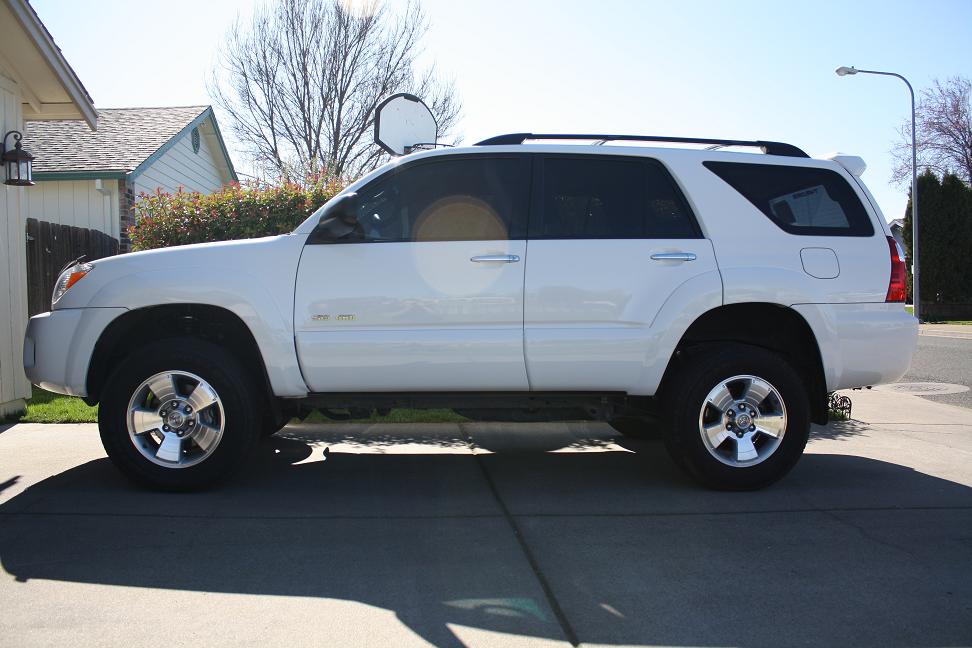

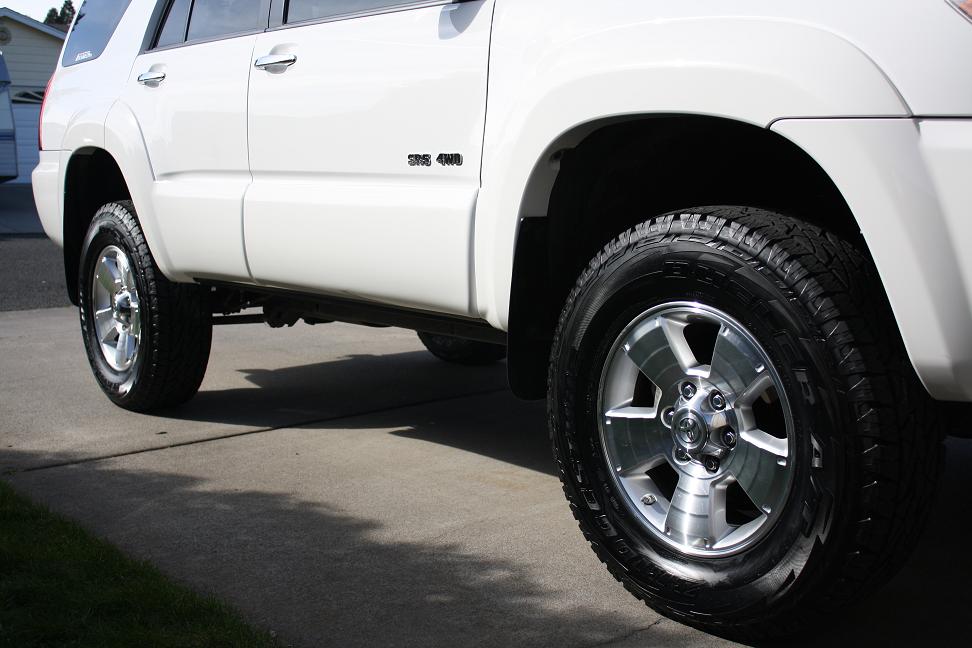

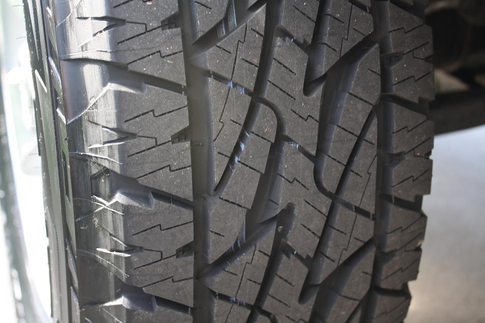

Lift and Tires= OME 884 springs with Toytec 1/2" spacer up front, Nitrocharger Sport shocks, and Toytec Superflex coils on the rear. Just put the tires on which are Bridestone Revo2's 265 70 17's. Just need the sway bar relocate and Ill be good to go. Just a bit of rubbing on the sway bar and spring perch. People keep telling me it shouldnt rub, but let me tell you it does, and it is installed correctly.

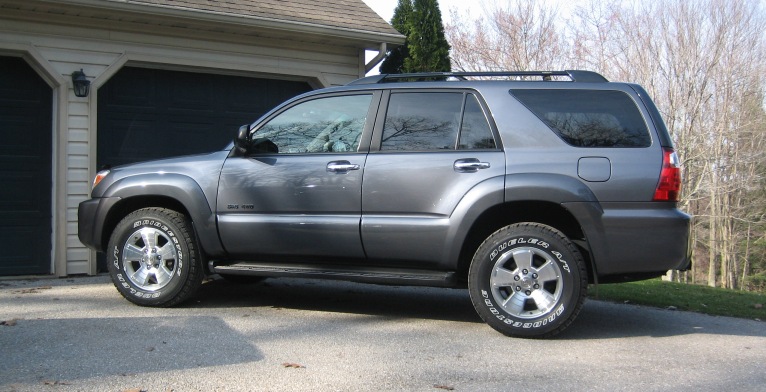

Revo 2's mounted today!
Hey Guys,
Just got my 265/65/17 Revo 2's mounted on my SR5. Opted to go white letters out...don't see many of them showing letters. Let me know what you think!

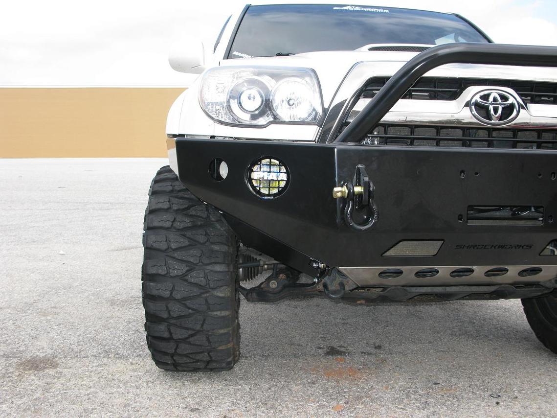

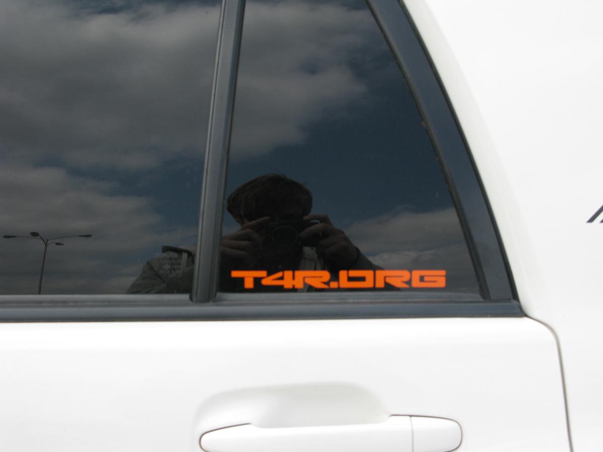

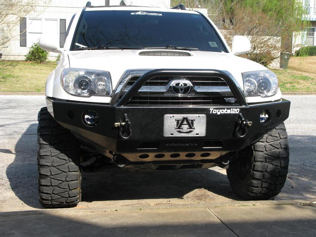

Shrockworks Bumper
Some pics of the bumper on, as well as the t4R.org sticker
