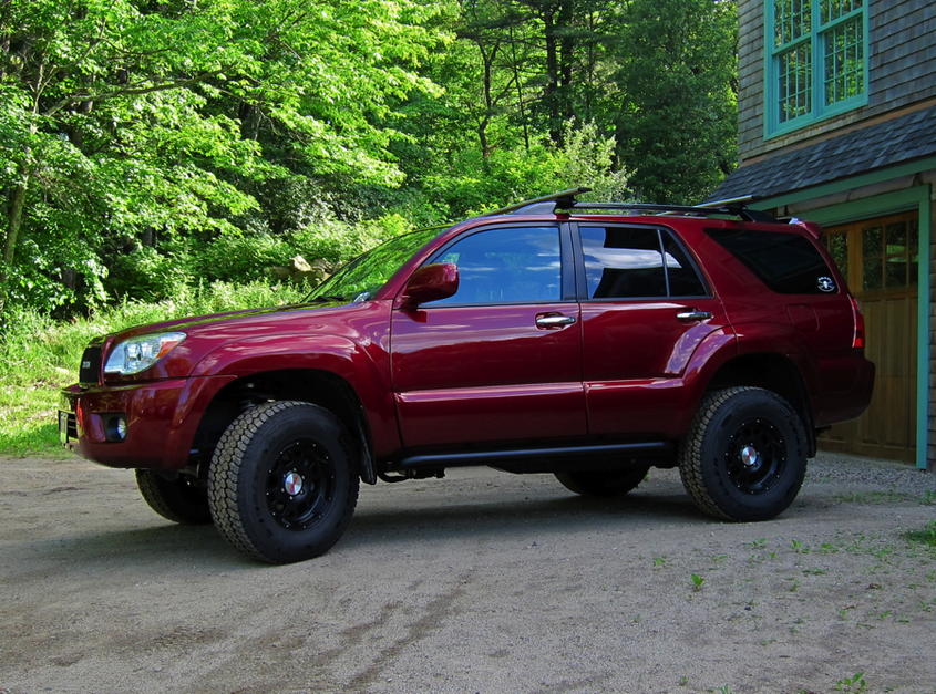

Oops. It has been a while.
Daystar 2.5" , KMC Monster 18"wheels, Nitto TG 285/60/18
Enjoy
Nice looking ride!
I am thinking of doing the daystar lift with spider traxx and 275 65 18
or the 265 70 18. I dont want to have to deal with rubbing and trimming. But I like the look of yours with the 285 55.
Cheers
Nice looking ride!
Cheers
275s will rub with just daystar. will have to move inner fender liner forward and remove front mud flaps no doubt. Not sure what else though... I have the daystar and spidertrax as well as another inch of lift from FJ coils, and i had to do a very minor trim of right side of inner bumper plastic as well as 2 things above.

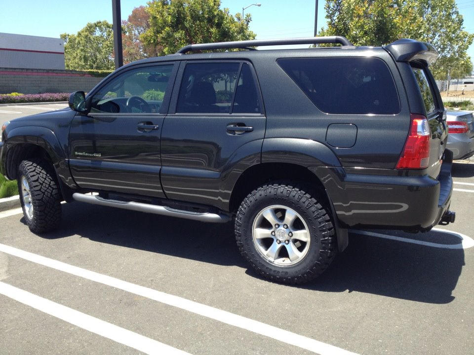

just a quick iphone pix.. freshly installed fj springs/daystar & 265/70 duratracs....
gorgeous kilroy, just gorgeous.
what do you have your ow set at in the front? just 2" from the coils in the rear?
im trying to stay with 16's for budget purposes as thats what i have factory but i cant find a tire size that looks to fill the wheel well enough with a 3/2 lift.
Hey, Thanks very much !
the fronts are set all the way up for lowest amount of lift right now. I expect I will need to adjust when bumper added. Wheel well height change: 34 --> 36.5
The rear is the other 1/2 of the OW 2.5 outfit with a wheel well height change: 36 --> 38.5
The ride is really tight, very flat in the corners; it just feels really good.
Once I got the new sway bar end links on I had to go for a quick test run.
