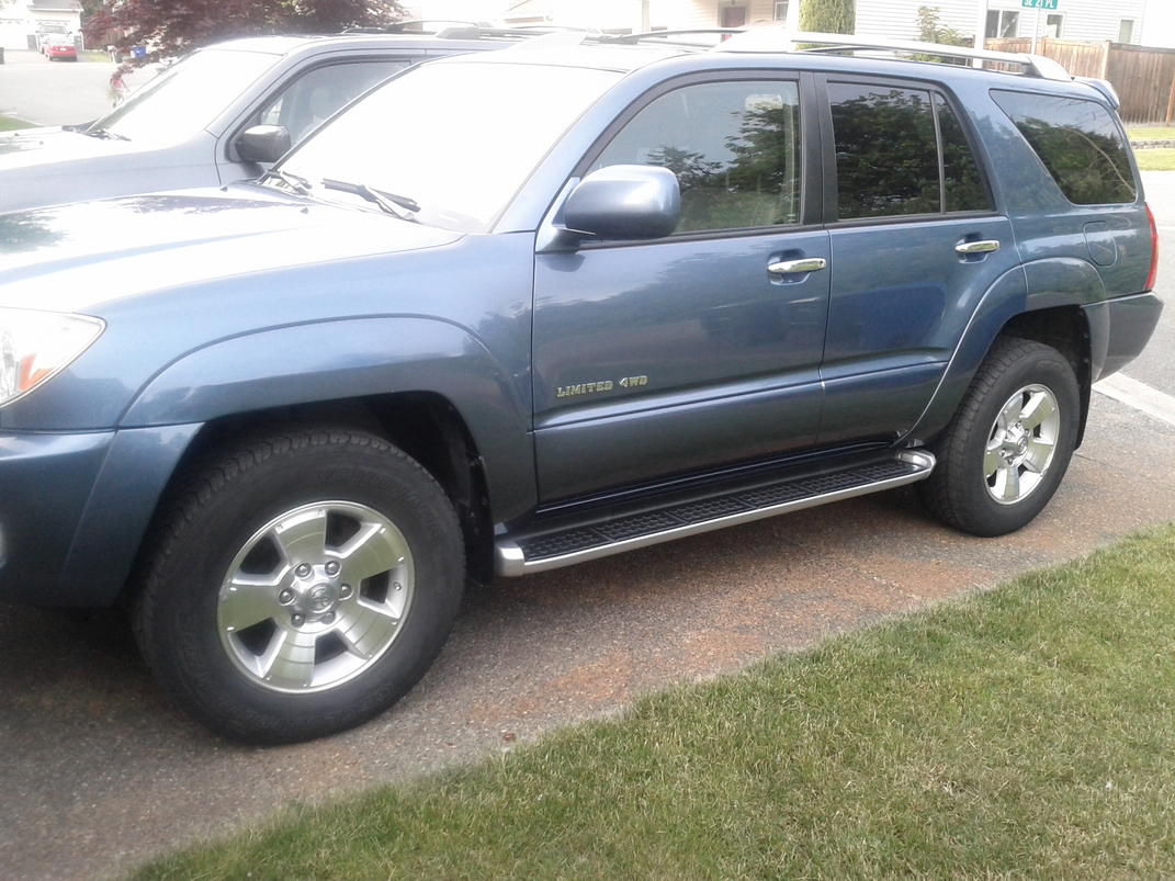

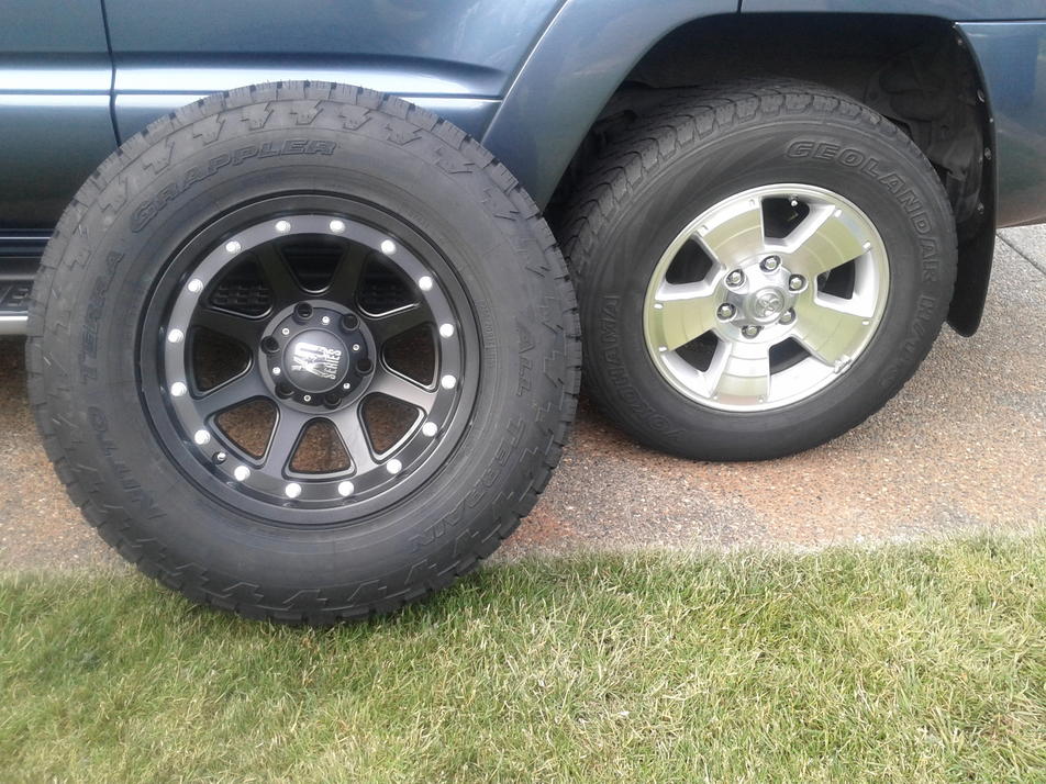

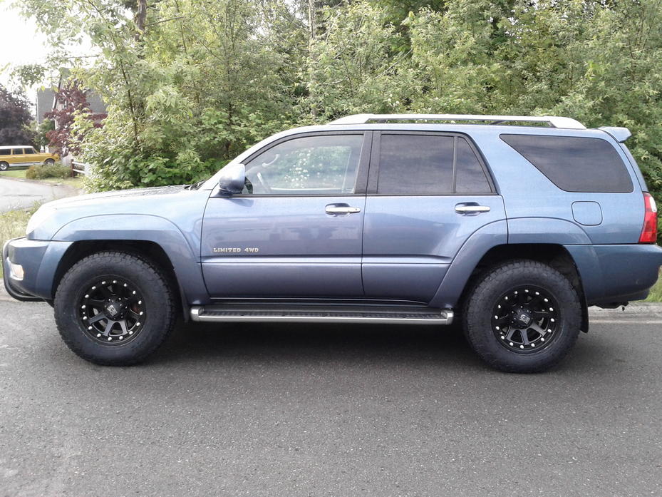

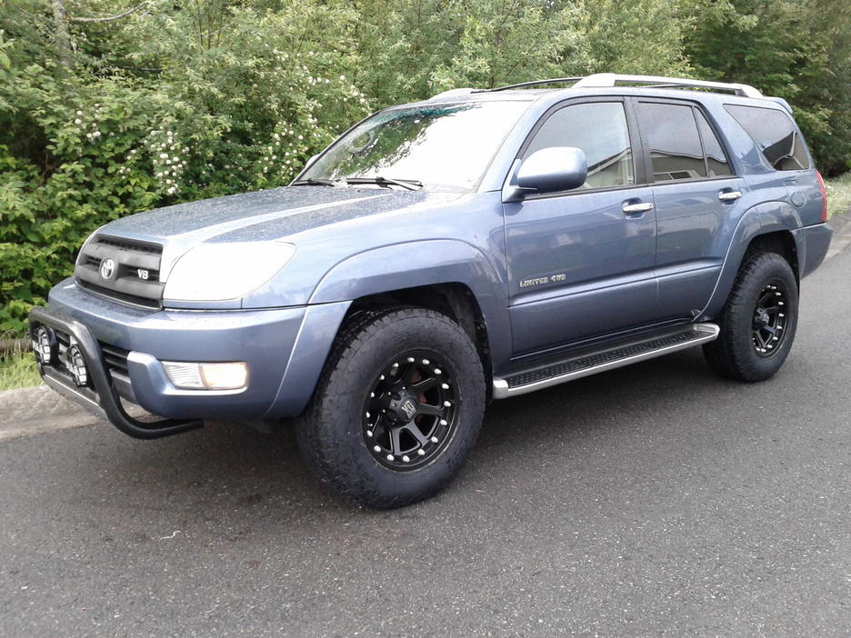

Replaced the stock wheel/ and spidertraxx spacer with the new setup.
Before -and after
XD798 matte black 17" Nitto TG AT 265/70/17
right now, rubs like heck turning.
Getting a daystar leveling kit - hope that helps with the rub.

Looks great, wheels look very similar. Maybe they rub because offset is too low? I have 17x8 with 12mm offset, and same size duratracs, no rubbing at all
Those wheels and tires look great. The rubbing is probably a result of the slightly larger tire and wheel offset. What offset did you get, the -12mm or the +18mm? I am guessing the -12mm. I wouldn't have thought the +18's would rub with that size tire. I think the stock wheels with Spidertrax are an equivalent -1.7mm offset. The lift will help, you might still need to do some trimming on the front fender area. Lift it and see.:thumb3:
