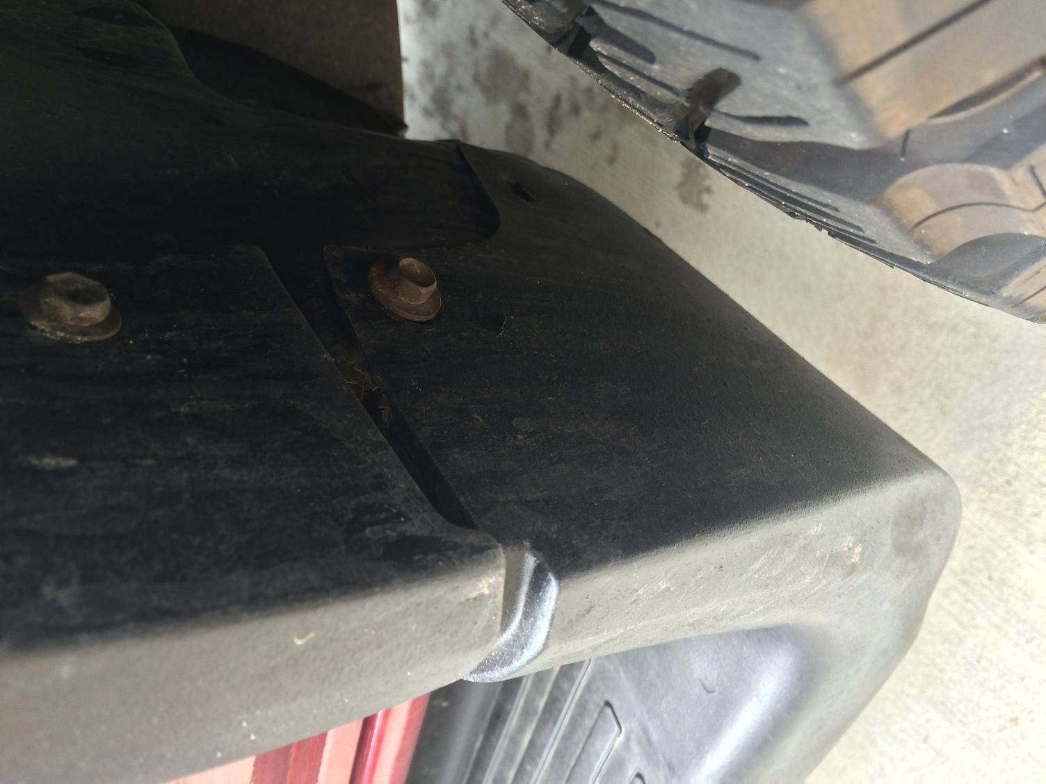

Now i'm getting a terrible rub on the lower backside of the fender. It is where the transition piece bolts from the fender to the running boards. I am curious what the best solution to this is. I've considered 3 options. The three options i've considered are...
Body Lift, Moving my shocks up a perch, trimming the plastic.
If I did a body lift, would that solve the problem? I'm not certain that it would because the transition piece bolting the two items together would still be in the same relative location to the wheel during its length of travel. If I did one it would be between a 1/2" and a 1", nothing bigger. I already just barley clip my garage door when pulling in, so if I did anything I would have to air down to get into it.
I think the best chance of success (other than trimming plastic) to prevent this would be to raise which perch i'm on with the shocks. This would raise the wheels natural travel pattern (during normal driving) in relation to the plastic, but would this be enough?
I think the best chance of preventing it would be to just trim the plastic/take the plastic piece off. This is the least attractive option in my opinion, just because i'd rather not.
Anyways, looking for some other input from those who have gone through this and solved their issues.

Mine is a 1 1/2" (planning on 35s someday). Post a pic where its rubbing.
So I assume that this piece is screwed into the body, and therefore when you do a BL it would lift this, but the running boards are mounted to the frame, which would mean this piece wouldn't line up once you've done a body lift. How do folks deal with this once they've done a body lift? Or do they just take off the transition piece? In which case, i should just remove it now and save the money on the BL.....

If it's just a minor rub, I would just trim it slightly. Or remove it altogether and see if it still rubs. If so, then trimming it wouldn't matter any.
