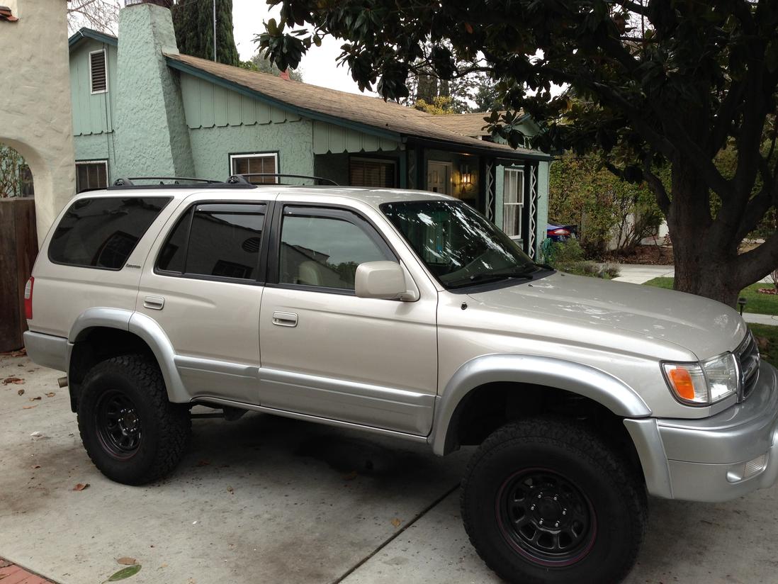

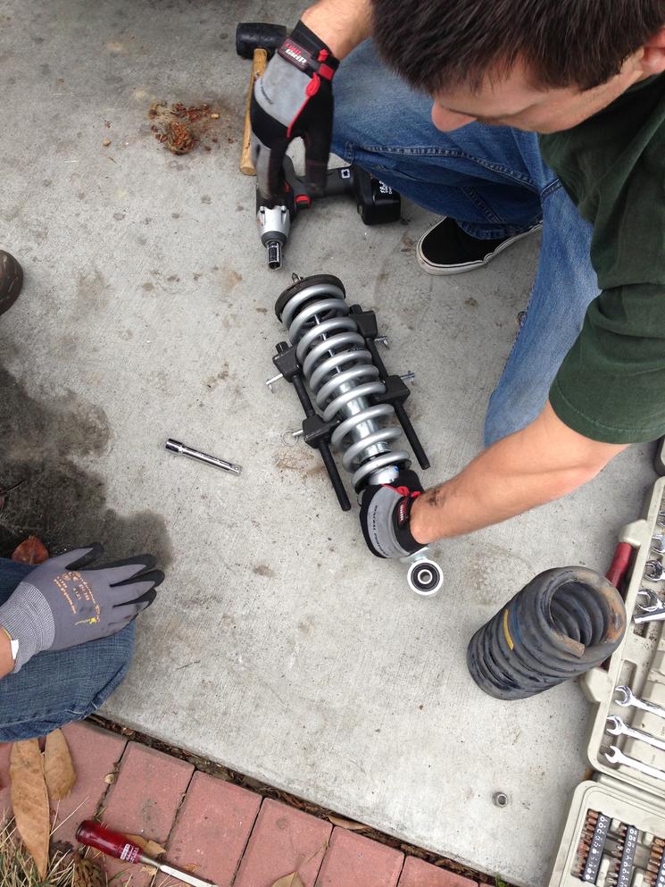

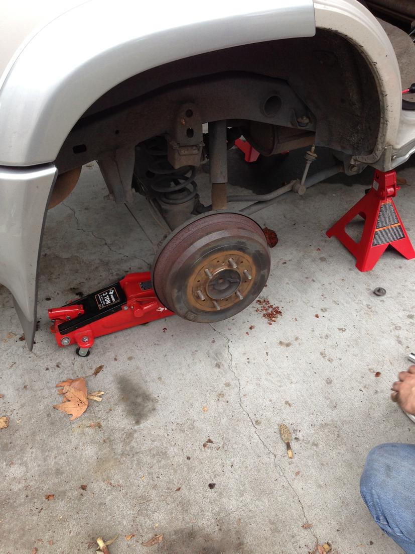

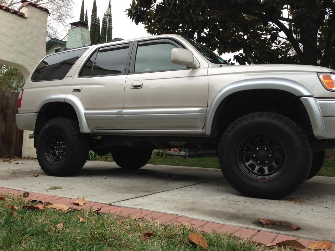

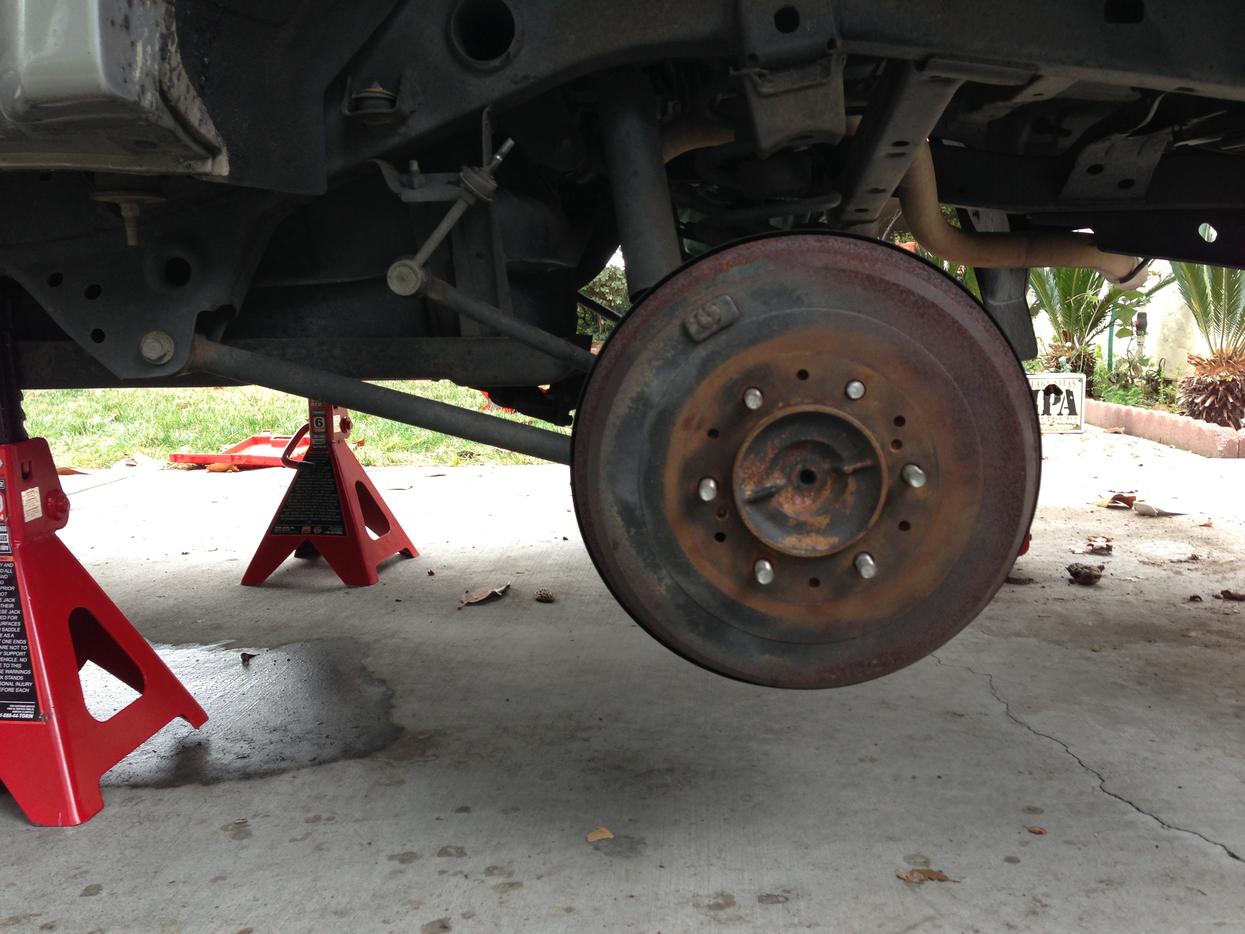

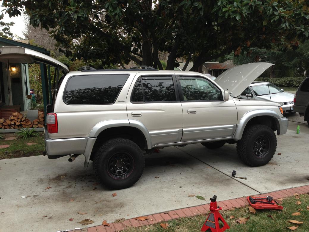

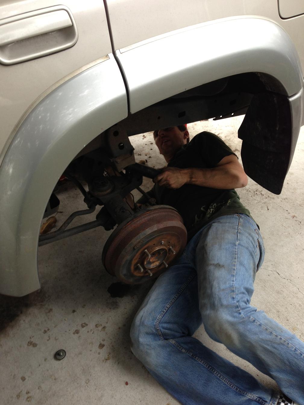

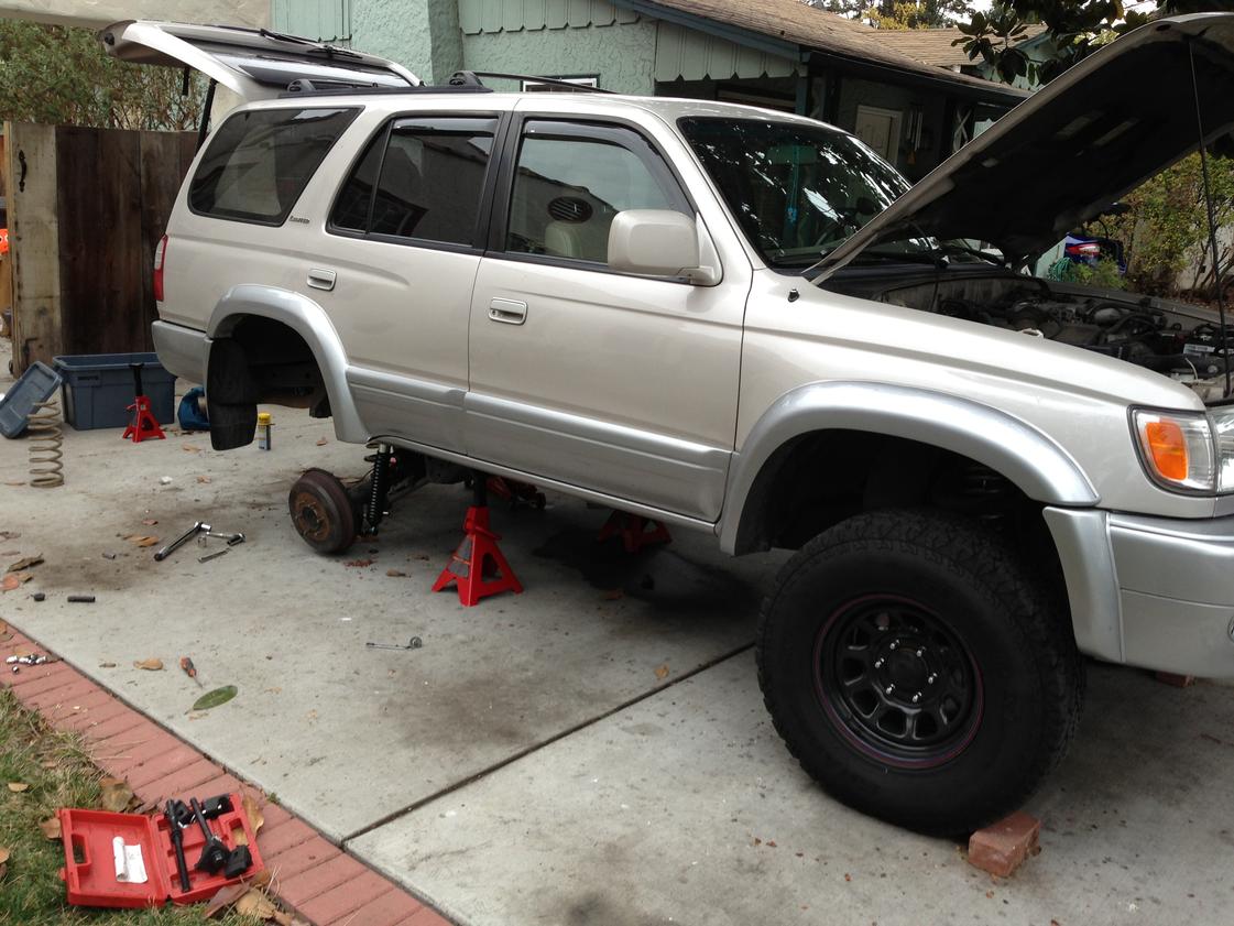

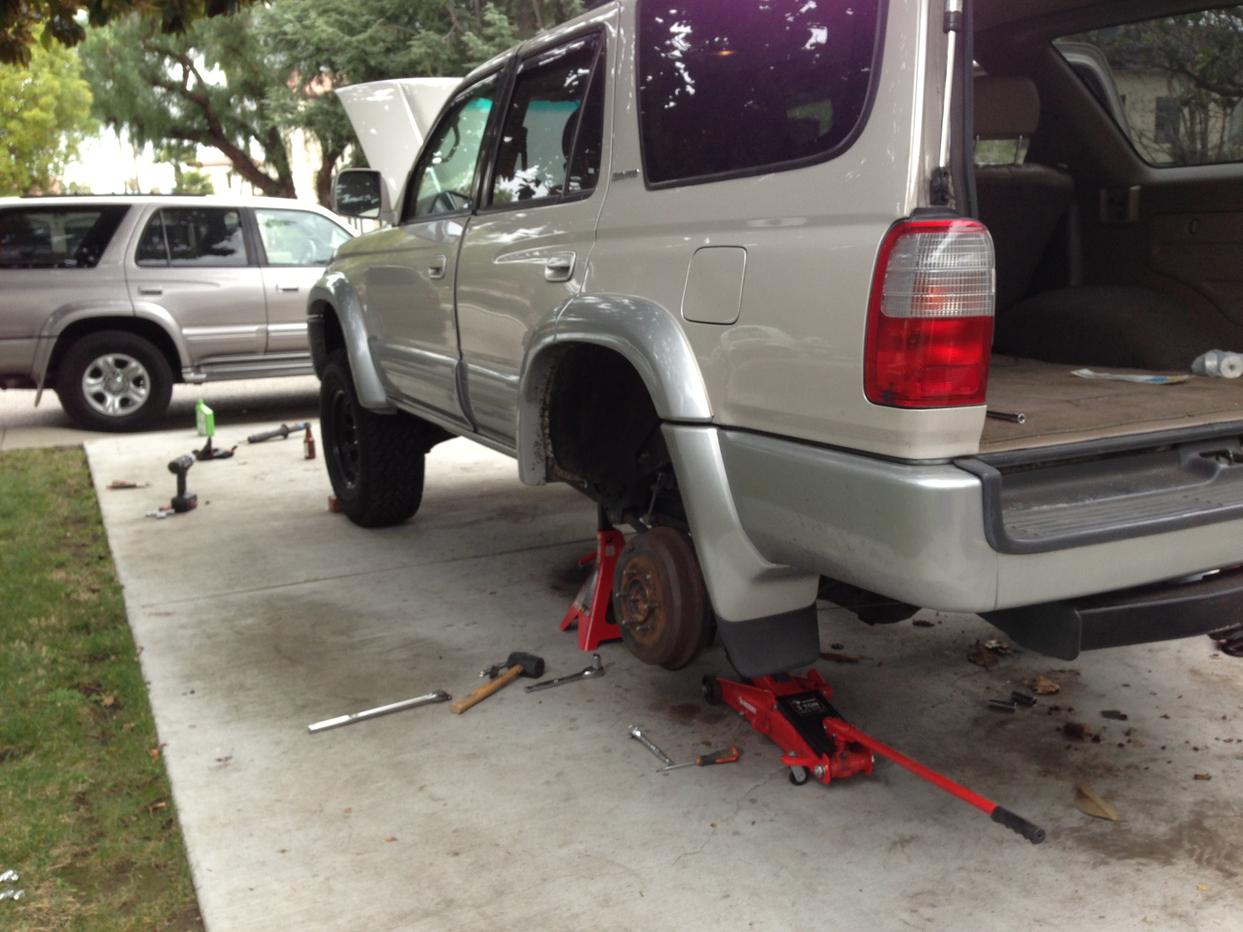

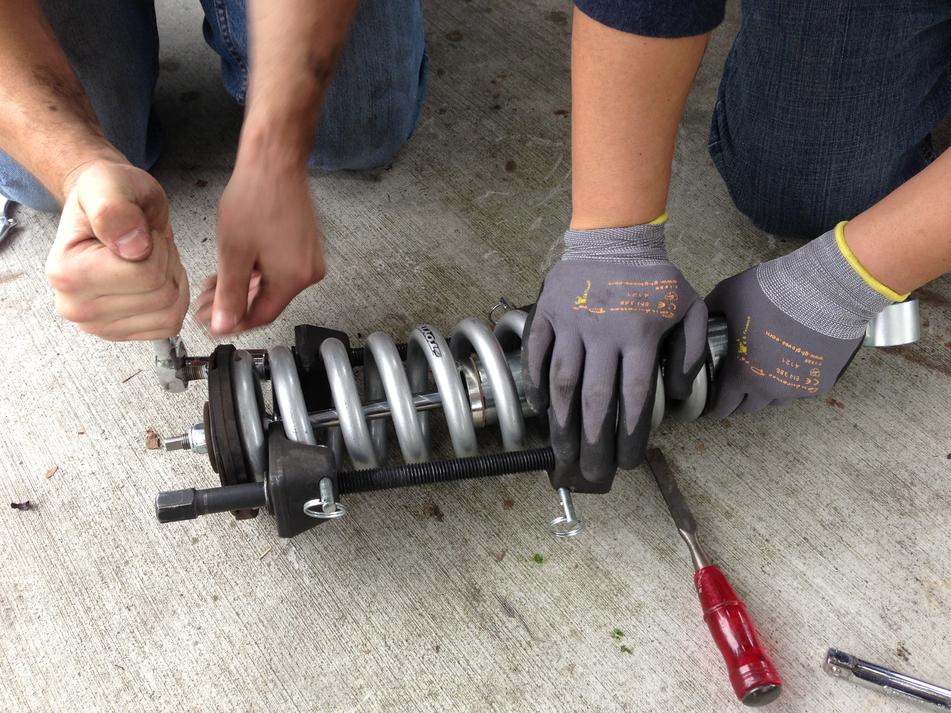

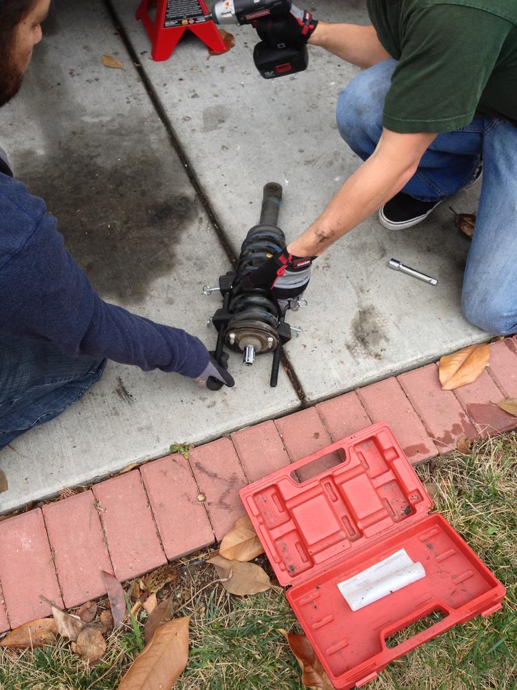

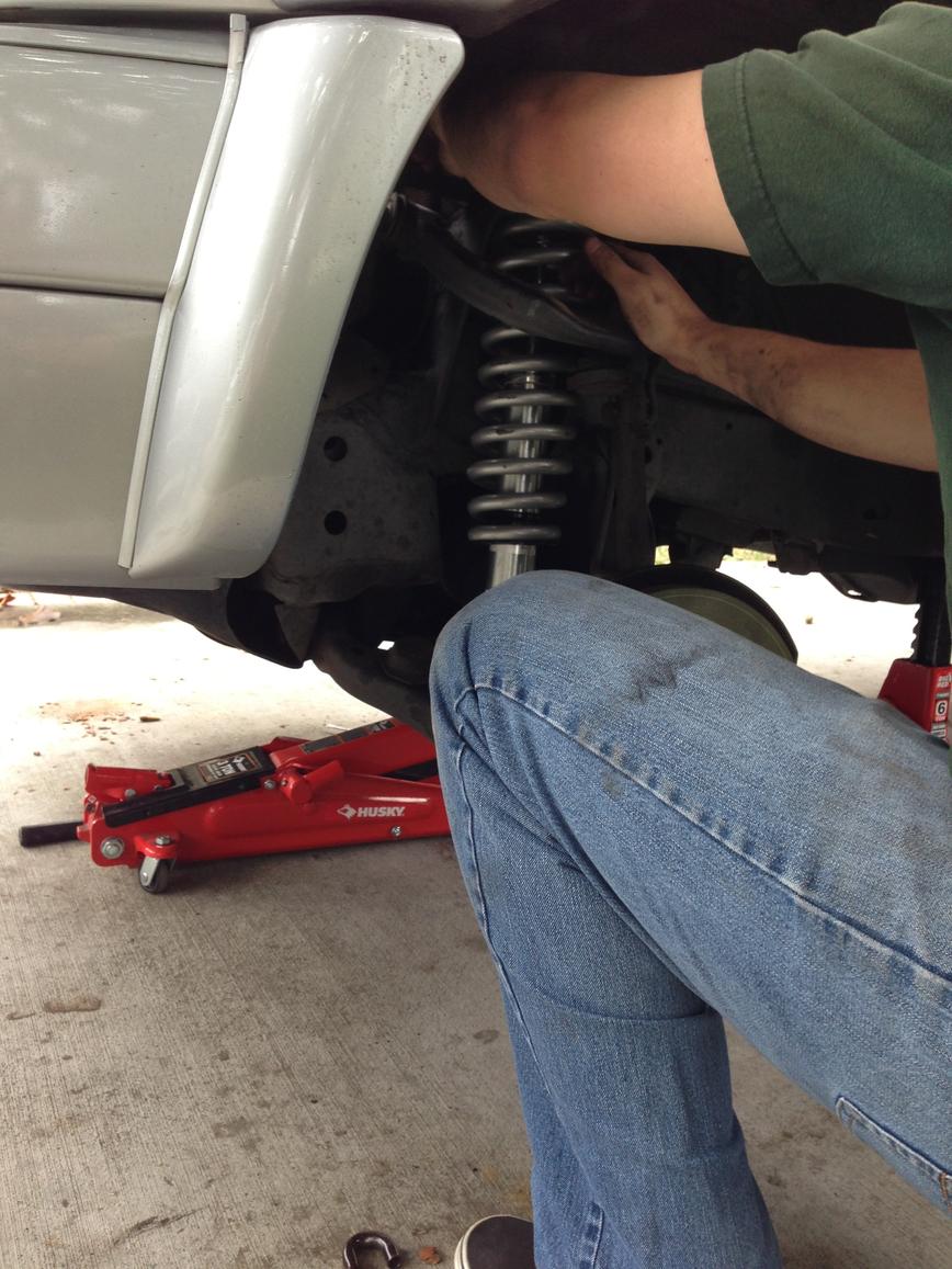

Good times were had and 1 more 3rd gen got a nice lift
Huge shoutout to [MENTION=53337]SCRunner12[/MENTION] for his skills

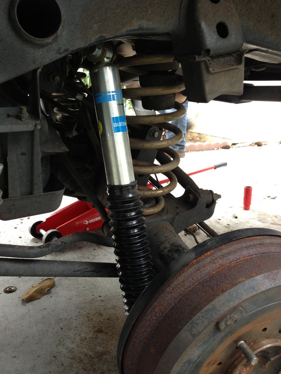

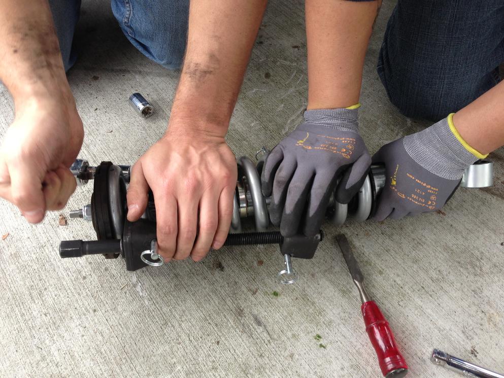

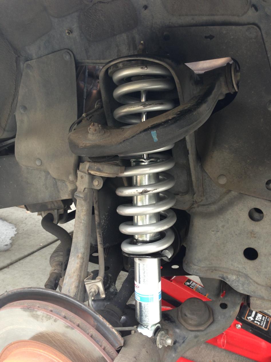

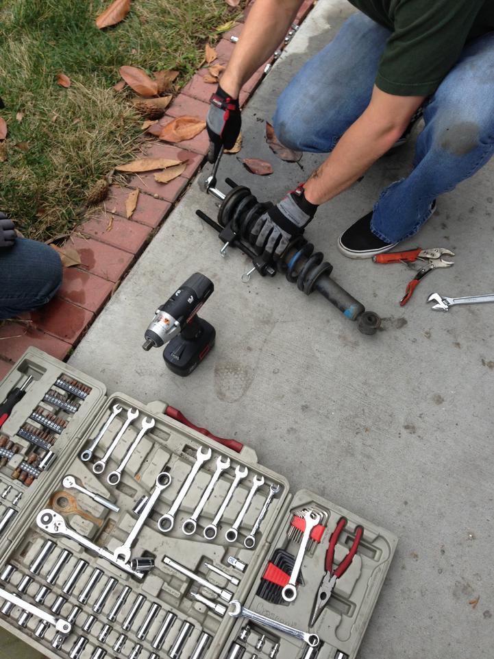

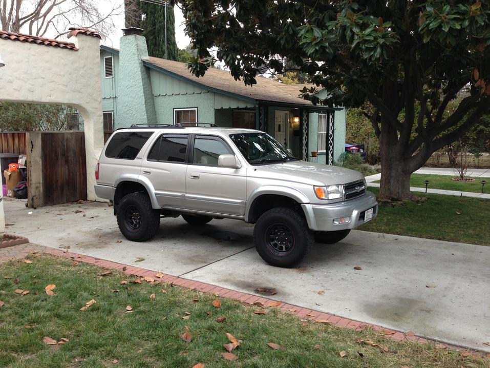

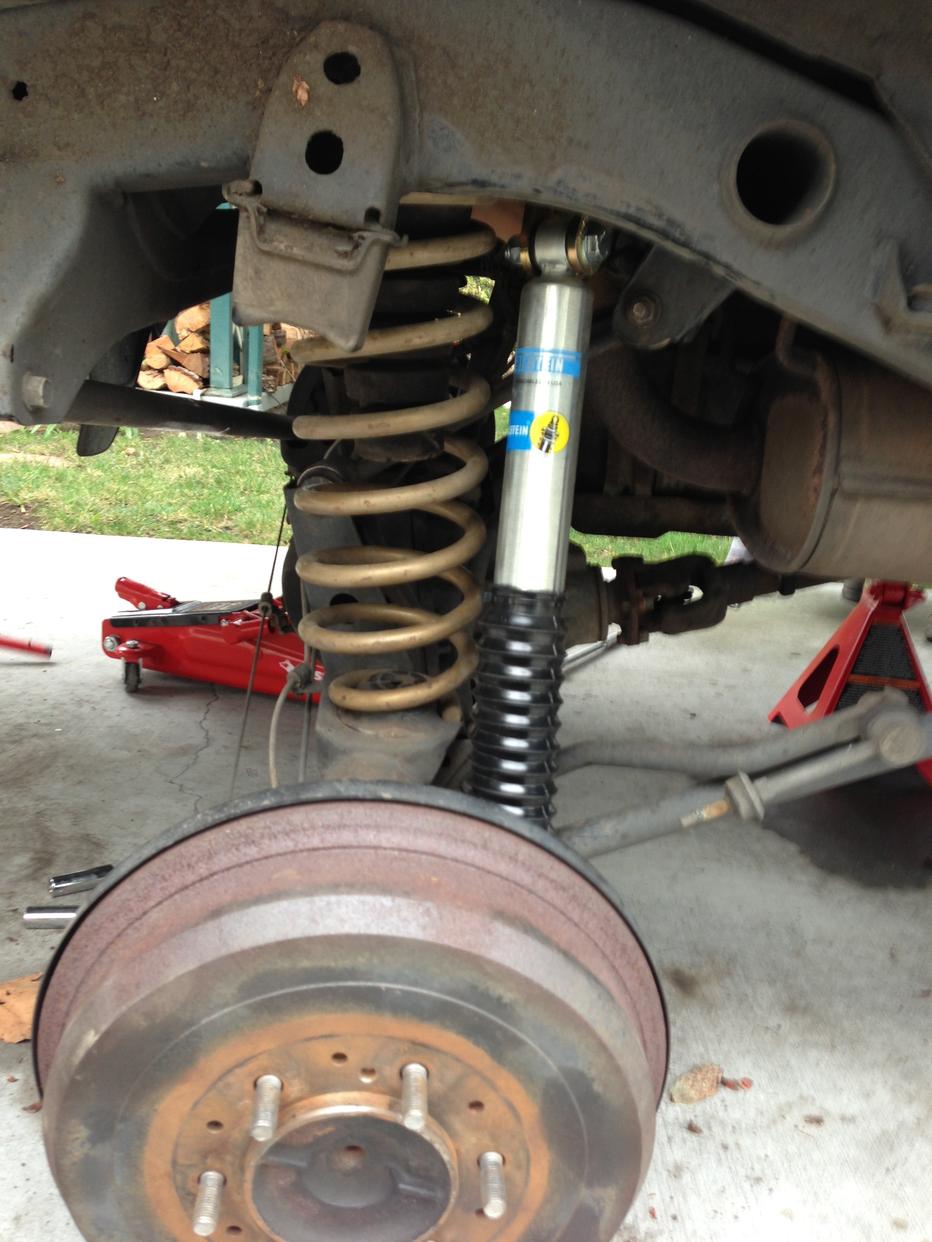

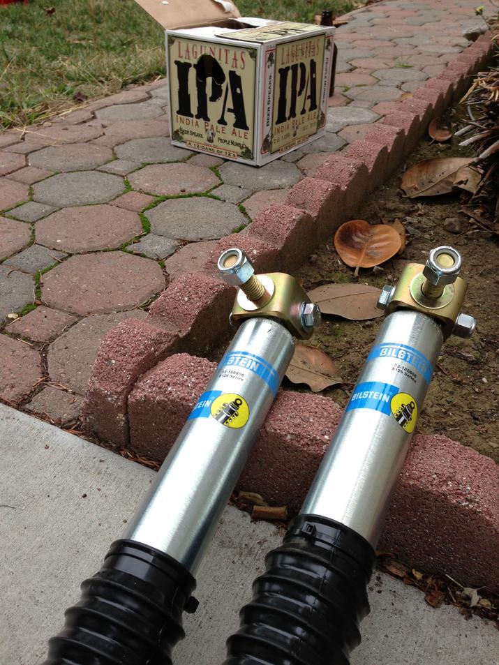

More pics from the day

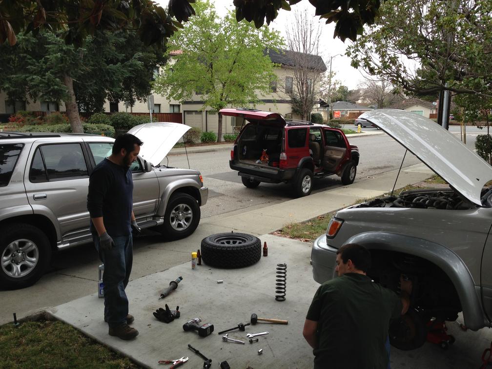

pics
Damn! Looks great guys! Sorry I missed it..pretty bummed actually. Just didn't have the funds to make it this weekend. :-/ But looks like it went well. Awesome seeing the runners parked there also. Like an Toy invasion. lol

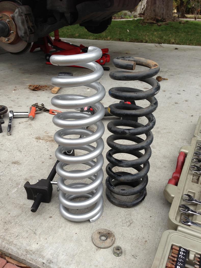

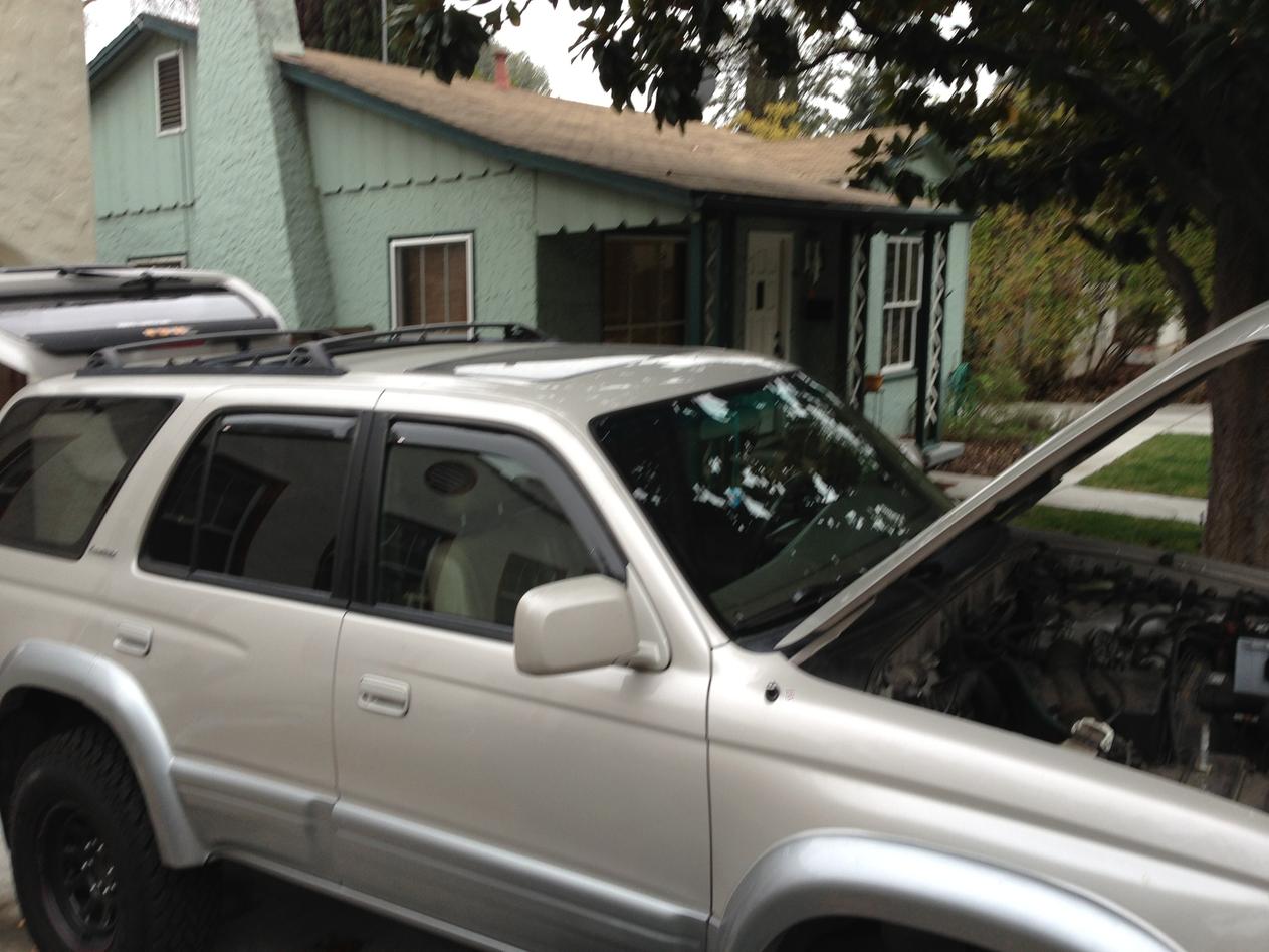

Thanks! It was a good time and went pretty smooth considering we had to use compressors and the rear shocks came off relatively easy with some bending persuasion...
Only took us about 4 hours so probably not worth all the driving time, but we will set something up real soon. I might have some mods that I'll need help with, so it would be sweet to meet up with everyone.
looks good!

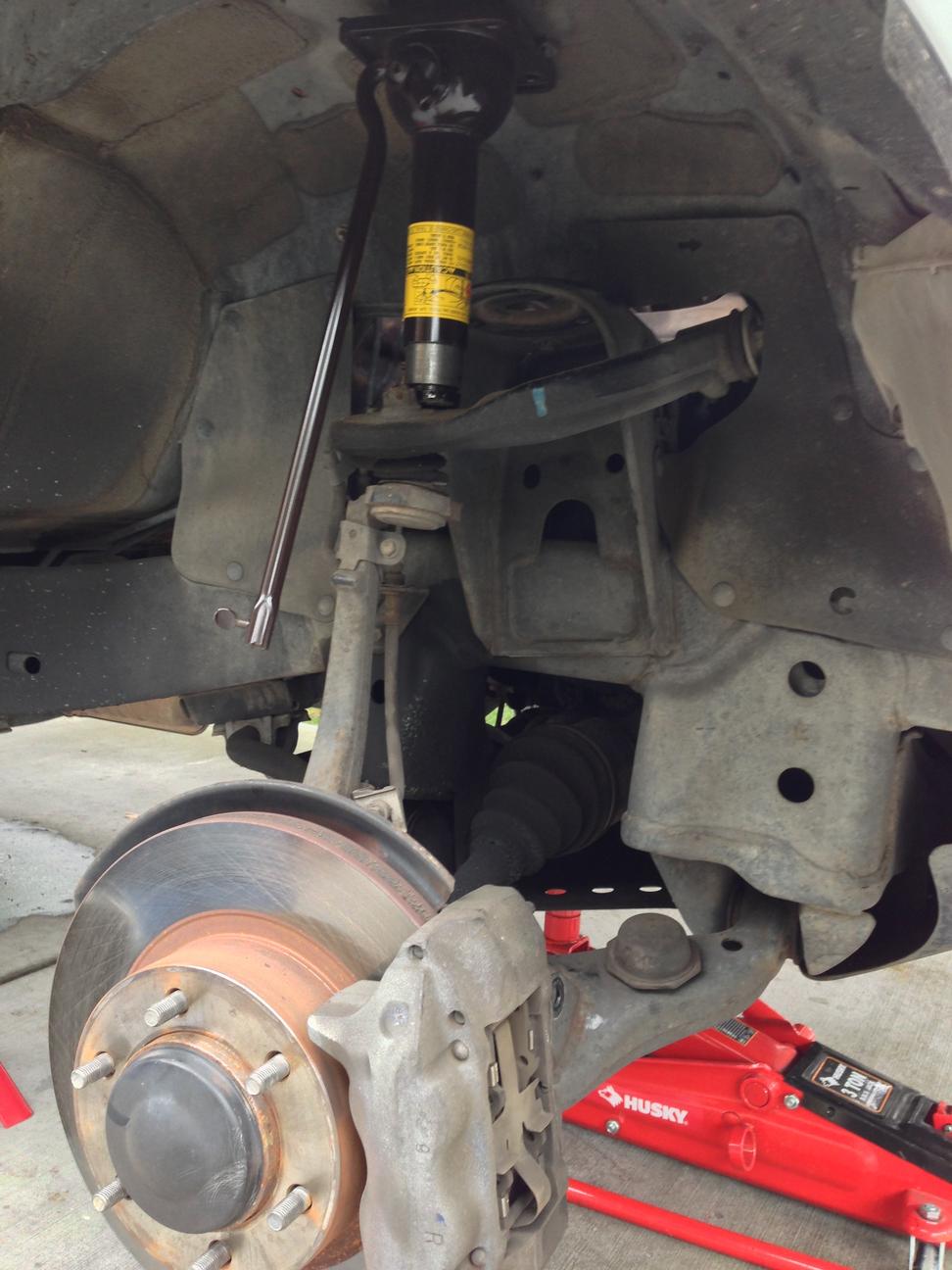

diff drop?
how do the CVs look now?
As infamous said, no diff drop. I didn't even think about it till we were cleaning up and I had to get going. I may stop by at some point and help him put it on, but he should be fine. I've been running my lift for 2 years now and never put a diff drop on with no adverse effects. Just one torn boot that happens to people with diff drops.
I didn't even think to look at the CV's, but I'm sure they are fine.
Thanks Infamous for posting those pictures, they really captures the day. I had a blast and was totally beat after we were done. You're up next, so let me know when you get your lift and we'll set something up. Just as long as you don't have 5125's or need compressors....haha

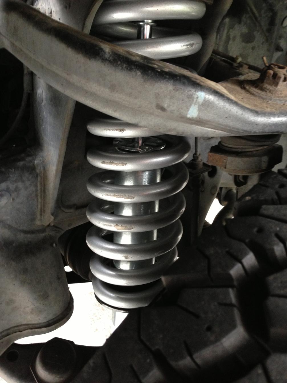

BTW, in case anyone was wondering his lift is Eibachs/Taco 5100's up front and my old Downey coils with 5125's in the back. He's running 265/75/16 General AT2's as well. It came out awesome and looks sweet with a little bit of rake.
