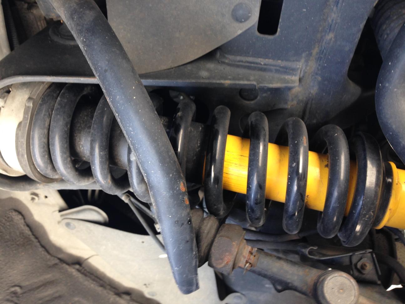

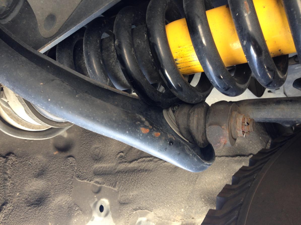

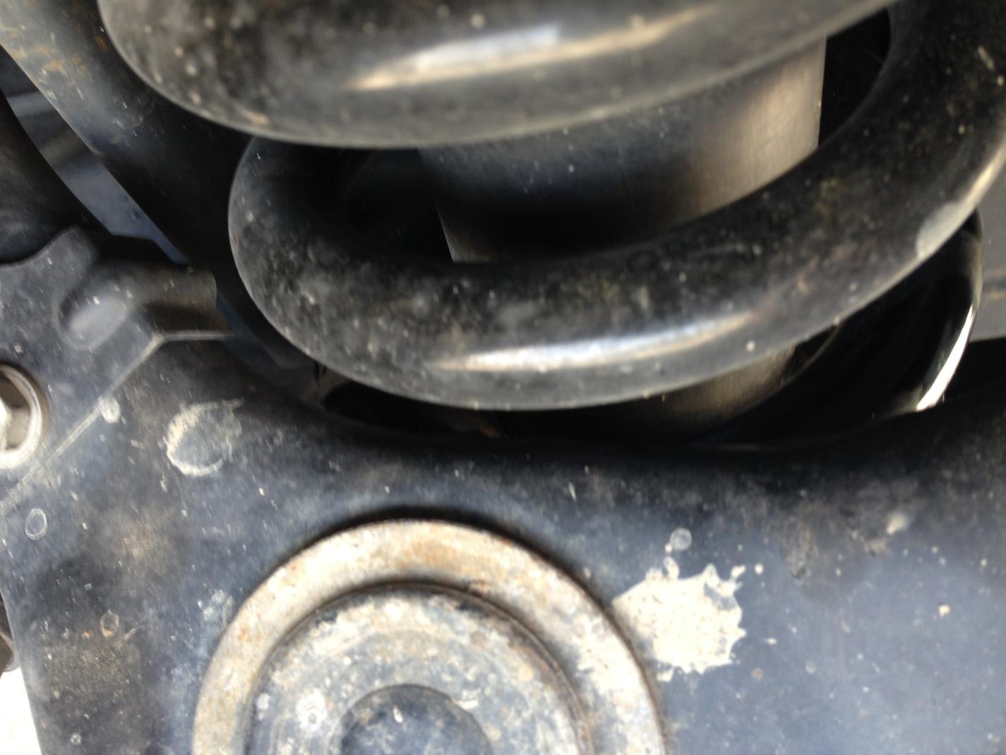

I put the Cornfed 3 in the front 2 in the rear on my 05 4runner. I bought new wheels and tires and after installing them I had some rub issues. I decided to go ahead and replace my springs with the OME full upgrade. This gave me the tire clearance I needed but now I am having rubbing issues with my upper control arm and the new spring. I called a company about upgrading my UCAs and I was told that it wouldn't not help my situation and that I needed to take some lift off. I have uploaded some photos so hopefully I could get some other opinions. I don't want to take my lift off if I can help it. It is hard for me to belive that a better UCA would not help me here. Thanks in advance!

Yeah thats what I have on there now. The OME is just new springs, the cornfed is a spacer
Holy CRAP!! yea you need to take those spacers out ASAP! you have 2.5-3" lift springs as well as a 3"net spacer. That's extremely dangerous. Are those pics taken with the tires on the ground?
Also you are going to have to have UCA's, you have a torn upper ball joint boot in one of those pics. Edit: maybe its not turn, just pulled off.
Either way, you are trying to run almost 6" of lift in a way that is not possible
Not to mention, running 4" in rear.
i would pull that spacer absolutely immediately. youre taxing your front IFS in a way it was never designed to handle
yes the tires are on the ground and i have my wheel turned all the way to the right, this is my front right tire
I wouldn't move it forward or backward. Lift it up and take Cornfed off! Once you are just with OME stuff. You can go higher by adding a body lift. You can get the 6" of lift you like, but it will take more work and $
Pictures before removing, I wanna see that thing, it's got to be jacked!
Also what size tires are you running?
