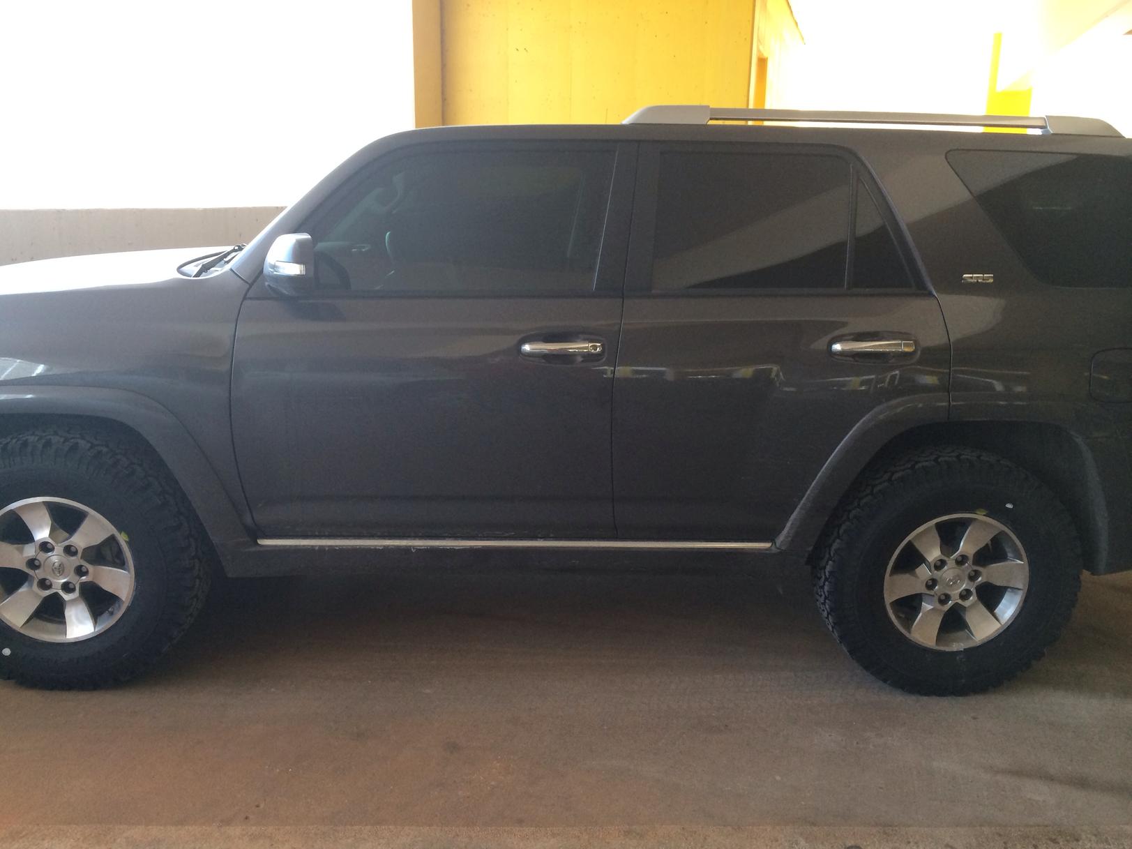

I'm having 285/70/17's BFG put on in about 4 hours. Lift goes on on Thursday.
I'll post pics.
I put 285/70/17 Duratrac's on my 2013 TE. Installed an Icon lift, took the rear mud-flaps off and had an enormous amount of rubbing. Got the body mounts trimmed as well as a LOT of plastic trimming. Continued to trim plastic periodically until most of the rubbing was gone. Eventually installed Icon UCA's so that I could have the caster adjusted, which finally did eliminate all rubbing (I think). I do wheel it regularly so any rubbing should show up where it might not otherwise do so if I was only driving it around town.
285/70/17 BFG TA KO - I got them installed today, no rubbing anywhere yet...
Couple things:
Load E is overkill for most go with D if given the chance.
My power loss is not near as bad as I thought it would be. Like I have really noticed any - but I live in Oklahoma and it's flat here.
They are just as quite as factory.
Feels much more secure to the road.
