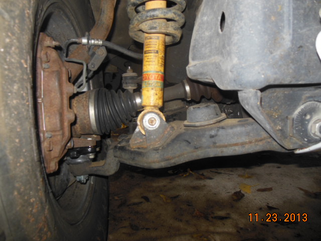

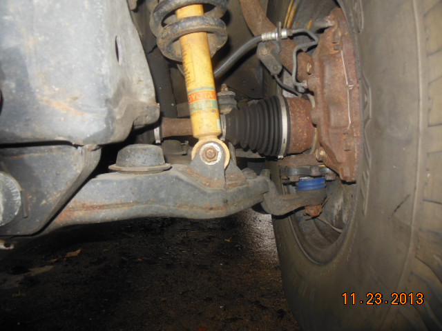

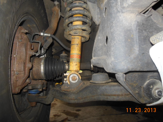

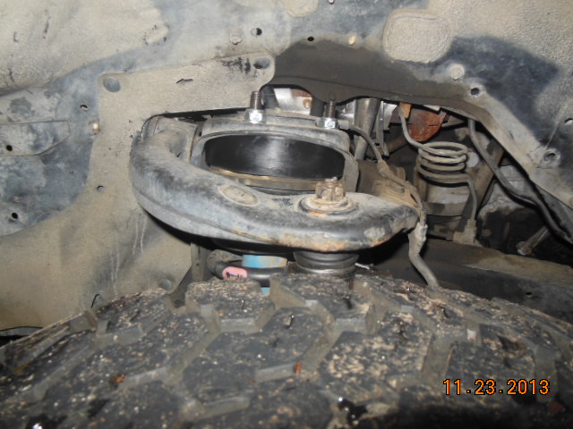

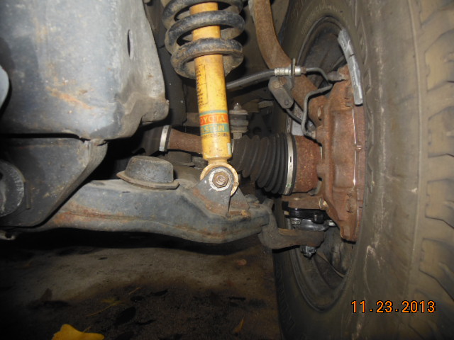

I installed a 2 inch lift (just like what you are planning to buy) and to get it in place, I had to remove the upper ball joint from the knuckle. This is due to the extra 2 inches on the strut and limited space between the frame and the lower control arm.
Ride stays the same as you are not compressing the spring with this spacer. I have 99 long springs in the rear without any spacers and the truck is leveled out.
With the this 2 inch lift, there is not really a significant strain on the front CV's or rubber boots. So I think 2 inches is the best.
With any suspension lift, make sure you gently lose all the nuts/bolts holding the bushings and bump your truck few times (while all the wheels are on the ground, no jack stands!) so the bushings now take new positions and tight the bolts back. Yes, you need an alignment.
See the pictures (also notice new OEM LBJ's)
First 3 pictures are driver side, before, spacer and after
pics 4 and 5 are passenger side before and after
