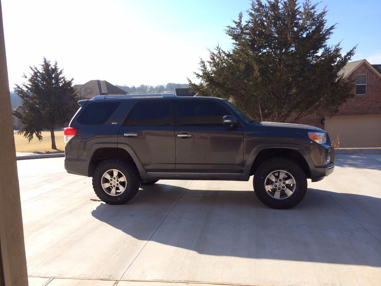

A picture is worth a thousand words maybe? Came across the pic below on the first page of the lifted pic sticky. Would prefer this look but with different tires. Perhaps I'll pm the user that belongs to this photo. Have no idea what was done for this one. Perhaps as simple as a level and close to stock sized BFG's on it?
You mean like this?
LOL! That was one of the first pictures I saw on the forum and it got me hooked on the 5th gen. I would say that's probably a 3" lift in the front and 2" lift in the rear with 285 BFG's. Just a guess.

I'd say you need to figure out what YOU want. I posted above how to get to the picture you posted. My rig looks exactly like the picture you posted, feel free to look through my build thread.
