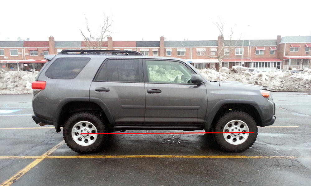

Option 2 reporting for duty sir :usa2:
Don't mind the red line, I was trying to eyeball something and can't find the unmolested picture, lol.
OME 883 on the front and SAW 1.5" coil in the back, 5100s all around with the front on the 0" perch. I didn't take extremely precise measurements but all in all ~2" lift at each corner after settling.
BTW This looks really good and is the exact look I'm going for. :thumb:
Thanks! Were you able to get your 4Runner aligned properly? Also, in the front you are using OME 883. Is there a reason why you went with OME 883 over OME 884? So the Front Bilstein's are set to "No Lift" 0" because the OME 883 is providing the lift correct?
