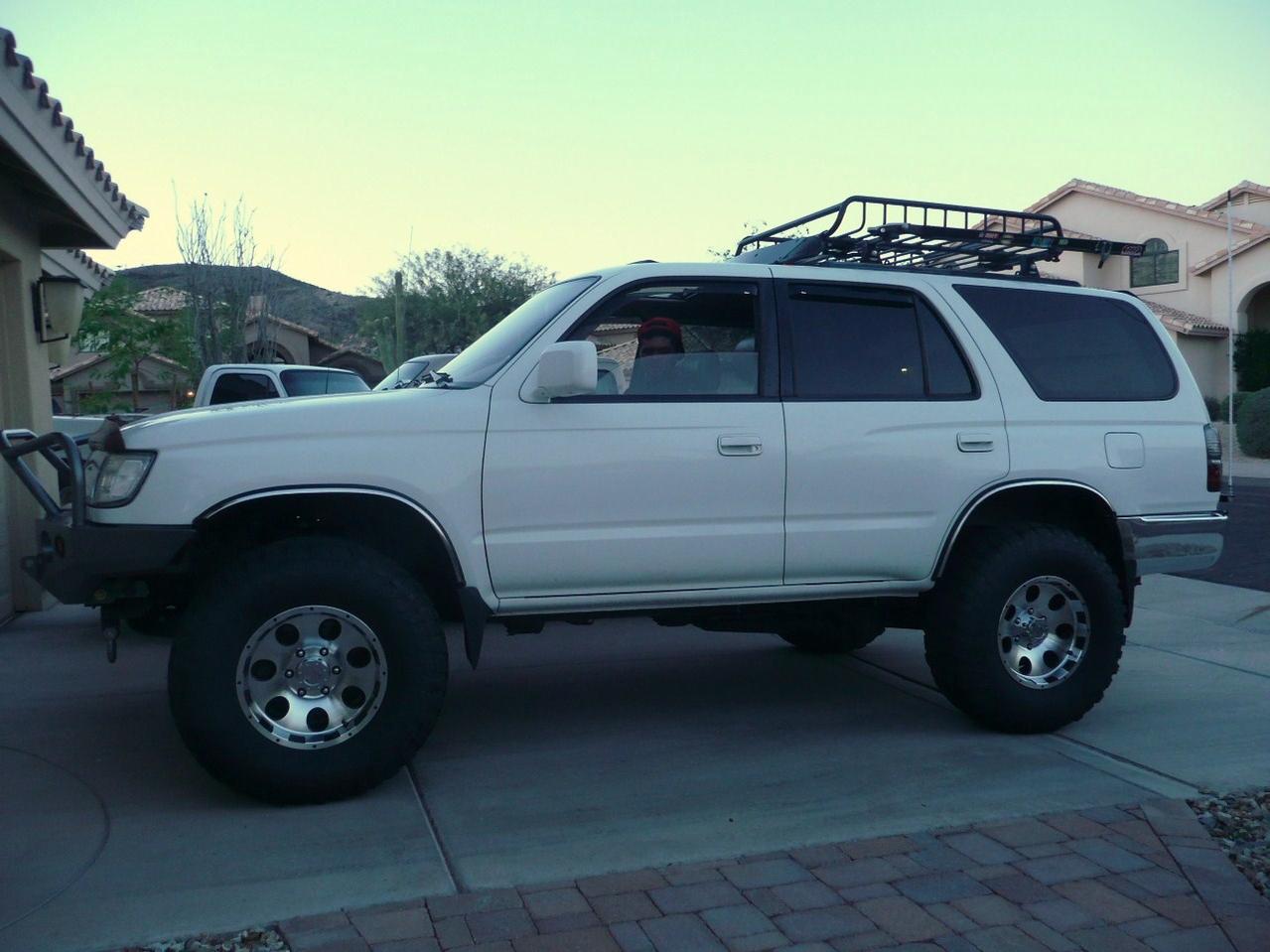

Bilstein adjustables up front with 99 tall coils
Bilstein shocks in back with OME 890 coils
38 1/4" up front
39" in back
265/75/16 tires
Like?
Congrats looks sweet! Are you using coil spacers also? Seems taller than I thought that setup would be :shrug:
no coil spacers.
i had the front coils installed by a shop and they might have adjusted the shocks up too but im not sure. i like it alot.
I dont think 285s would fit... and i would have to regear. i might need new rear shocks because these are stock length bilsteins... what are my options?

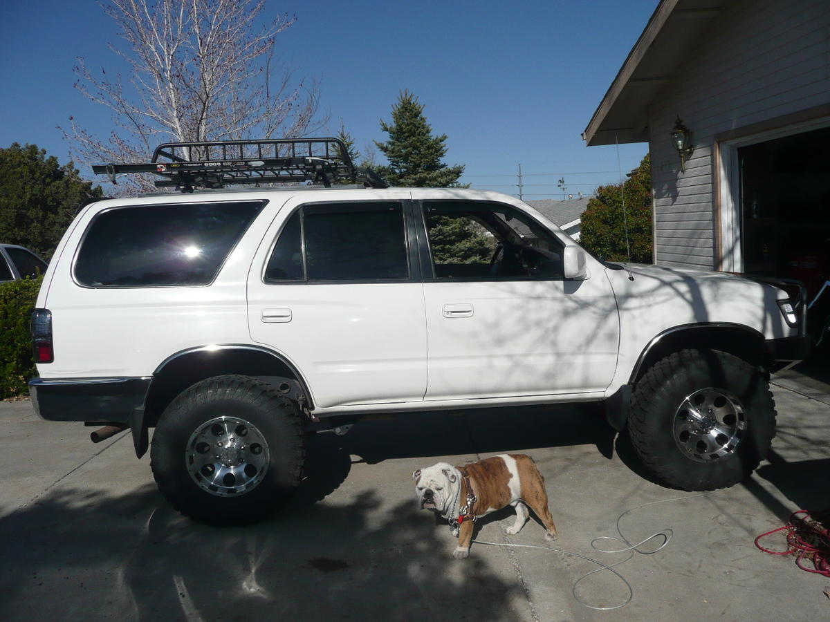

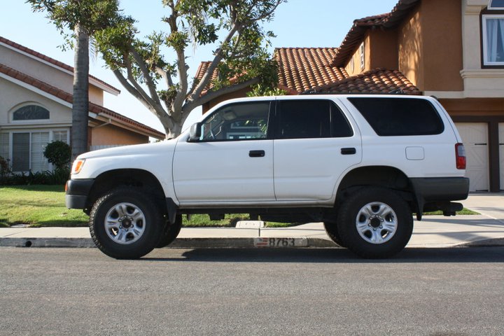

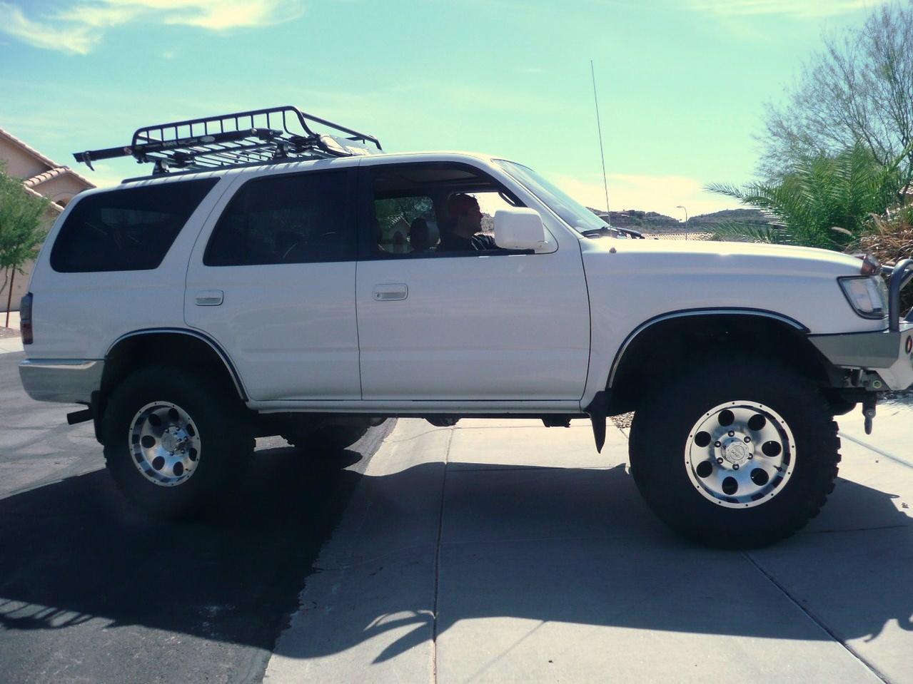

Looks like we have similiar set up, I have front ICON coilover, rear OEM 890 w/ adj bilsteins & diff drop with zero clearance/rub issue with the 285's. It's set at 2.5" lift with room to go higher if needed. Your rig should have no rubbing problems with 285 rubber, on the other hand the 2.7L may stuggle at bit. Good luck with your build it looks great.
doh totally didnt see the 2.7 in op's sig my bad lol , cuz i have v6 with 4.30 so switching to 33 didnt change a thing

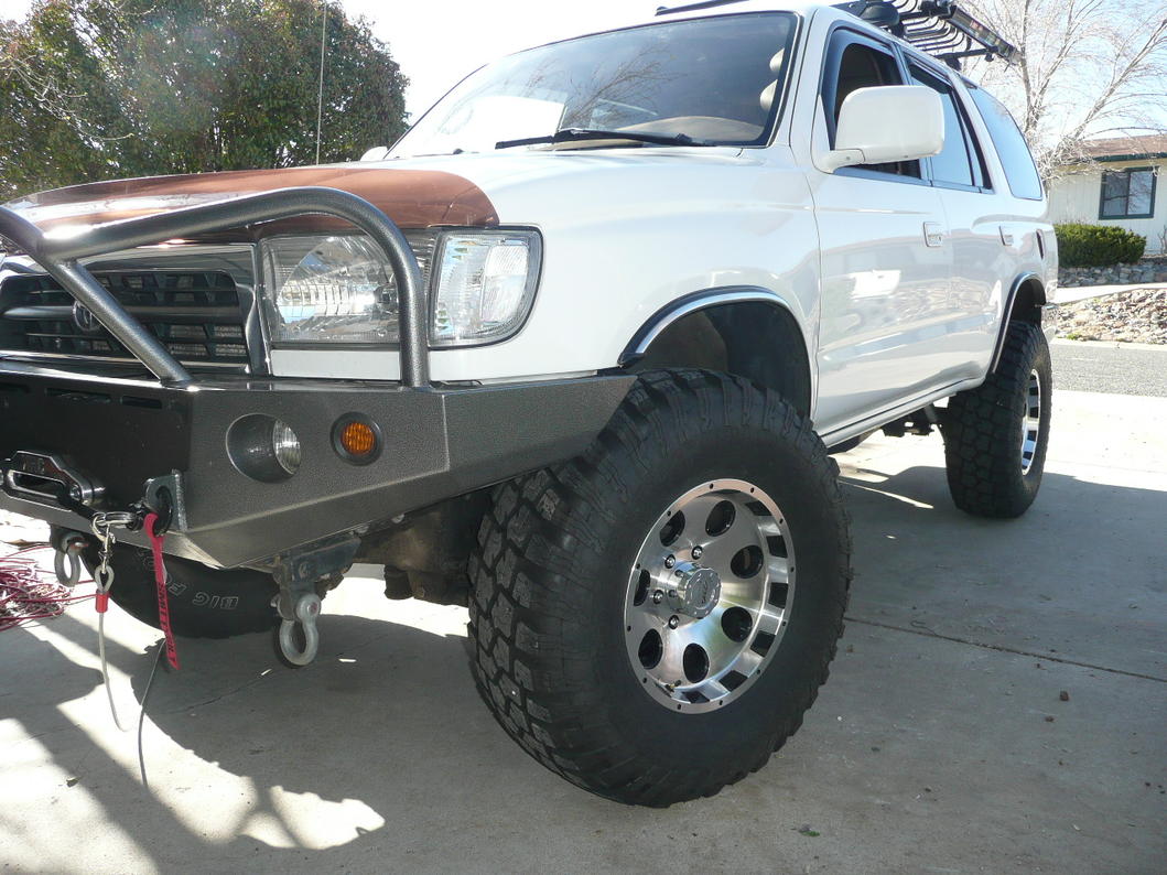

Yeah .......... I held off as long as I could, lol. It's a real clean install, plenty of room. We got together yesterday to install winch, URD short throw and brakes. Took him about 1.5 hours for all. He made it all look easy, I'm sure i was more in the way than helpful. But I managed to hand him a tool and open the box. lol. Scott will have the Bushwacker Flares and sport hood ready for install soon. Looking at sliders, I'm hoping Jim design comes out soon, we also like Stubbs.
