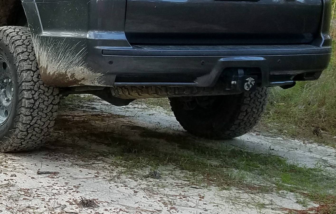

Were you able to fit a 285/70/17 tire underneath for the spare?

A 285/70/17 will fit underneath.
