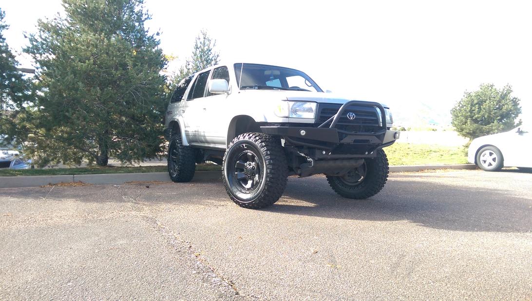

5100/Eibach up front,Rough Country 3inch lift rear for now, 1.5Inch bodylift from [MENTION=14772]shootmymime[/MENTION] (5100s up front by the end of the week)
255/80/17 Cooper st maxx on tundra split 5s
It was a cheap lift that got the job done, but now I have some money to spend so I'm doing it correctly (but slowly)

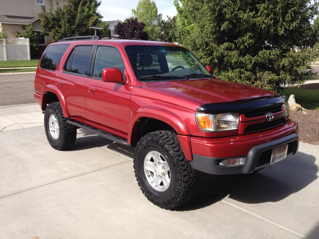

1: Toytec Boss Lift 550 Coilovers, Light Racing UCA'S, Toytec Superflex Rear Coils, extended Bilstein Rear Shocks, Sonoran Steel Adjustable Panhard Bar, Sonoran Steel Custom Rear Bump Stops. All set to 3in front and about 4in rear.
2: Goodyear Duratracks, 285/75/16
3: love the Ride and look
Before
After

1: Toytec Boss Lift 550 Coilovers, Toytec Superflex Rear Coils, extended Bilstein Rear Shocks, Snoran Steel Adjustable Panhard Bar, Snoran Steel Custom Rear Bump Stops. All set to 3in front and about 4in rear.
After

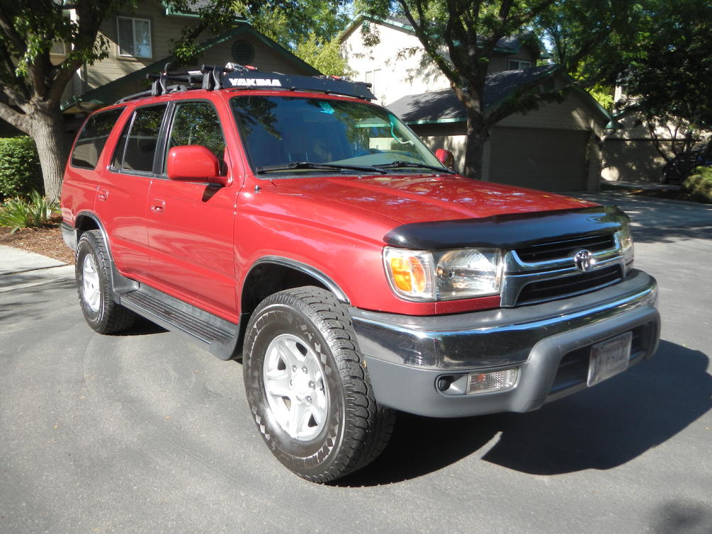

1. Bilstein 5100 w/ TRD Tundra coils (2nd setting) up front
LC 7.5 wraps with Monroe Comfort Shocks for LC in rear
2. 16x8.5 Level 8 Strike 6s wrapped in 285/75/16 Falken Rocky Mountains
3. Love the ride. I pieced everything together, totaled just at $500. Soaks up all the bumps on our crappy roads here in Indiana. The tires have been awesome, not a single complaint on or off road. If you are willing to take a bit of time and look for some deals, you can have a great lifted ride for under $500.
Before
After

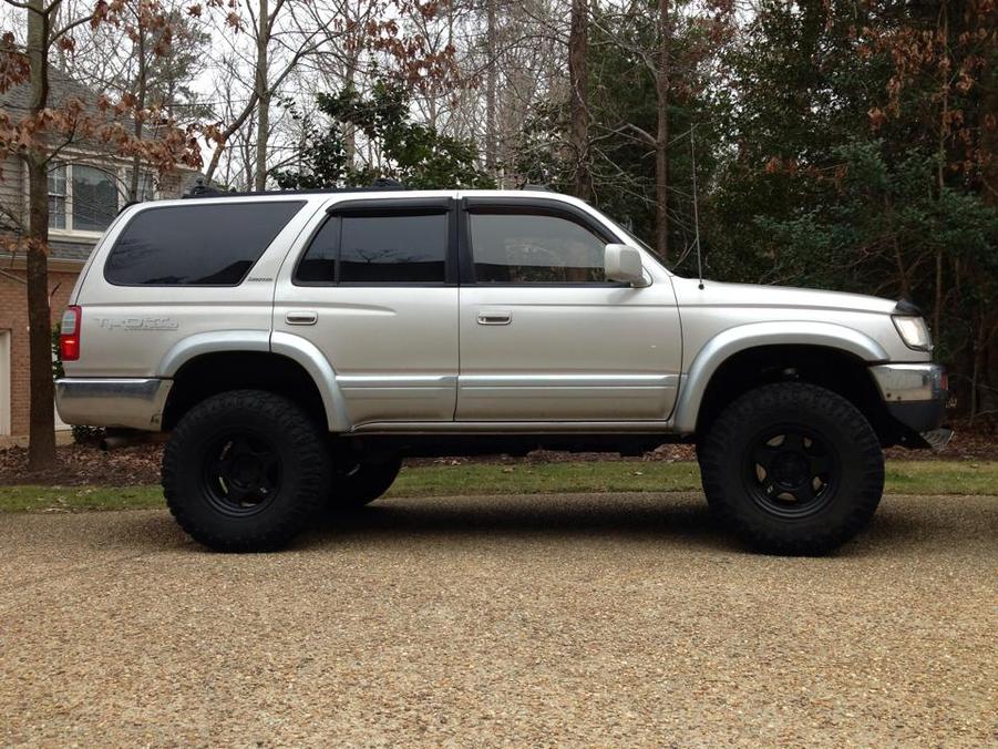

Lift
Front: Bilstein 5100's @ lowest clip, Toytec/Eibach Springs
Rear: Bilstein 5100's & LC 8.? Wraps
1" Toytec Bodylift
Wheels/Tires
GY Duratrac 285/75/16 LR-E on Level 8 Trackers, 16x8.5, 3.75" BS
Impressions
I like it a lot. Rides great on and off road, minor rubbing that sounds like plastic, have yet to address as it only happens when I'm posing like a poon on boulders, don't really hear anything on trails.

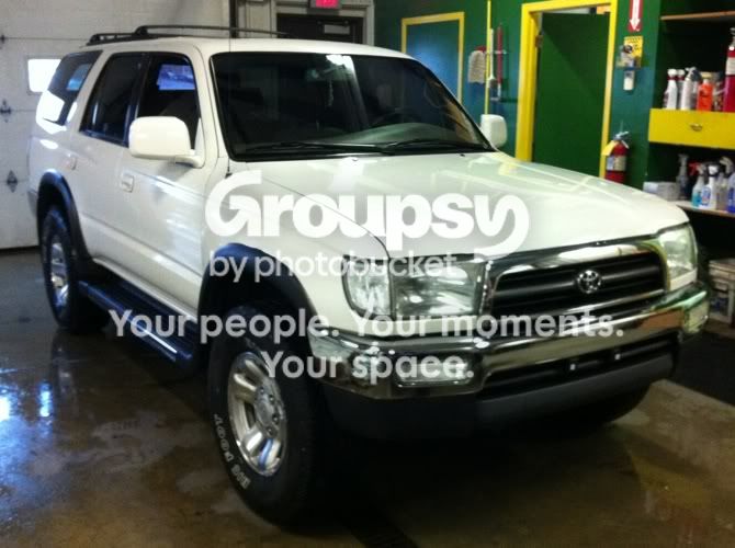

Stock:
runrear_zpsc1fbf605.jpg~original
Done:

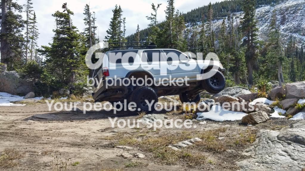

clake4rstuffedds_zps1c016328.jpg~original
clake4rstuffedpside_zpscf89fa5b.jpg~original
and level ground
bumper_dia2re_zps491dc901.jpg~original
