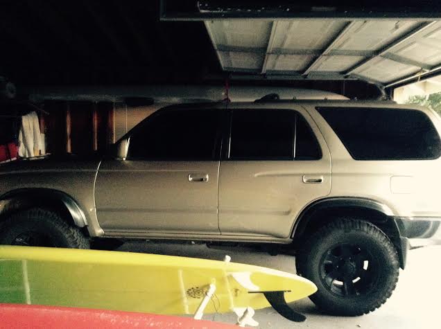

Hey Everyone! Need some advice. I have a 2001 4Runner w/ 285 70 17 tires and a 3 in lift- per the advice of my local off-roading shop. Car looks great but wheels are much too large for tire well. When I go off-roading tires rub on wheel well, especially in the back. Off-roading shop people are incompetent & un-professional; they won't take responsibility for job badly done. Not sure what to do- please advise how to fix this issue w/o decreasing tire size. Would any of the following work?
1. Body lift
2. Spacers
3. Air shocks
Not experienced with lifts & trusted local company. Now I want a second opinion. I appreciate your time :

The only right way to fix this in my opinion is to extend the bump stops. No matter how tall the spring the axle will still rise to the bumps stop at full compression, that is what they are there for. I would start there and see if it still rubs the bumper. Mine did as you can see in this picture: http://www.toyota-4runner.org/3rd-gen-t4rs/169635-arcs-98-build-thread-2.html
I just took the bumper wings off after this until I got my aftermarket bumper on. My rig is built 100% for go not show and I am here to tell you a 3 inch lift will perform great if you get it set up right to clear tires. I am sure you have some rubbing in the front too, but it is harder to make the front bottom out compared to the rear.

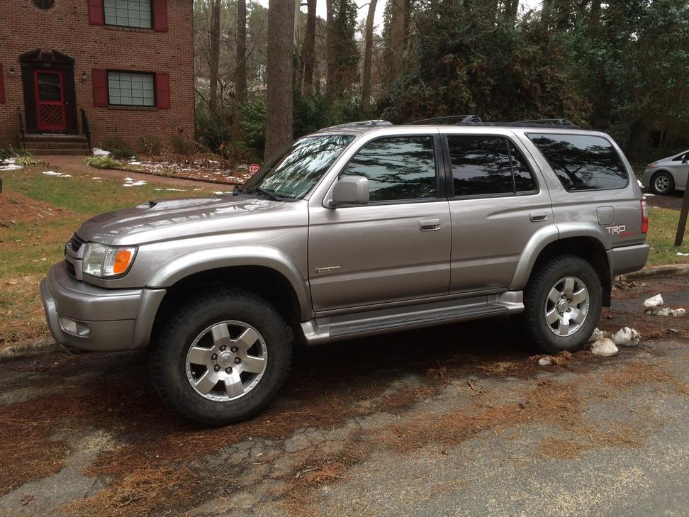

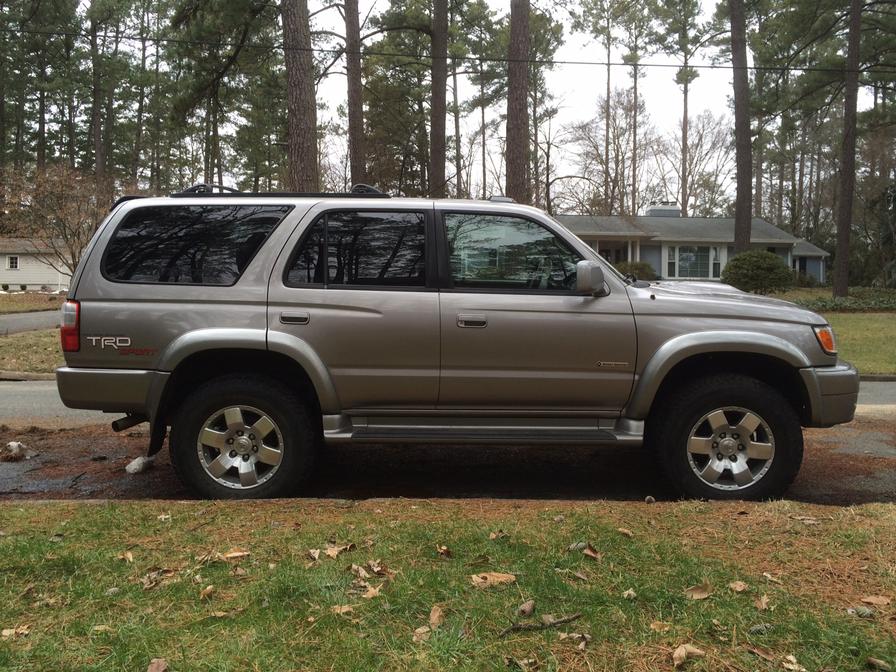

Lift: TRD/OME 906 lift with Bilstein 5100 all the way around. Fronts on the bottom perch. Really liking this set up.
Wheels: 17x7.5 FJs picked up on CL.
Tires: GY Wrangler AT/S 265/70/17s. They have been fine for my purposes -- just eroded and muddy logging roads to get to our MTB spots.
Yes I know the running boards need to come off...
Question: I haven't been able to see what the max tire size is for this setup. I'm assuming 255/75/17s (thinking Duratracs next) would fit fine since they are barely larger than what I have but could I fit 285s in there (without spacers/UCAs/etc) with this smallish lift? Guessing not.

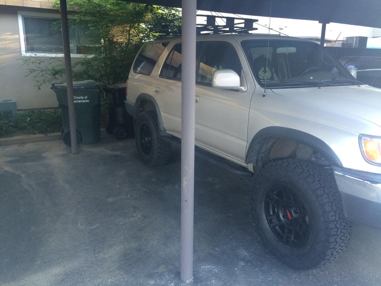

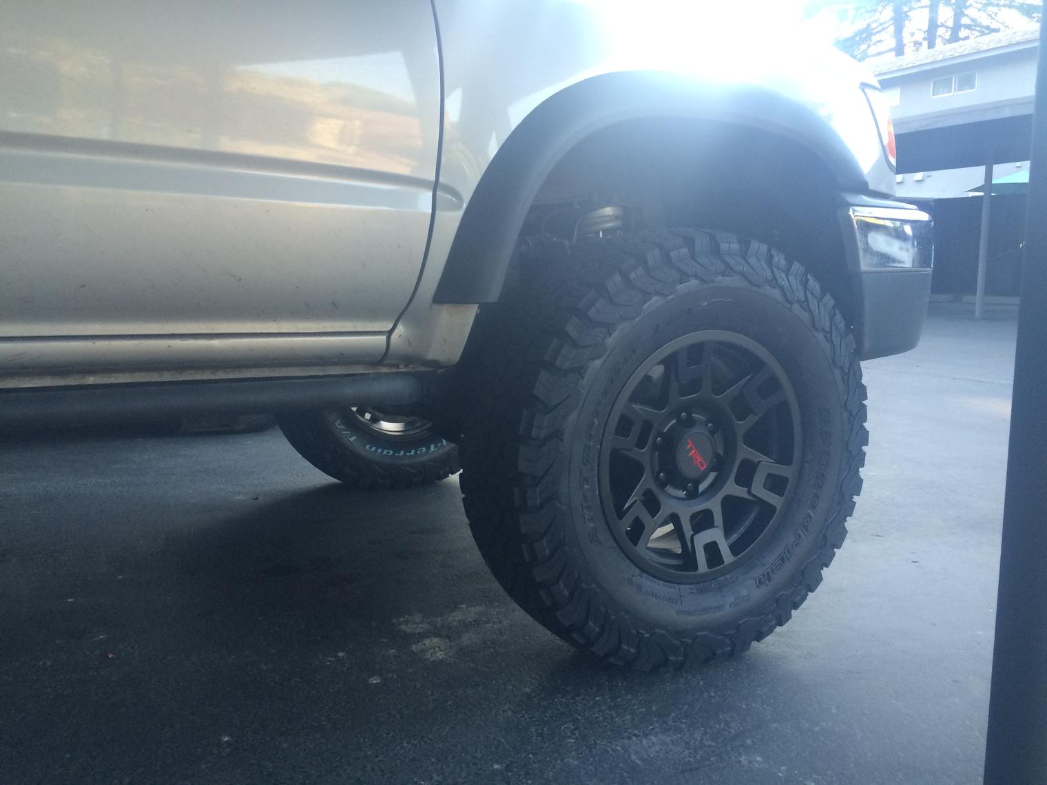

Tundra trd bilstein 5100. 3rd notch in front. 5100 in rear with lc 8 wraps. Goodyear duratracs 285/75r16. No spacers. LR uca.
Lift: Toytech HD 3"
Tires: BFG KO2 285/70R17s
Wheels: Toyota TRD SEMA Trail Teams 17x7s
Love the look but I'm gonna get some Spidertrax 1.25" spacers soon for it to keep it from rubbing while off road!
