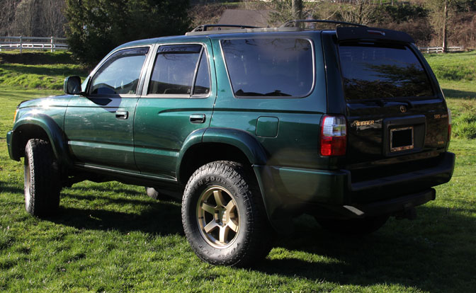

Yea I agree with you, I think the TRD's in Bronze would be a good fit. So far they're the best looking rim that will pull the gold lettering out. Need to see if the 16x7.5's will fit over the Tundra mod.

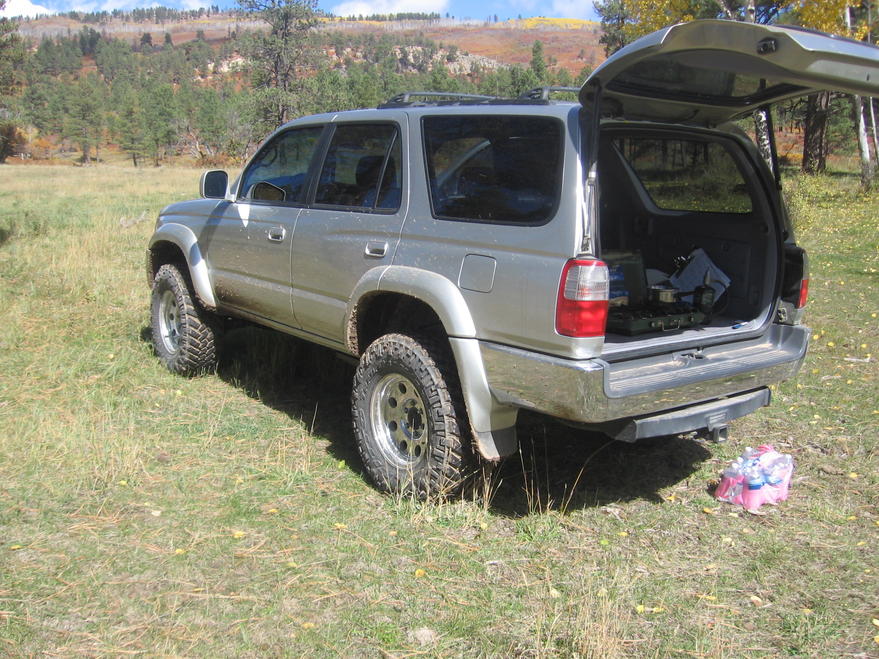

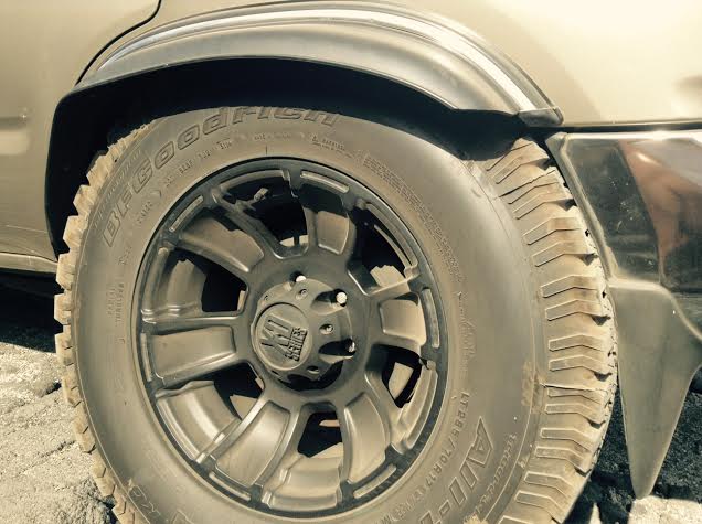

Hey y'all! I need new tires and I want to put 285/75/16 BFG KO2's on my 4runner. I don't have any lifts or wheel spacers and I need to know if I will rub too much or not? Also, my next purchase after the tires is going to suspension. How do you guys feel about OME 881 front with top spacers (3") and OME 891 rear (3") with just regular, non-adjustable Bilstein 5100's? I have done my research, I would just like to hear some opinions. Thanks!
They worked well enough for what I needed but I got rid of my rc rear lift and went with ome 861s and Tjm shocks
[MENTION=91423]Asaspades93[/MENTION]. I dig the 255/ split 5 combo you are running, those tires are my next set. On your lift, are you on the first notch with the ibach and then 861 in the rear, or second notch? Do you think it will settle a bit in the rear with plate/tire carrier on the back?

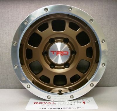

Here are the ones I'm seriously considering: I think the TRD's PTR18-35090-BR are pretty decent and somewhat in budget. Love the Volks but way too costly for my blood, a weekend warrior, and for a T4R with more than 300K on it. It's in immaculate condition but need to be careful on how and where I invest my money in this rig. (engine, tranny and suspension being the highest priorities).
Specs;
Bolt Pattern - 6 x 5.5
Hub Bore - 106.1
Width - 7.5 (I think I may need to go to 8)
Offset 10
My "coke bottles" fit on the 231mm mod without any problem but I want to convert them over to my winter set. Hate to drop a grand in wheels only to find out they don't fit. I did see the TRD wheel on the Speedy's Garage video and he did a 231mm mod.

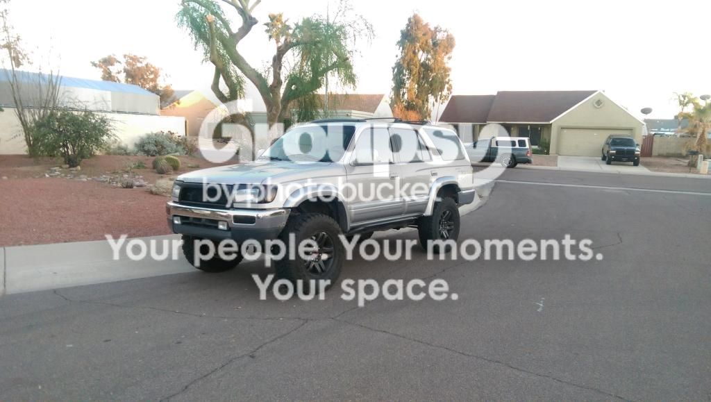

This is tundra coils, superflex rear. 285/70 trail grapplers. I wanted an in-between size to help eliminate rubbing, but still be a bigger tire. I sometimes wish I had gone 285/75, but overall I like the set-up. Wheels are American racing I believe, bought em used and thats what I was told.IMG_1021.jpg

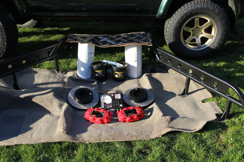

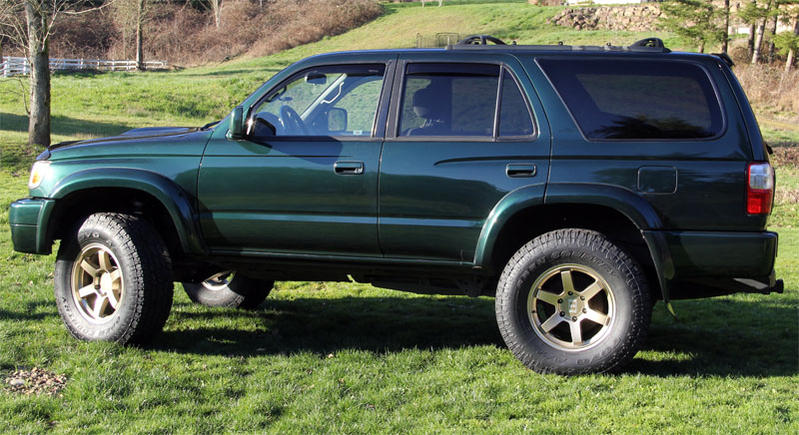

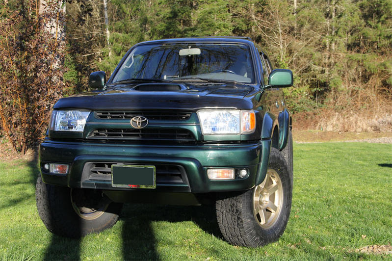

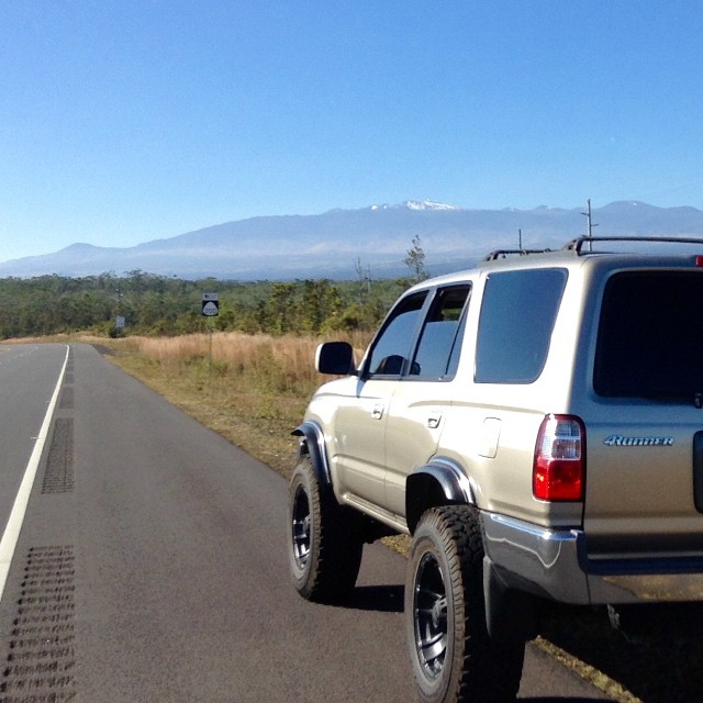

Decided to go with the Level 8 MK6 with a -10 offset. Went up to a 17" wheel for more stability and am running Toyo A/T's 285/70R/17's. Puts the height at 32.8" and fits under the fender flares perfectly. No adapter/spacer needed. The bronze pulls out the gold letter edition and compliments the Imerial Jade color.
Pretty excited about putting the deadener, carpet, sliders etc on this weekend. :biggrin1: :dance: :biggrin1: :dance:

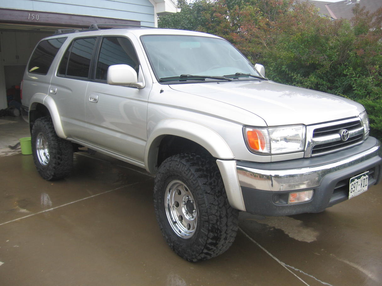

Here's a picture of mine with the same tire size. Notice how the tire is flush with the flare without using a spacer.
