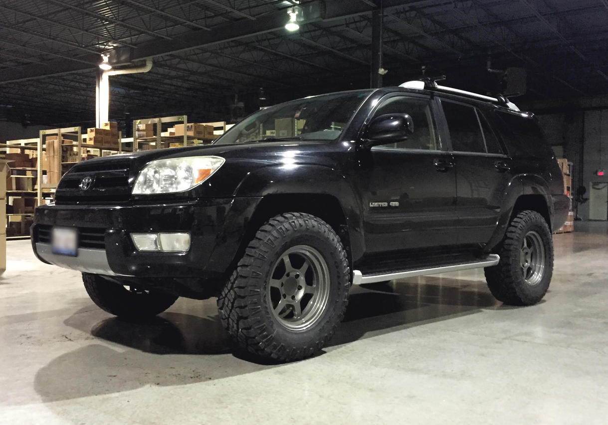

Hey for what it's worth, I put a Cornfed spacer lift on my 08 V6 runner 4x4. 2" up front, and 1" in rear. I have FJ coils in the back. 265/70/17 BFG KO2's on stock powdercoated wheels, and 1.25 wheel spacers.
Interesting, others on here I've seen with the same lift set up didn't appear to have that much rake. Is it more perspective in that picture since you're facing down a driveway?

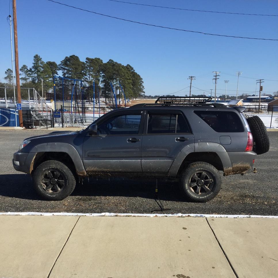

I have the same lift as DEF4Runner on my 04 V8 (literally just got it back from the shop) and my rear is 1" higher than the front. Was expecting level so hoping it settles a bit from the 2.5" it is now and eventually gets close to level.

265/70R17 Terra Grapplers, Daystar spacers (2.5/1.5), 1.25 Spidertrax spacers
Same lift with 255/80R17 ST Maxx
Same ST Maxx Tires with Icon Stage 2

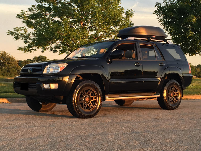

5100s set at 0. T1/T12 springs. 1/4 inch poly spacer on driver front to level it. 265/70/17 KO2s.

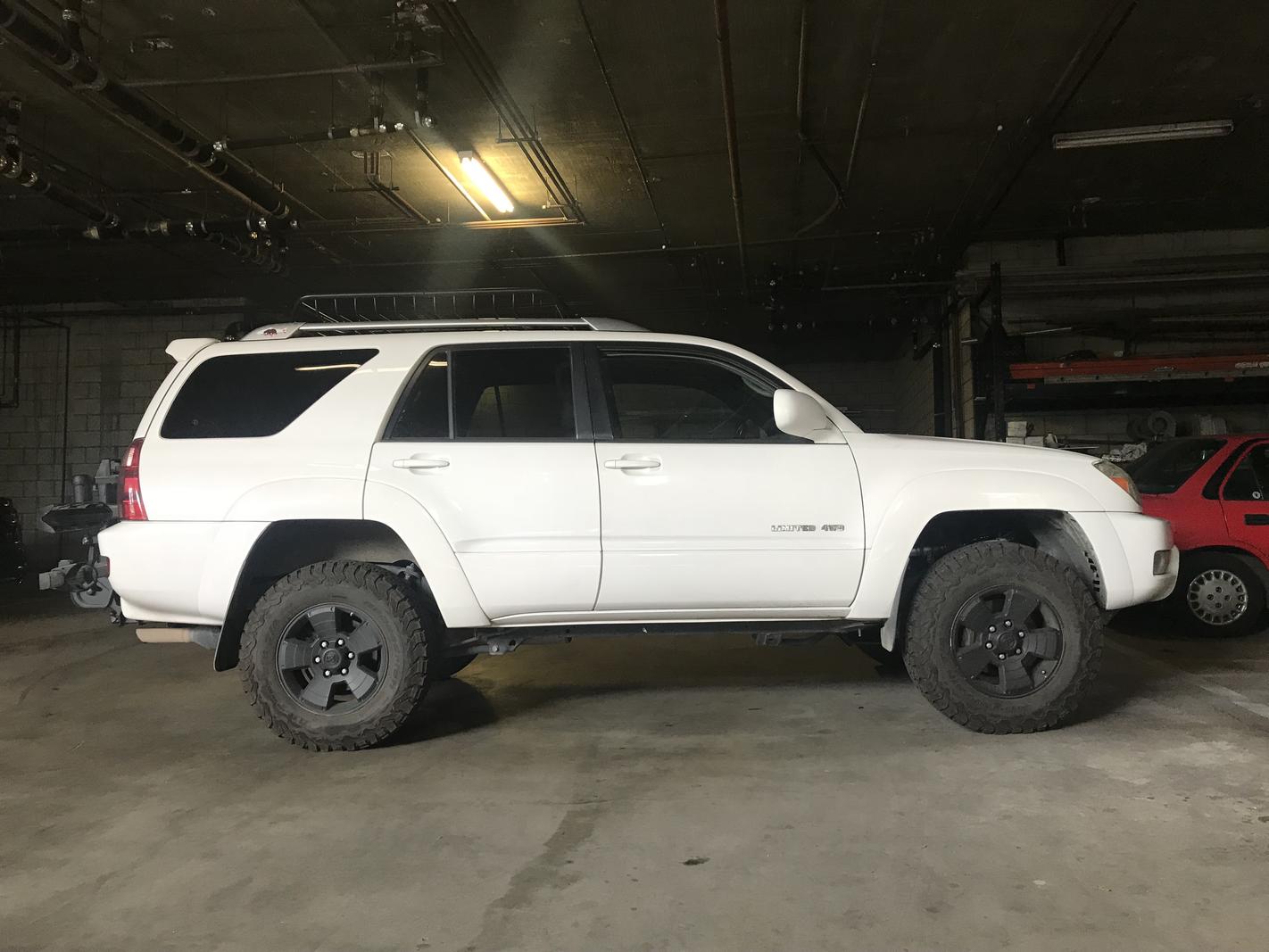

Really thinking about the T1/T12’s now. I jacked up one side just to see what it would look like and this is pretty close to the measurements I think. Would I be skipping leg day?

Also what do you think about this mock-up with these tires? They’re 265/70/17
