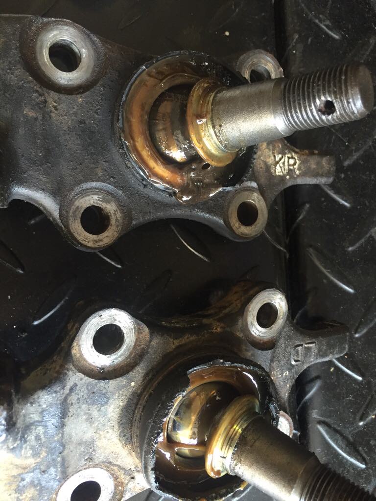

Well, had the time to change LBJ's out yesterday. I have 311,000 miles w no service records on my 4Runner. Old LBJ had torn boots but really no sign of wear. They were smooth no play. So anyway I have peace of mind for another 100K !!
Can anyone tell what brand these are ?? not Toyota....
Are you sure those aren't OEM Toyota joints? The polished ball and grease consistency looks like it came from an OEM joint. The Sankei 555 branded joints use a thicker grease (cheap lithium yellow) and don't have a polished ball.
Nobb, The letters stamped on LBJ's don't match the Toyota brand.???
