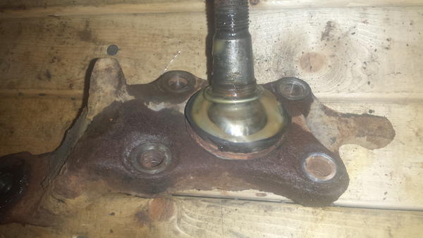

The internals of my lower ball joints were like new after 200K miles, no play and plenty of grease. The ball is still shiny, the shaft is not corroded and shows no sings of stress. They would probably have been good for long, but it's not worth the risk.
But, my truck is not lifted, and most lower ball joint failures we've seen are on lifted truck, so take that as a grain of salt if your truck is lifted, but still, changing them more often than 100K miles would seem overkill as they seem to last very well (toyota OEM)
Here is a picture of the above mentioned LBJ, original on my 1998 and used on quite ugly, rough, pot-holes afflicted salty roads of quebec.
