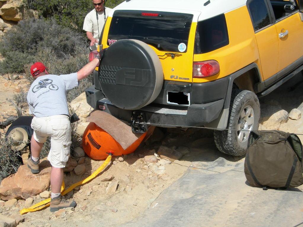

I've been involved with one recovery using an X-Jack. We placed the jack under the center of a FJC then used a winch to move the rear end sideways. Deflated and repeated a few times. Basically the rear drivers had dropped off a ledge and placed the FJC in a position where a flop was possible. Finally we stacked some rocks so it could drive out. A Hi-Lift could have been used too but the X-Jack is a safer option IMO for most lifting applications. If I had to own just one though, I'd take the Hi-Lift for versatility. But as others have said knowledge is key when using one.
On another note, this picture also shows why its good to have a snatch block with your recovery kit. In the bottom right of the photo you can see the winch rope as it is coming off the truck I'm standing in front of. We used a snatch block to redirect the winch pull. There was no way of moving a truck into position to do so. The trail was kind of a small knife ridge for lack of better description. We placed a tree saver strap around a large rock and shackled the snatch block there. At this moment we were not pulling on it but stacking rocks under the driver's rear tire.

I like how you guys improvised a cable dampener using the jack bag! Very Nice:thumb3:

Yes, the actual dampener was out of frame on the rope between the truck and snatch block. So we used the X-Jack bag as a 2nd.
