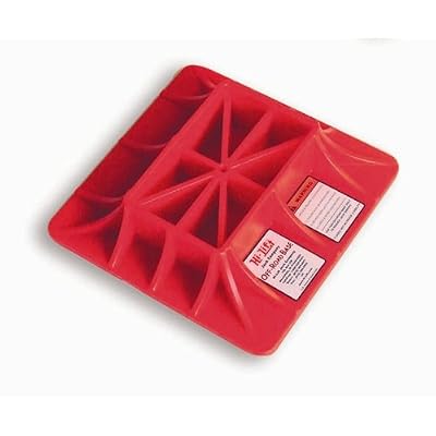

Using a block of wood under the oem bottle jack as suggested would work. Or you can also get a High lift jack base and use it under the bottle jack.
Amazon.com: Hi-Lift Jack ORB Off-Road Base: Automotive

i guess ill stick with the stock bottle jack and a spacer for now. i appreciate the help and thanx for teh link.
