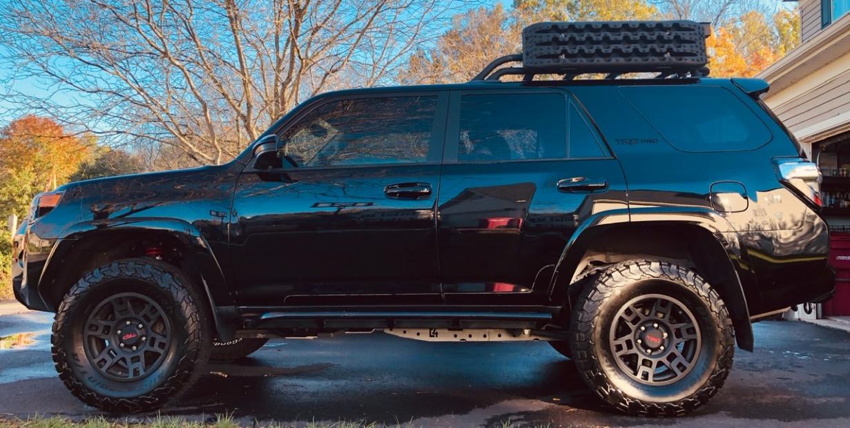

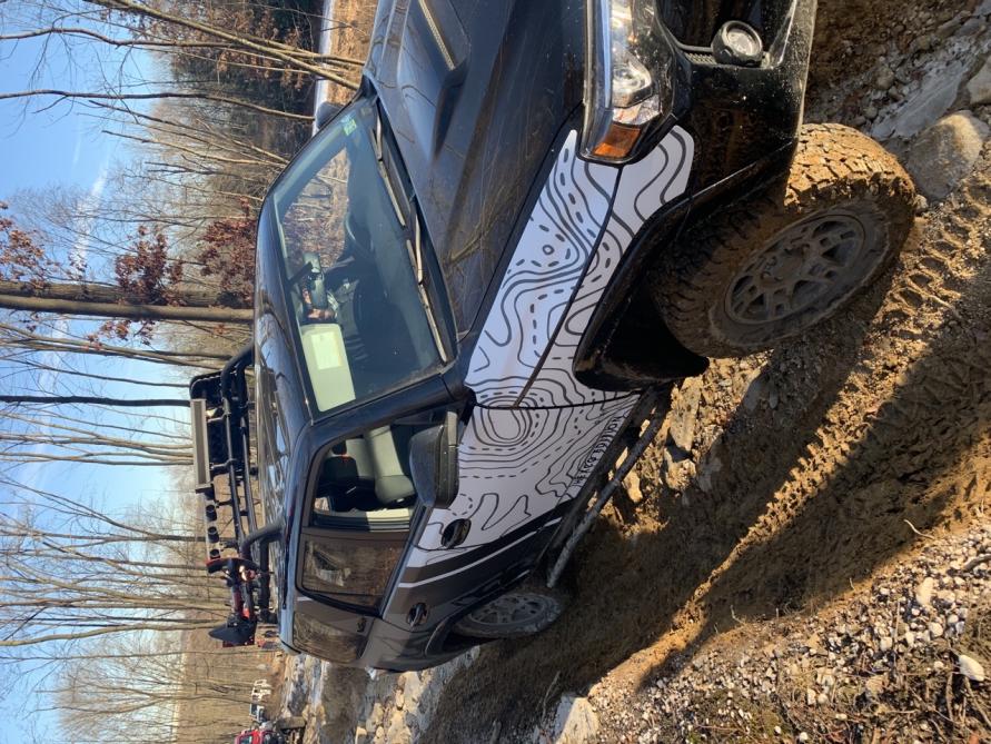

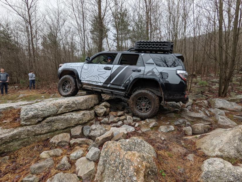

I installed the c59-505 on my 2019 pro. Gave about 2” of lift with no extra weight in rear. I put a 15mm shim on driver side to help with lean. I did 2” lift in the front also.
This first pic is about 500 miles after spring installed. Also truck has 285/70s on it.
Flexes nice too.
