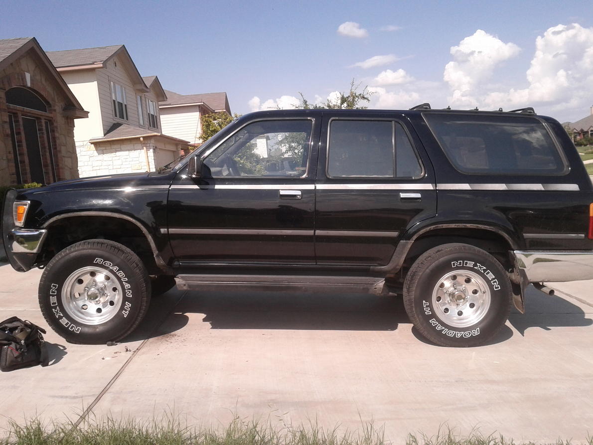

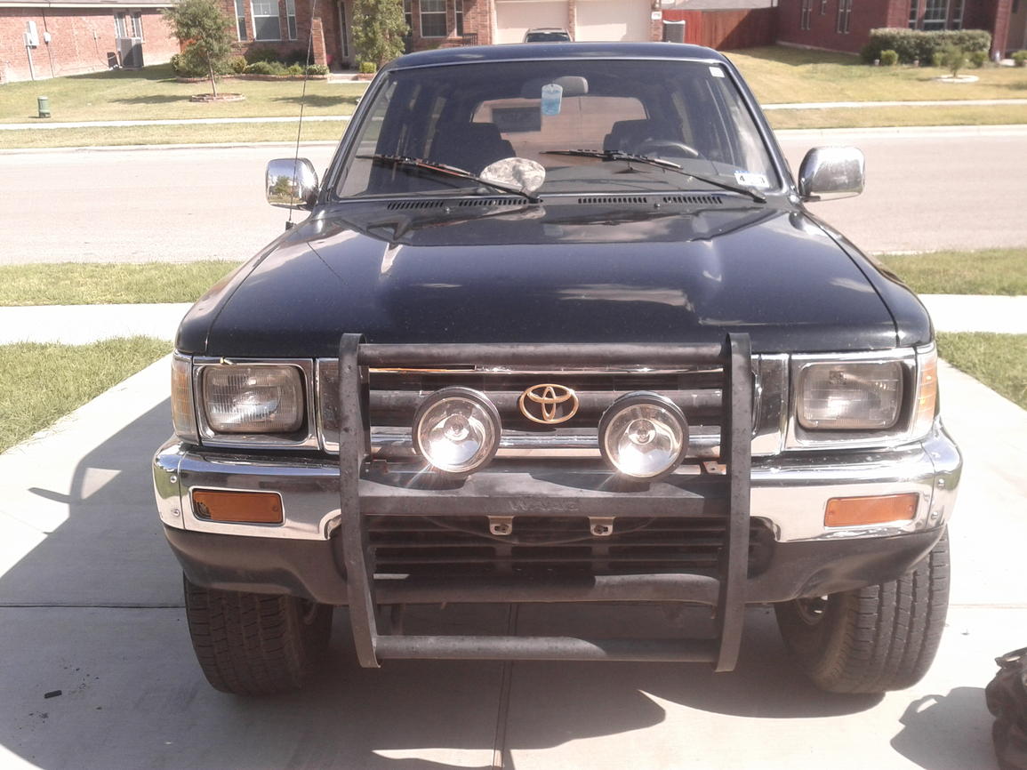

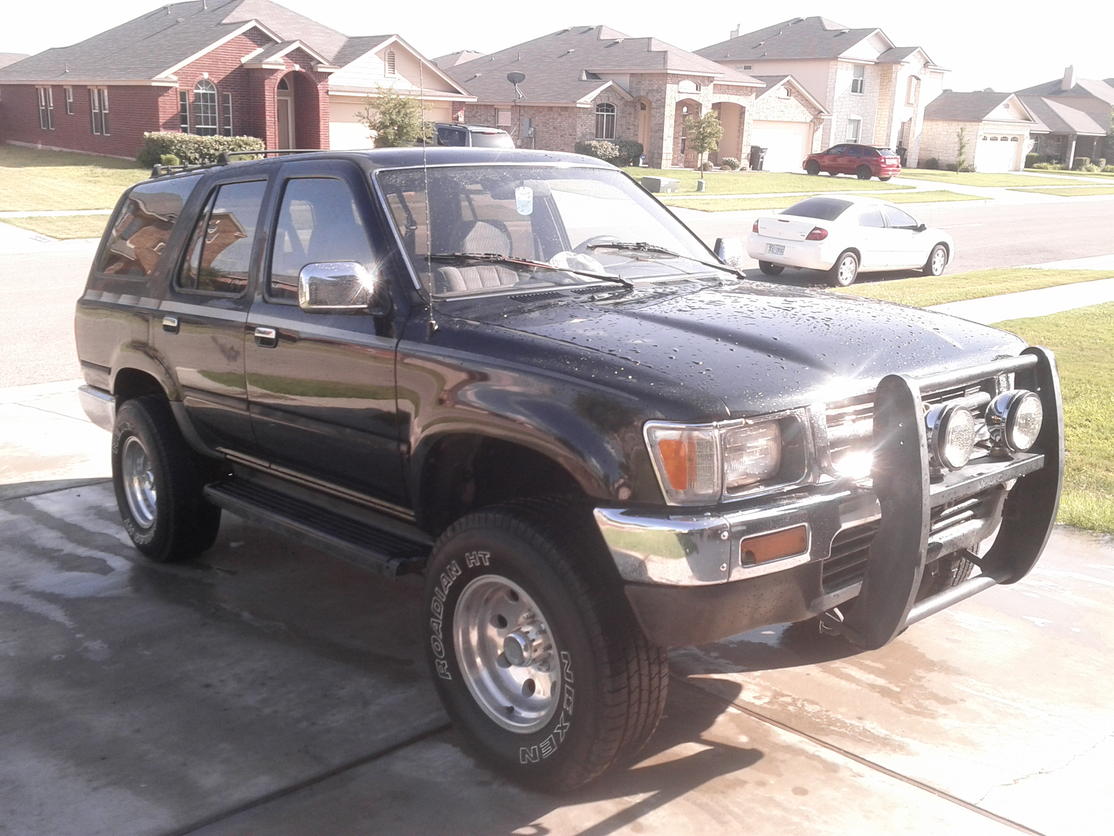

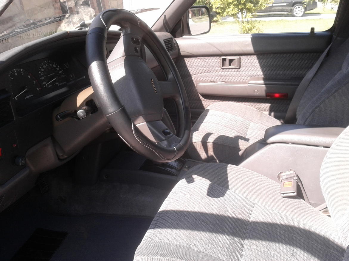

Shot a couple Pics
I shot a couple of pictures. I took the chrome off the wheel wells and the plastic along end caps from the factory running boards... on a sidebar does anyone know a good way to get the glue from the chrome off? I got all I could with a simple rag and dish soap but there is still alot on the drivers side
I ordered a set of 4x innovations rock sliders as they were WAY WAY cheaper than any frame slider I could've put on the jeep and it will allow me to get rid of those factory pieces. When I get my travel pay from the military it will restock my savings and the bigger modifications will start.
Interior was pretty good and wound up being better after I oxycleaned and purple powered the floors. I also picked up a couple random pieces at the junkyard like that little plasic piece in the corner of the door a cupholder that won't fall out and a dome light cover. These pieces seem hard to find in good condition. Anyways here it is... what do you guys think?
