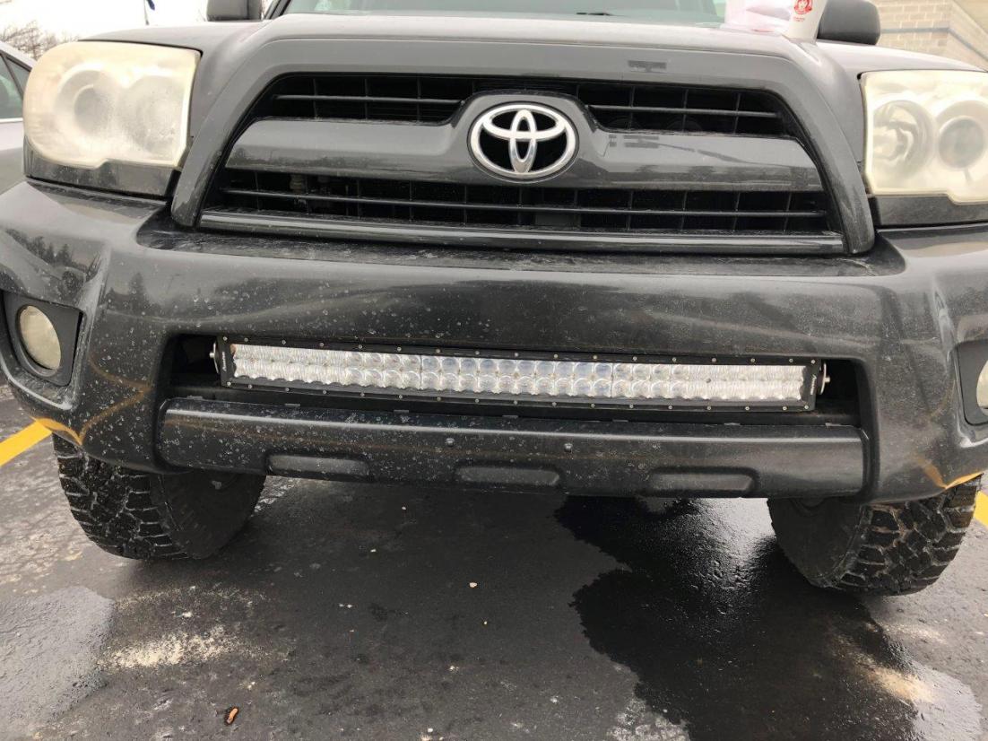

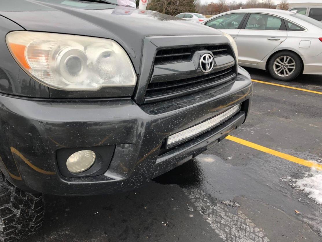

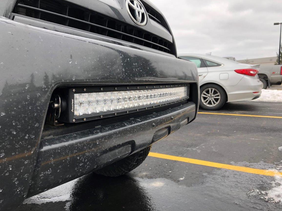

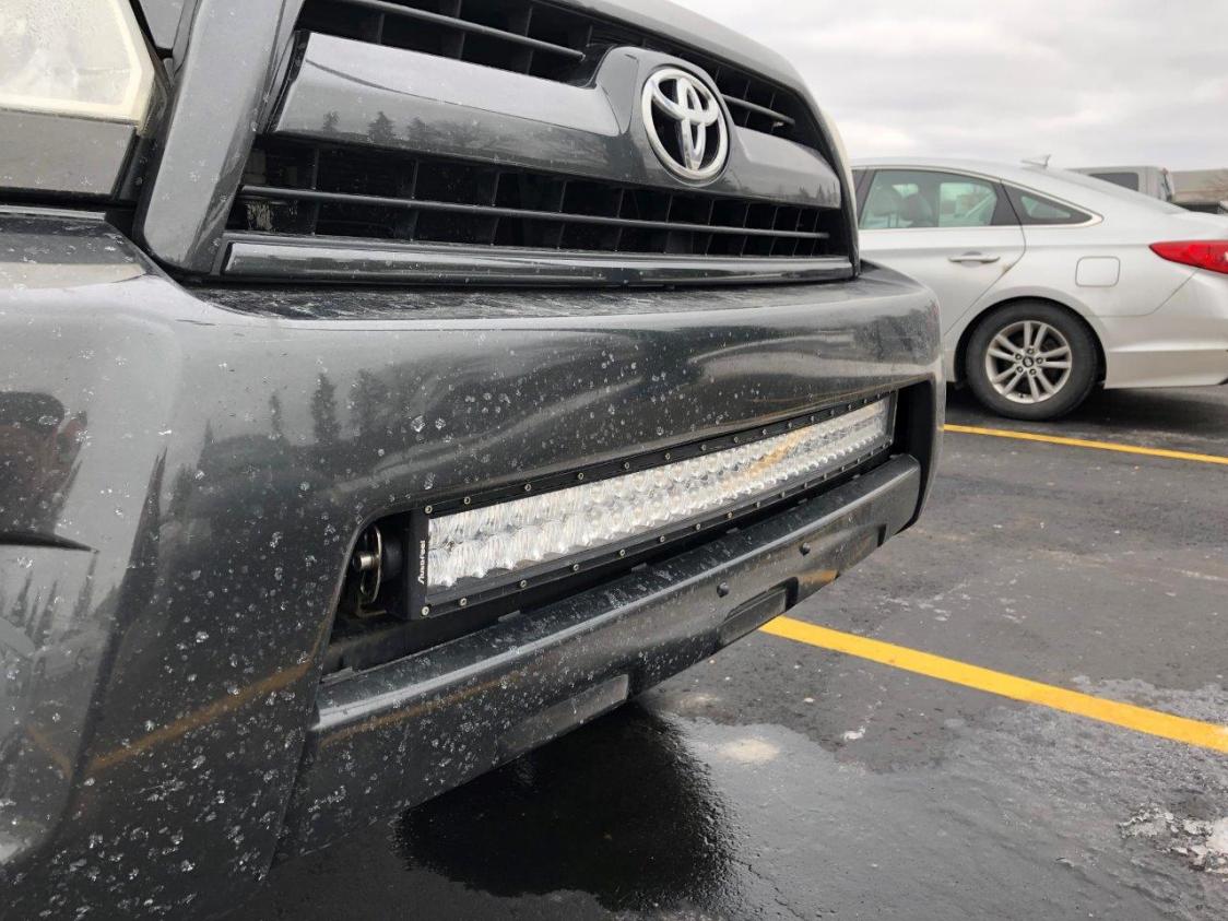

Here are some photos of mine installed.
-Rob

Agreed! Got any up-close pictures of what you did with the brackets?
