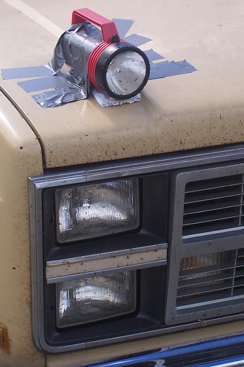

It shouldn't be too bad. You can go this route for the cost of a roll of duct tape:

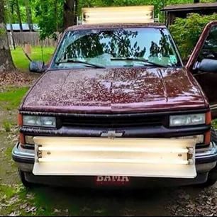

For a little more power, just plug the cable into the inverter in the back:

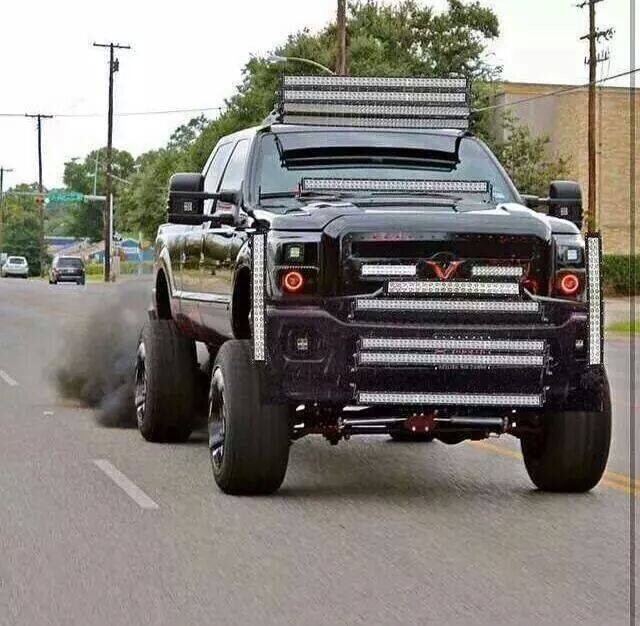

If you have a TRD Bro, this is a common setup. Since money wasn't an issue for the purchase of the truck, cost of installation is negligible:
Disclaimer - I have a light bar on my rig:dancin:

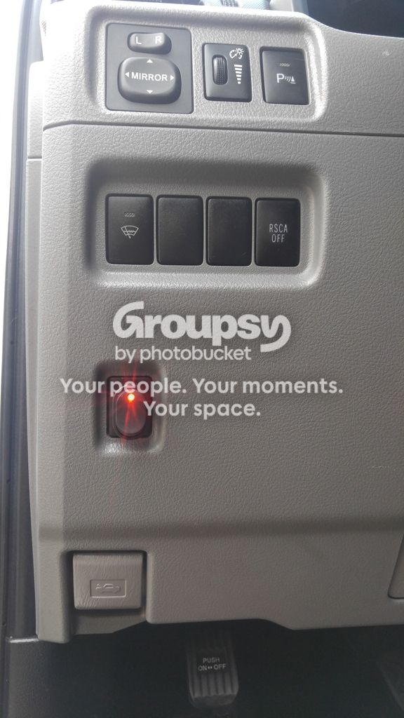

Is there a rocker switch that fits in one of the stock locations that people are using?
Behind the grill looks like a great mod. These light bars are pretty cool.
AOB fits really well in the stock locations.

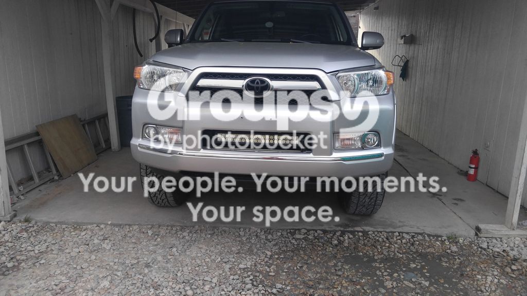

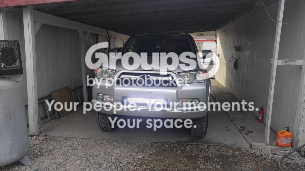

I posted the "if I can do it you can" install earlier in the thread. Here is how I did the switch install.
http://www.toyota-4runner.org/5th-gen-t4rs/222282-cymons-weekend-warrior-mfd-thread-3.html
All of the links to the switches are in the link as well as where I found the wiring info from [MENTION=103267]Saker[/MENTION], [MENTION=83083]rigtec[/MENTION] and [MENTION=81322]barryhiram[/MENTION].
I mounted my bar behind my grill and then paid a shop to do the electrical. Cost about $100 using my harness and switch. I read and re-read the very well written how to's on here but still lacked the confidence to do it myself!
