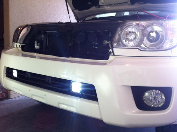

I posted mine in the Rigid grille thread, but will add here as well.
Rigid Duallys in lower grille. Cut slots with a jab saw, drilled small pilot holes in front cross member, and then secured mounting brackets with self-tapping screws. I did not remove the bumper, but used a drill driver attachment to get around it. Fit is good, and lights are secure.

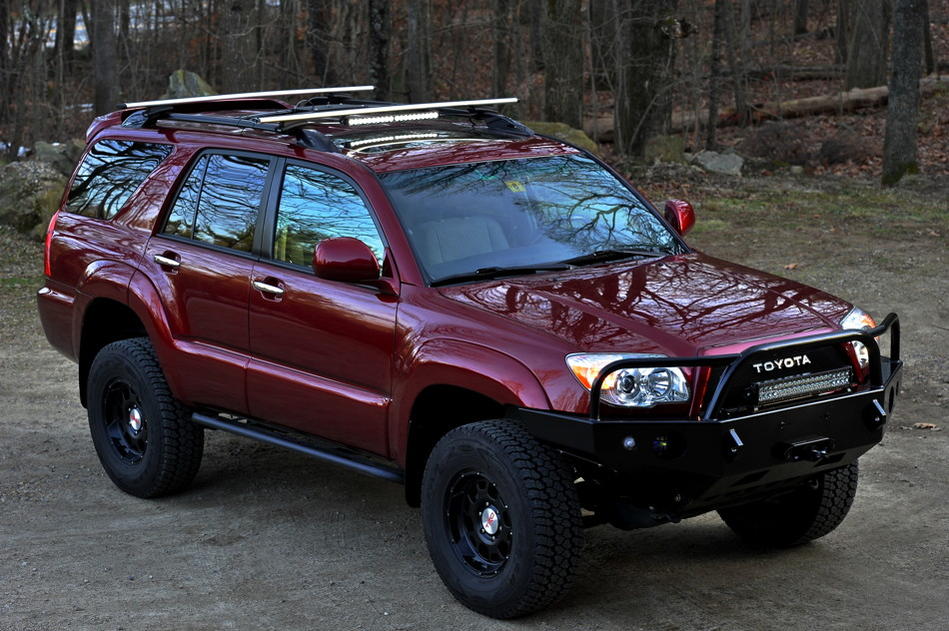

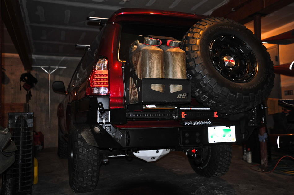

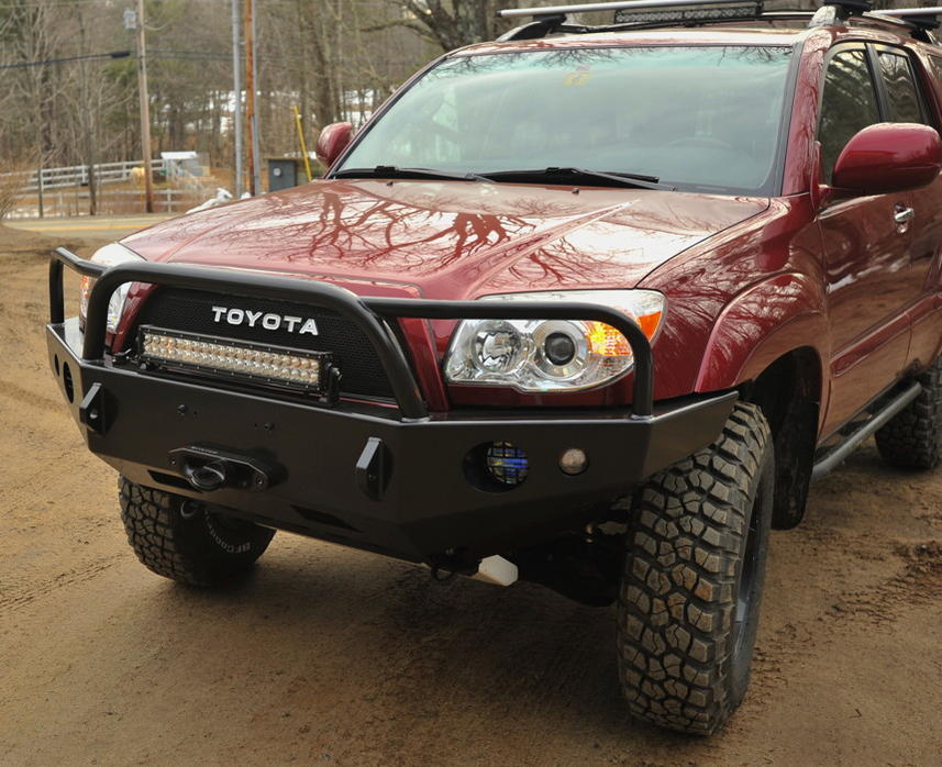

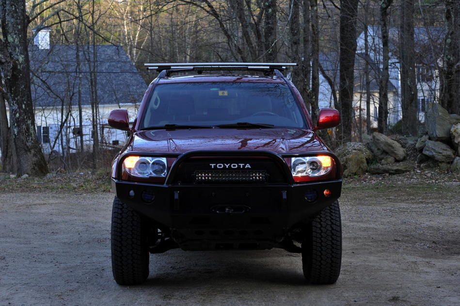

Bumper and up on the roof rack and then another looking backwards ...

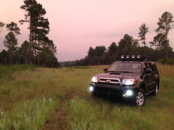

Hey guys,
Long time lurker, first post.

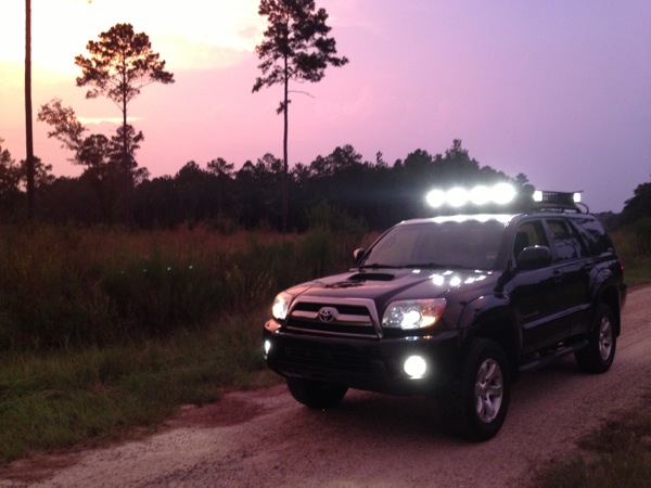

Not mounted on the bumper, but I have 4 KC Daylighters up upfront with 6 Walmart floods (A pair on the left, right, and rear) all mounted to the roof rack.

how is the projection from the one on the roof.. any glare or light cutoff.
No problem with glare at all; the light is far enough back from the windshield that I get no light pollution into the cabin at all. That said, if it is raining really, really hard or foggy or snowing, there can be a lot of reflected light. More-so than the expected reflection from any forward facing light in those conditions.
But overall, in normal conditions, I have found it to be a very useful light. It is also pretty much out of harm's way up there.

Epic first post. Your setup looks solid.

Never been a red guy chinese think its lucky , however this is a very tight & good looking 4r well done sir !

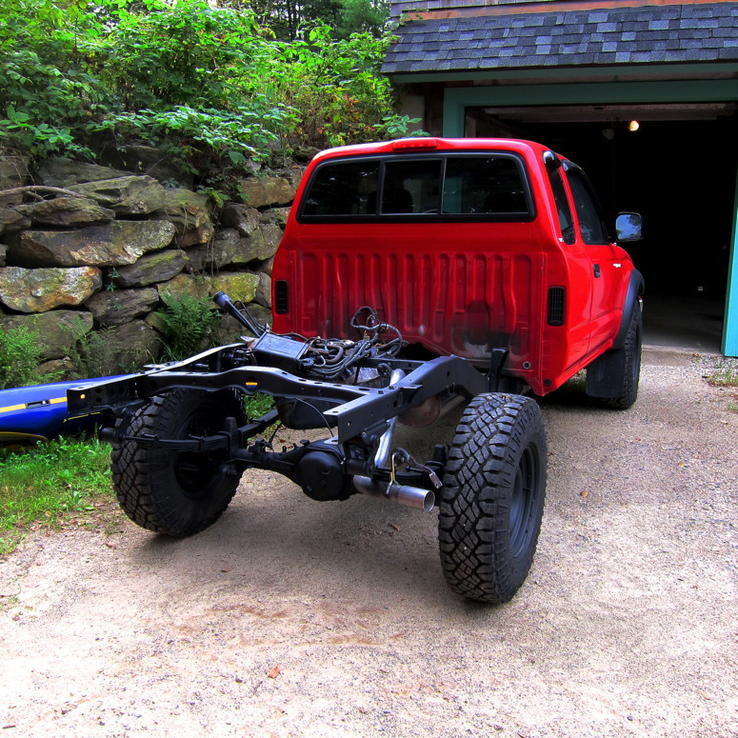

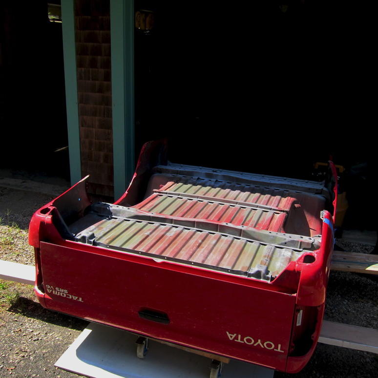

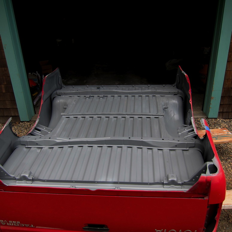

Thanks OlJedi. She's a stable build right now as I'm focusing my energy on rebuilding a low mileage 2002 Tacoma. When I redirect back to the 4Runner, I'll be adding lockers front and rear.
