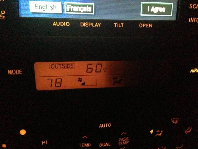

I noticed the other night that the light on half of the display that shows the air temp, clock, etc in my 05 ltd is out on the clock side.
I'm guessing something caused this when I had a local stereo place install a grom iPod cable/Bluetooth a couple days ago.
Do you guys think this is just a fuse? How do I go about fixing it?
First image is what it looks like at night.

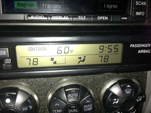

Second image shows the clock that I can't see when it's dark.
It's pretty annoying not being able to see the time at night.
Sounds like you just have a bulb out considering half of it works..

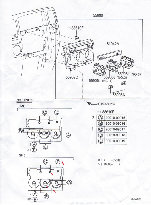

I know this is an old post, but obviously a recurring problem so here’s my question.
How many of each bulb is required? I need to replace the lights in the info/clock screen and also in the climate control buttons. I found the part numbers in the link someone else posted, but no info on the quantity needed
Here's a diagram of the back which has the bulb placement, also note that there's a slight difference between the SR5 display and the Limited which has the dual zone display.
