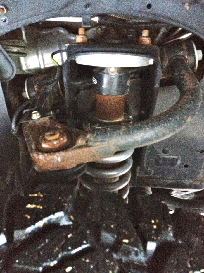

So, I've only had my lift installed for about 2 years and I just noticed yesterday that my Light Racing UCA's are rusting over pretty badly. It seems like it's progressing pretty fast for something that was painted from the factory. I just moved up to Michigan in October, but I have washed my car at least once a month since winter started to get the salt off.
Should I be worried about this?

Seems excessive for only being a couple years old. I would send SPC Performance a picture of the rust and request new UCA. I will be doing the same if mine look like that after 2 years. Good luck, keep us posted.:scared:
Yeah that does seem pretty bad for two years and only a few months of that time somewhere they use salt on the roads. I had my LR UCAs for two years and they didn't look anywhere near that bad despite the salt and other crap they use on the roads here.
I've had mine on for just over three years. Mine have rusted like that as well and more. I've also rebuilt them three times. Definitely upgrading.
Look up under that rubber ball joint grease holder and see if the ball joint and bolt is rusted.If it's rusted under there,replace them for safety. It can get ugly if a ball joint let's loose! That's where mine rusted despite looking sealed and why I took them off. My arms had no rust like yours but they don't use salt much here in Texas.

I just sent SPC an inquiry on their website. We'll see what they say about it. I hope I can get it replaced...

Hey Harper... what UCA did you replace yours with? Was SPC not willing to replace them?
They said a one year warranty and it was about a year and a half and would sell me a new ball joint.:flipoff: I still have them and going to send them to them for a complete overhaul and sell them cheap.
They were willing to replace the bad design bushings which was there first design and cracked out.
I originally bought a set of used TC's for $400 over on the FJ forum that were pretty well shot when I bought them and I since rebuilt then with the newer design stainless balls and new bushings. Been a year and a half and still perfect and quiet. TC's For The Win:guitar3:

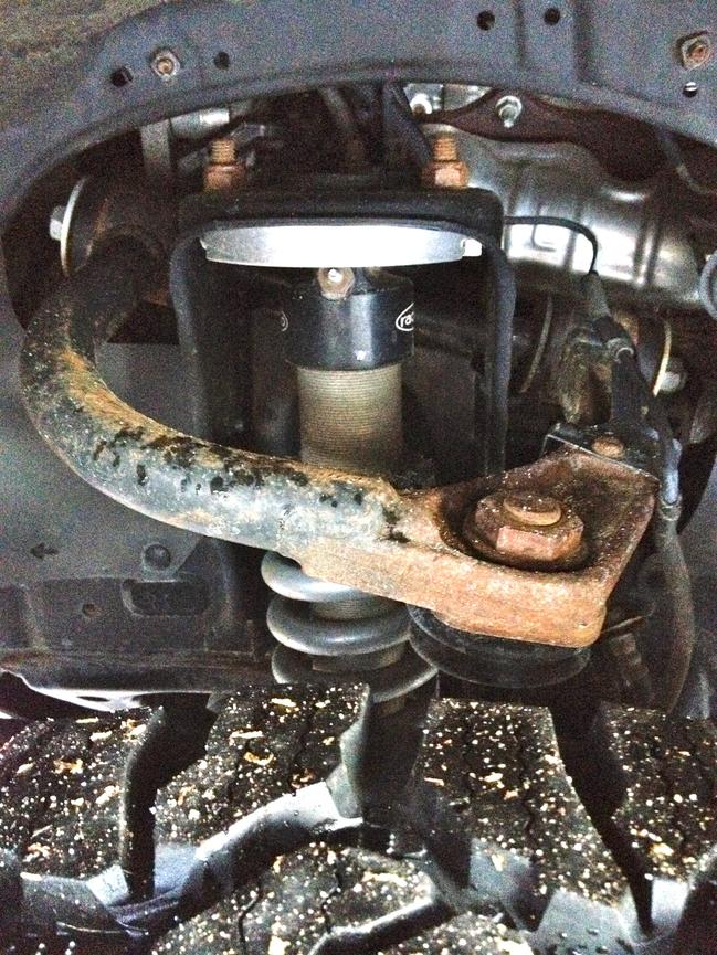

Here's what mine look like after a little over three years. My coil over threads are pretty bad as well.

You're going to see this come on faster depending on where you live in the country. Me being in the Northeast, it happens quickly. It's inevitable.

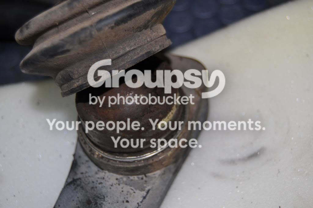

Yes, yes it can.
That's a broken CV there.
DSC_2110.jpg by BurningChr0me, on Flickr
What the ball joints looked like when they came out.
DSC_2116.jpg by BurningChr0me, on Flickr
The passenger side boot looked completely sealed and intact yet this is the dirt that came out of it. No grease left in it at all.

I'm not really sure... but I contacted SPC and they said that "finish" isn't covered under their warranty because it's considered normal wear. I'm not sure I believe it with the amount of rust that's on it, but based on the post by [MENTION=76550]cbielat[/MENTION] it may just be normal in salty areas.
