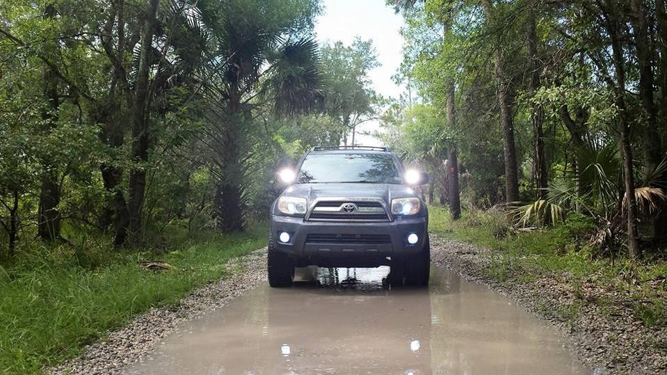

check out auxbeam 4d light bars. im running the 4d pods and they are a great spot beam
20160709_202020_zpsh4504c23.jpg~original
20160129_225734_zpsfgig8h25.jpg~original
20160129_231258_zps2aeyl6ed.jpg~original
Having both HID's and LED cubes I can offer some insight that might make your decision a bit easier. You are correct about the HID bulbs/ballasts going out all of the time. I have them in my low beams, high beams and fog lights and it seems like I am constantly replacing either a bulb or ballast every 6 months. The light output of the HID is decent, but no where near as bright as my LED's.
I think a great, cost effective upgrade for you is to purchase the CBI ditch light brackets and then mount the Rigid Industries Dually D2 in driving light pattern. I have these and switch them on anytime I need them. The duallys are incredibly bright and the driving pattern offers a beam that is both wide and far reaching. They are so bright that they completely drown out my HID's in brilliant white light. I promise you will not be dissapointed.
