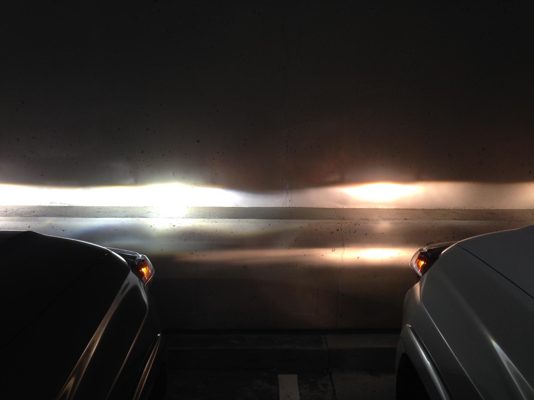

Nope.
Glare
DSC_0003.jpg~original
Glare

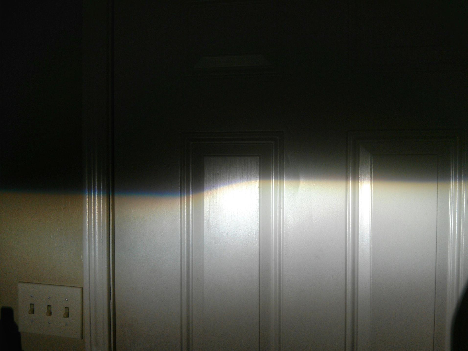

Proper cutoff

Riiight....lemme school ya on glare.
So because the 4runner happens to have less glare it somehow makes it acceptable? The projectors also have a big hotspot because the halogen projectors do a poor job of distributing the light. This is a big problem for SUVs because they often catch cars under the cutoff. Projectors designed for HIDs spread the light more evenly along the cutoff and to the sides where it is usefull and less blinding to other drivers.
The 4runner has significantly less glare, compared to other halogen projectors its actually an amazing cutoff. So yes, it does make it acceptable...could it be better, yes. Is its a road hazard...no.
They do still have a focal point because they are designed for halogens (the reflector bowl is different), however as the pics show the beam pattern is still very even and the focal point is not above the cutoff line.
