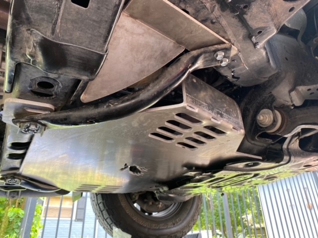

I've inspected under my 4runner, and I don't see why you can simply modify the skid plate for placement under those braces and then bolt on, with longer bolts, to the same attachment points on the frame. That would leave the braces intact and still allow the skid plate the same attachment points in the rear. Is this not possible?
https://i.imgur.com/c5Y3IiB.jpeg
I know I spent 2-3 hours under the 4 runner just looking, trying to figure out the easy way to do keep those cross members for this very reason. If it was easy I would have done it that way :P
I feel this image shows it best. If I was to remove that potion of the skid plate for the brace to clear, I feel it would leave the Cat behind the plate pretty open for people to get too. I do not think it would be enough for them to get it out, but enough to get a saw in there and cut it up, causing lots of damage.
Also, this photo makes it look like there is a bunch more room then there really is. It is very difficult to get to the cat with a saw with this plate installed.
I also really debate how much of this brace is for reinforcement VS how much of it acts as a protector for the exhaust components above it. The transfer case cross member is beefy, and I really doubt the brace is doing a lot for it, especially when you compare it to the 1/4" Aluminum skid plate.
I am not sure about the front drive shaft grease question. i do not personally own a 4 runner. These plates were made for a lady who wanted them on her SUV, and so far she has not had any issues with them. They have been on for about 2 months now.
I know Randy has taken his 4 runner wheeling and will report back.
That being said, if there is someone in Houston with a V8 4th gen 4 runner, I would be glad to bolt one up and revisit this topic. I believe the V6 4th gens have the transfer case cross member about 4" closer to the transmission crossmember, like the 5th gens.

Just to be clear, we are discussing removing the driver and passenger side brace circled in red?
I missed this, yes you are correct. Also, I am debating if it is the angle of the photo, or if your cross member is forward of the one on the 4 runner I designed this on.

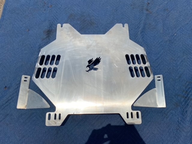

Well... I took your comments to heart, and worked on improving my design.
Let me know what you think.

The front end of the two smaller Cats are inaccessible to a cutting saw, and unbolting would be impossible without removing the headers. So those are irrelevant.
The larger Cat that connects to the Y-pipe is more of a concern and the most expensive to replace. It would take cutting the front pipe only and then unbolting two bolts on the rear, which in many ways is how they steal the Prius Cats.
Someone with steel fabrication abilities should consider a bolt plate that would simply deter thieves, or so slow them down significantly, where they may simply move on. I would be willing to pay top dollar for this solution if anyone is willing.
