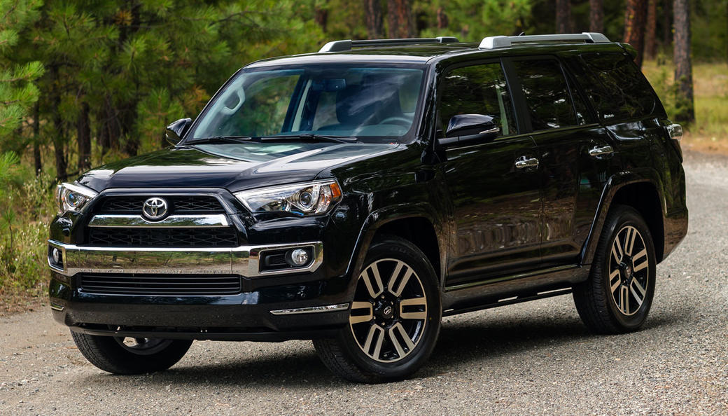

Hi everyone. I have searched and browsed and searched some more but I cannot seem to find an answer to this question.
Toyota's website lists the 2015 SR5, Trail and Limited as all having the same approach and departure angles. To my eye it looks like on the SR5 and Trail the front bumper is above centerline of the wheel while on the Limited it is below centerline of the wheel. Does anyone have actual measurements of either the approach angles of both or a measurement of how much farther the front bumper hangs down on the Limited?

Limited has less approach or departure angle due to the bumper covers. I don't have the measurements but it used to be that the SR5 and Limited had same and trail was the best. on 14/15 models, the Trail and SR5 (and TRD Pro) are the same. If you plan to put aftermarket bumpers on, It won't matter which you get. You have the same thing under all that plastic.
If approach and departure angles are important don't get the limited, I've parked next to both SR5 and trail 14/15 and their unmodified versus my lift isn't all that different. That stuff hangs low on the limited.
